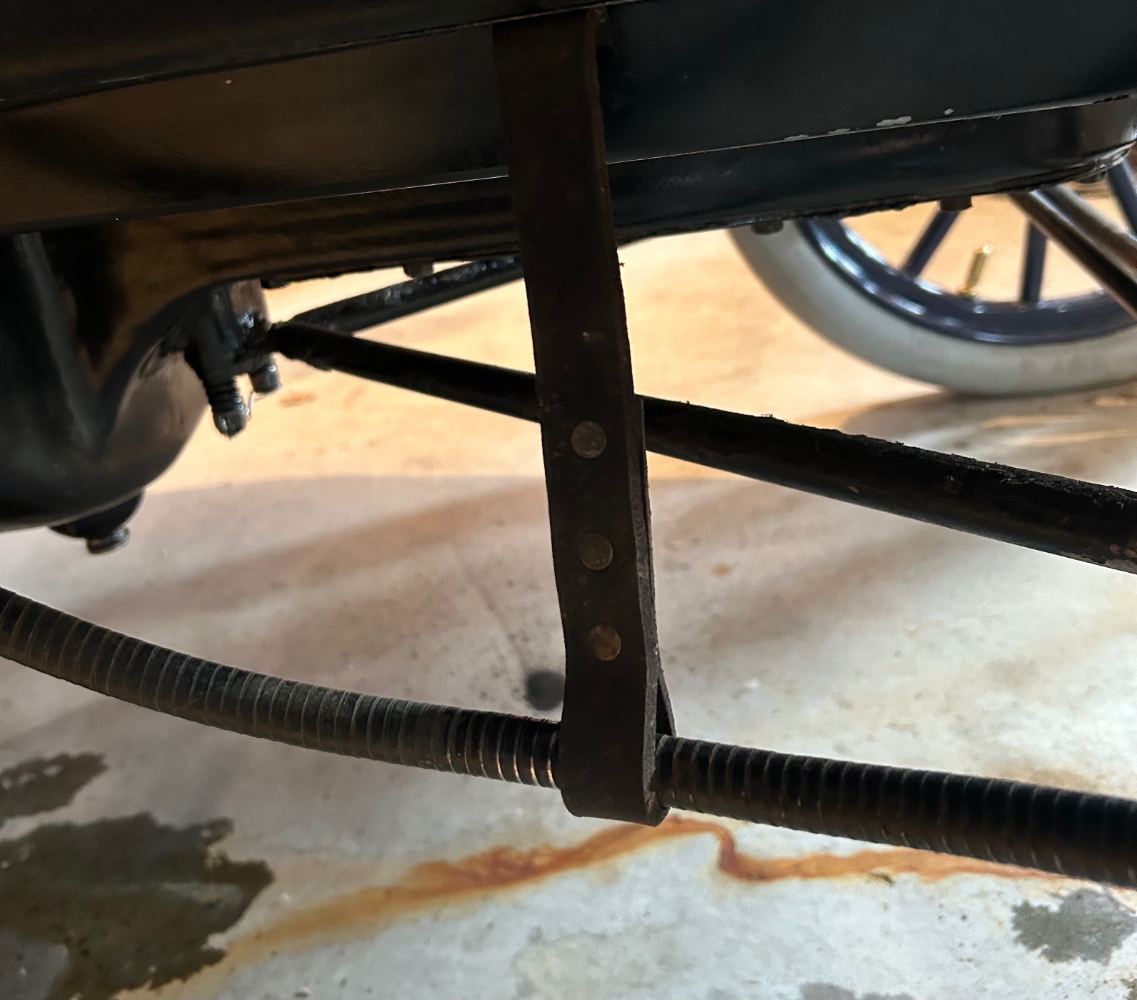

Maybe this is helpful ? My ‘13 came to me this way, cable loop has three flat rivets, working length 7-1/2”. It’s secured to the frame rail with a 5/16” round head machine screw just forward of the carburetor. I have no idea whether the hole in the frame rail was added, or was original.

Well that looks good and keeps the cable straight in the past 3 years I have broken 4 links it is the original cable and chain and the links are getting brittle, keeping it straight can't hurt.

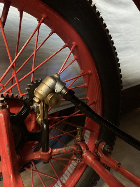

The Stewart Warner Company recommended that the cable have a graceful bend from the swivel to the speedometer head. A tight bend can cause failure. If the bend is too tight, the inner cable (chain link) WILL fail and break. The attached photo shows the correct way the swivel should be positioned, allowing the cable to go straight out from the swivel and creating a graceful arch. I hope this helps. Russ Furstnow
