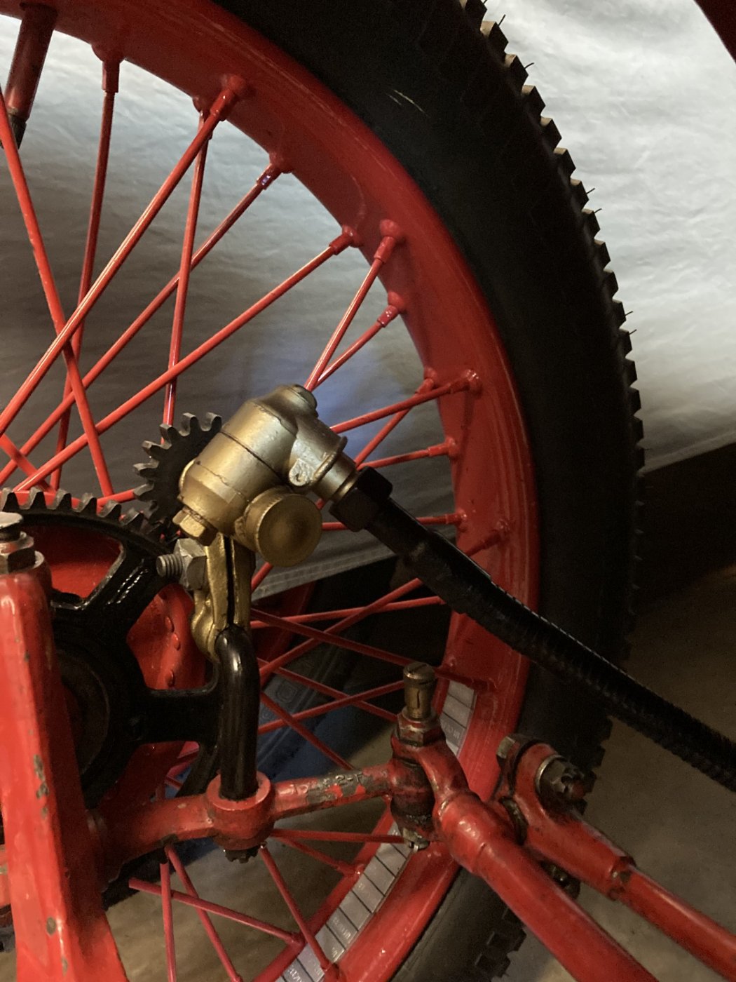

I've worked on speedometers and their drive components for a few years and DO NOT recommend using a support strap on a Model T. The Model T uses cables that range from 48" to 63" and this length is just too short to need a support strap. The cable should hang freely from the swivel to the head. When a longer cable is used than what is recommended, then a support strap may be needed. Here are the length of cables used on a Model T Ford:
1909-1914 - 48" cable
1915-1918 - 45" cable
1919-1922 - 54" cable
1923-1925 - 60" cable
1926-1927 - 63" cable
The Stewart Warner Company recommended that the cable have a graceful bend from the swivel to the speedometer head. A tight bend can cause failure. If the bend is too tight, the inner cable (chain link) WILL fail and break. The attached photo shows the correct way the swivel should be positioned, allowing the cable to go straight out from the swivel and creating a graceful arch. I hope this helps. Russ Furstnow
