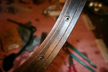

Recently, while changing the oil in my 1926 TuDor, I noticed that the low speed band spring was compressed more than the other two. I saw this as a indication that the low speed band may be worn. Since I have not opened up the engine in a while, I removed the engine to make a few clearance checks and checks for damage. I use wooden bands. Once the low speed band was out, I noticed an odd wear pattern on the face of the band. I also found that the band was split long wise. Looking closely, I believe the band was not clamping the drum uniformly. Seems that the band edge that is closer to the reverse drum was making drum contact before the other edge. Using a Vernier (I know that measuring wood with a veriner is not accurate, but I tried to apply equal pressure on each measurement and only considered average valves of many measurements), I measured the wood thickness every 45°. I also have a new band which I also measured for comparison. I found that the band edge close to the reverse drum is 0.025-0.030" thinner than the other side and maybe 0.010" thinner than a new band, wear. Trying to figure out why the band wear is askew as it is, I looked at the metal sheath of the band. It is not twisted and out of round. All the rivet were tight. The other bands do not show this wear. I did notice that the pedal shaft is rather sloppy in the hogs head bore. I would estimate that the low speed shaft bore has about twice the wear as the other pedals. I will have to remove the shaft to exactly measure it.
The picture doesn't show the wear in a lot of detail, but....... What do you think, could this pedal wobble cause this type of wear on the band? Any other ideas or things to look at? Thanks Mike

I would suspect the band is overlapping the reverse drum and when you push the low pedal, you are hitting the reverse drum. Even when the band is clamped on the low drum the reverse drum is still rotating, and so you have some additional wear on that part of the band.

You have a point, but look closely at the picture. The wear pattern extends to the middle of the band. I don't think that there is that much room to move. In my mind if the low speed band were riding on the reverse band the wear would be narrower, maybe 1/4". I'm still leaning toward band twist. Thanks Mike

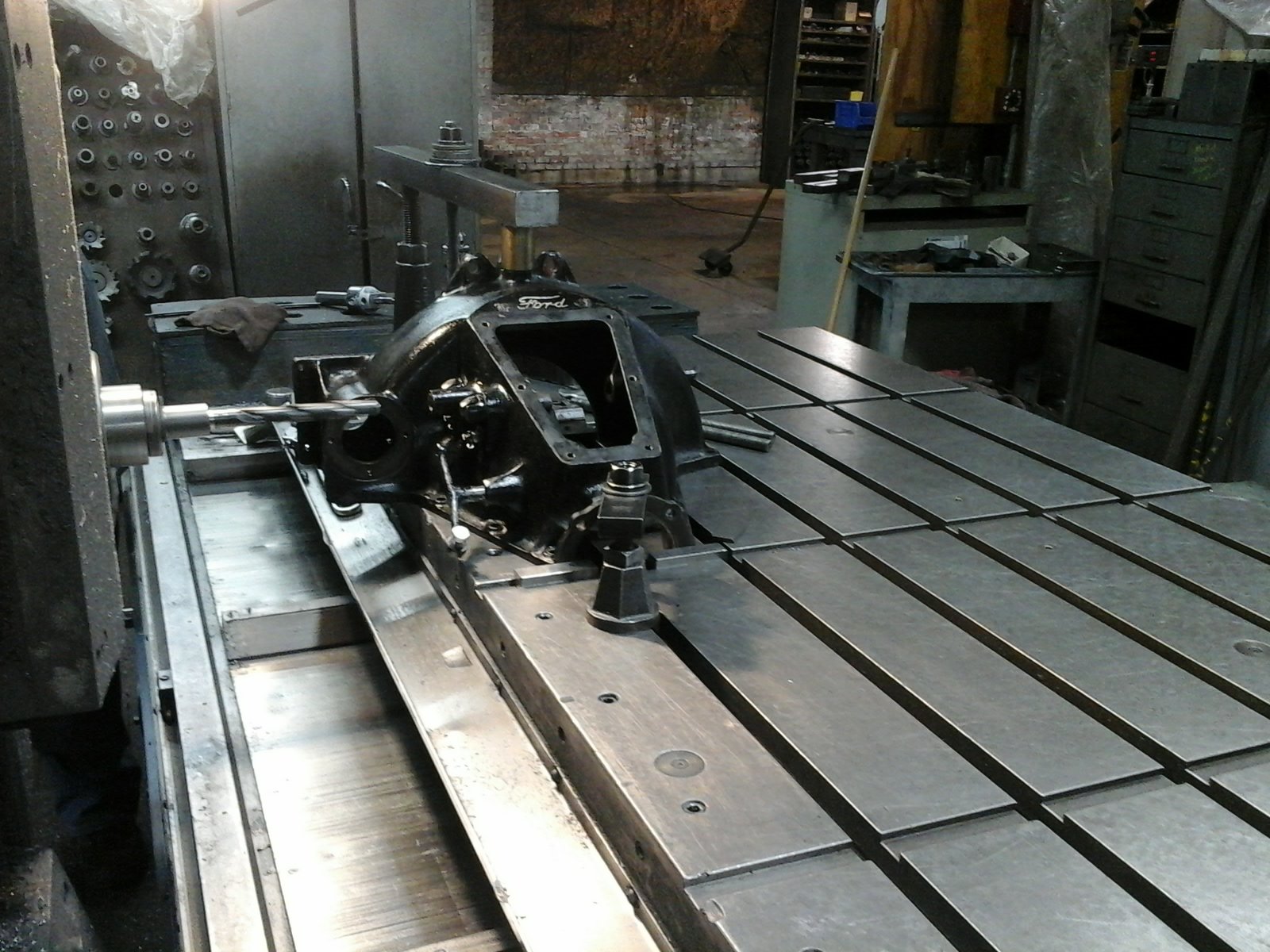

Well today the low speed pedel hole was bored out and a bronze bushing was installed. The hogshead was clamped down, the center of the hole was found. A drill bit removed 75% of the material and then a bore opened the hole so that the bushing could be installed. This made a vast improvement. Mike
