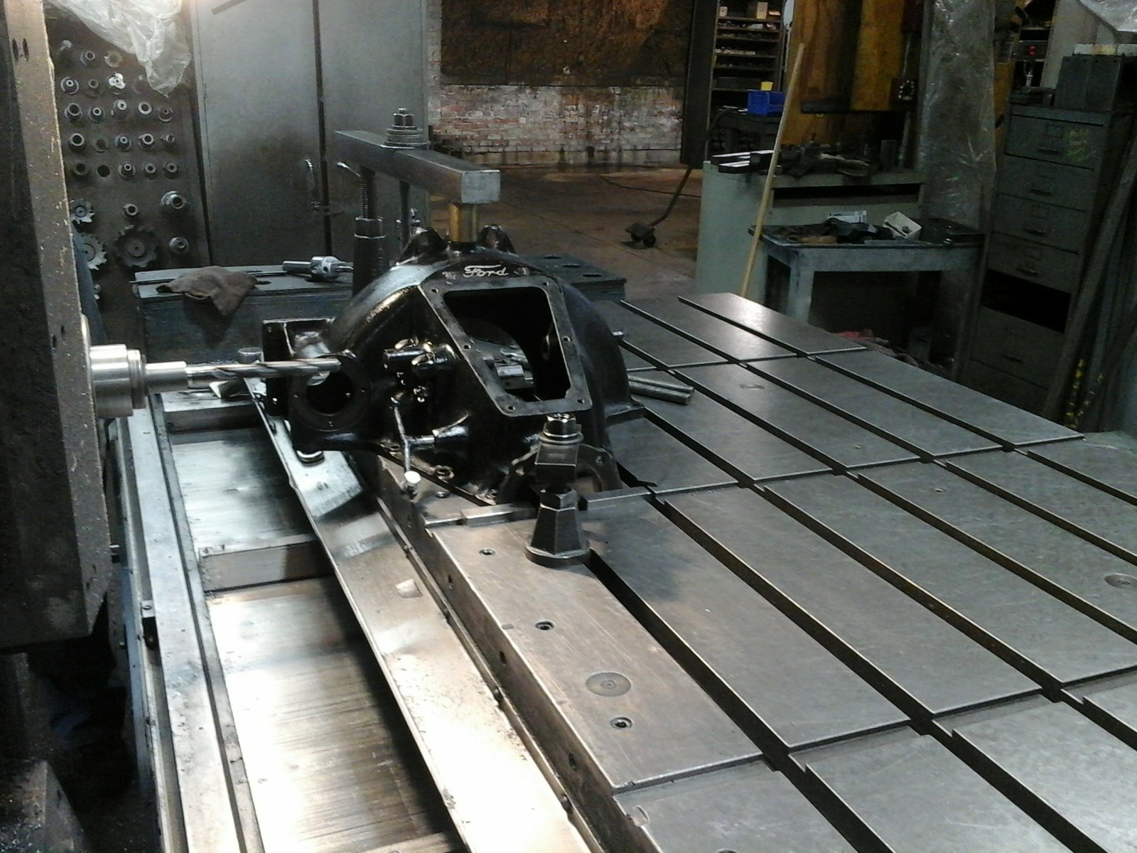

Post by mike zahorik » Fri Jun 07, 2019 2:40 pm
Well today the low speed pedel hole was bored out and a bronze bushing was installed. The hogshead was clamped down, the center of the hole was found. A drill bit removed 75% of the material and then a bore opened the hole so that the bushing could be installed. This made a vast improvement. Mike
Posts: 6792
Re: Band Wear
Post by Scott_Conger » Fri Jun 07, 2019 4:59 pm
Mike
good for you
the vast majority of hog's heads are totally shot and are NOT remedied when bands are changed. A properly repaired car in all aspects is so much nicer to drive than most Ts on the road. The hog's head is an incredibly overlooked part during repair phase. Even rebuilt engines, if not done by a T specialist, will sport a worn out hog's head in many if not most cases.
The sad thing is that many many owners have only driven 1 car...theirs, and assume that their car is performing as new. They are not.
You're going to love how the pedal feels under your foot...again, Kudos.
