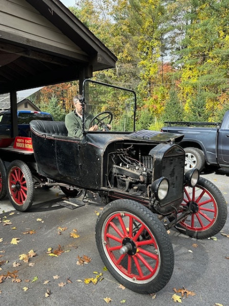

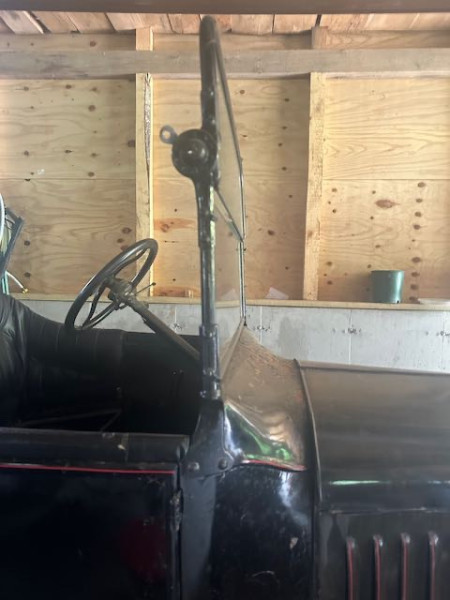

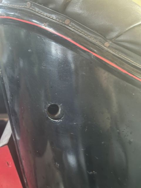

As a newer T owner I'm having fun learning about the history of the vehicles, in part figure out what combination mine consists of. Lots of resources out there for "dating" the vehicle, including here, which I really appreciate. So far I've determined the following - I'm wondering if there are any other obvious portions I can determine:
-Engine - July 8, 1924 (that was the easy one!)
-High radiator - post mid 1923 ('24 model year)

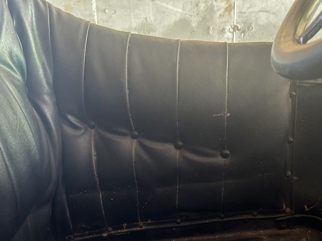

-high cowl, again '24 model year or later (looked in passenger compartment as per this post: http://www.mtfca.com/discus/messages/17 ... 1294054892 )
-straight windshield ('22 or earlier) - I'm thinking the supports and windscreen were replaced at some point given the high cowl and engine date, but who knows!

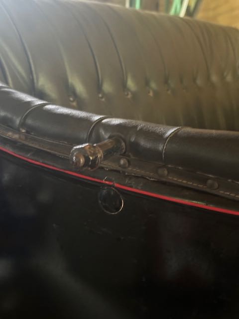

I read a comment about the attachment points for the 1 vs 2 man tops being different, but I've not figured out if that is actually true, or if it applies to roadsters or not. Here are the places I see - I'm curious if anyone has information they can share, as well as if there are other portions of the T that would help sort out how much is '24 or '25 vs earlier.
I'm in the middle of replacing the band linings and manifold gaskets, and hope to be on the road soon, though most of this vehicles use is winter time (narrow (38") Snowmobile)

It is a 1924 with the wrong windshield.

What is interesting about your car is that it has the top brackets that appear on the later mid 23 to 25 bodies. The earlier low cowl cars have the top rear brackets coming over the top rear of the body instead of going through it. The terminology 2 man top is for the low cowl Touring cars only because they have the middle post that the middle top bows go on. The later cars don’t have the middle bows but only the back bow and usually 1 man can raise the top. Others can clarify but that’s generally the way it is.
The low cowl years leading into 23 to 25 can get confusing because of the transition and how to exactly date a car. It’s definitely not an exact science because when the bodies were shipped to the branches and when they finally assembled among other things!
Your car has the straight low cowl windshield but appears to have the later body which usually has the slanted windshield. If your car is a high cowl car and has the straight windshield which others can comment what the date should be. So the question is should a straight windshield be on a high cowl car. The engine may or may not be correct either because the engines would interchange for the 17-25 years. A lot could have happened after nearly 100 years and it did! It may have the wrong windshield on it.
A good source that you may know of is the encyclopedia that can be found on this website thats answers about the Model T history and the progressive changes when they occurred. It’s one of the best info guides there is! Check it out!

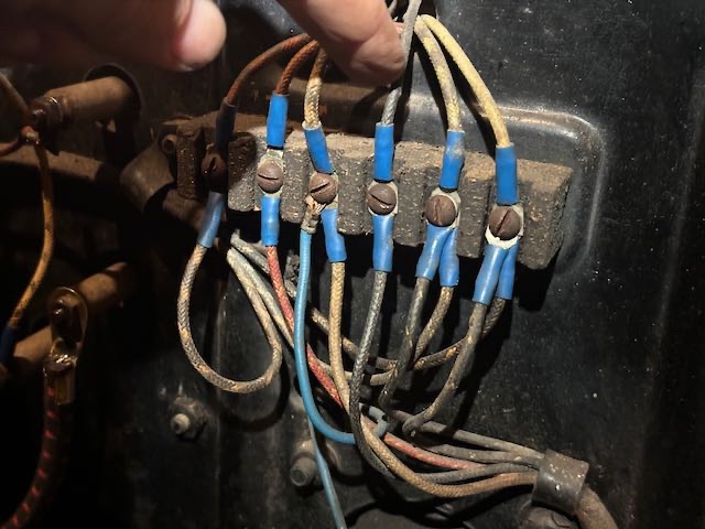

I would like to see more clues: Front view; passenger side view of the whole door; hand brake quadrant; view of the firewall (engine side) including the terminal board.

Thank you all for the responses! I'll get more images up this weekend when I'm back working on it. For the passenger side door (only door) interior or exterior? Here are some images I've already taken, but as they were not taken specifically for the purpose of dating the vehicle they are likely not good enough. Some may look a little odd (door and brake quadrant) as I had to lighten them up significantly to bring out the features.
I did measure the width of the firewall, and it also aligns with a '24 and up model year (28").
At a minimum the windscreen has certainly been replaced, but I expect to find more. I have a verbal history of the vehicle only, and know it was last restored in the early 60's in upstate NY.
Thank you all very much! Looks like I'll be looking for a '24 or so slant windshield with safety glass and bows for a one man top...

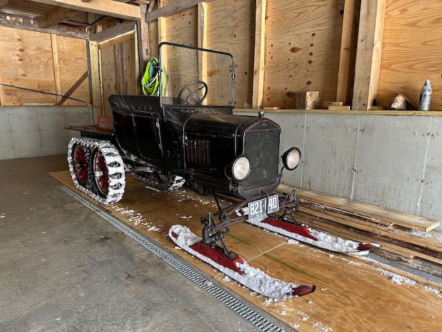

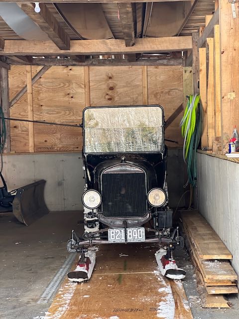

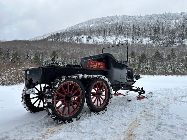

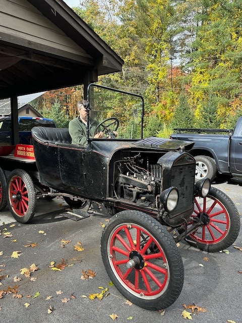

The verbal history indicates it was a Snowmobile purchased directly from Virgil White's Snowmobile operation in Ossippee; as such never had any running boards or front fenders and has some unique features (very narrow - center of tire to center of tire is 38"), Ruxtall rear end, and the rather obvious extra axle!) I suspect it has had some replacement parts over the years, and am enjoying trying to figure out the different vintages, as well as trying to date the majority of the vehicle. So far it appears other than the windshield everything dates to mid-1923 through 1925, which aligns nicely with the 1924 engine date, but the point of my post is ask for help in figuring out what else is likely from that date range and what isn't, hence some the detailed images.
Here are a few images of the Snowmobile as a whole:)

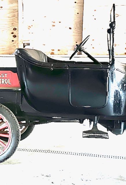

Exterior, from a little toward the front. 45º would be OK.

If the car was once a snowmobile T the windshield may be unique for the T snowmobile. Others would know for sure.

The door hinge protrusions appear to be equal length short. 1925 only?

Upper protrudes more I’m somewhat certain. I did take a picture yesterday but too much backlighting.

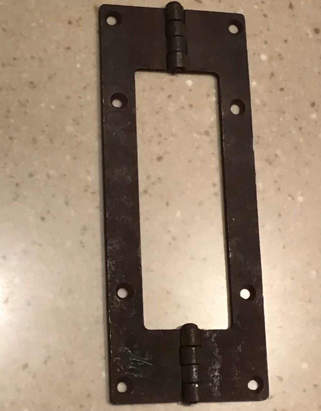

Here’s a photo of a 1925 touring and roadster door hinge. As you can see it’s straight. The 24 hinges and back are angled. The 25 hinges are straight. You can open your door up to see if it’s straight like the one pictured or angled as the earlier ones are. If your car is a 24 the hinge won’t be straight.
