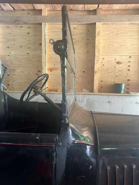

As a newer T owner I'm having fun learning about the history of the vehicles, in part figure out what combination mine consists of. Lots of resources out there for "dating" the vehicle, including here, which I really appreciate. So far I've determined the following - I'm wondering if there are any other obvious portions I can determine:
-Engine - July 8, 1924 (that was the easy one!)
-High radiator - post mid 1923 ('24 model year)
-high cowl, again '24 model year or later (looked in passenger compartment as per this post: http://www.mtfca.com/discus/messages/17 ... 1294054892 )
-straight windshield ('22 or earlier) - I'm thinking the supports and windscreen were replaced at some point given the high cowl and engine date, but who knows!
I read a comment about the attachment points for the 1 vs 2 man tops being different, but I've not figured out if that is actually true, or if it applies to roadsters or not. Here are the places I see - I'm curious if anyone has information they can share, as well as if there are other portions of the T that would help sort out how much is '24 or '25 vs earlier.
I'm in the middle of replacing the band linings and manifold gaskets, and hope to be on the road soon, though most of this vehicles use is winter time (narrow (38") Snowmobile)

It is a 1924 with the wrong windshield.

What is interesting about your car is that it has the top brackets that appear on the later mid 23 to 25 bodies. The earlier low cowl cars have the top rear brackets coming over the top rear of the body instead of going through it. The terminology 2 man top is for the low cowl Touring cars only because they have the middle post that the middle top bows go on. The later cars don’t have the middle bows but only the back bow and usually 1 man can raise the top. Others can clarify but that’s generally the way it is.
The low cowl years leading into 23 to 25 can get confusing because of the transition and how to exactly date a car. It’s definitely not an exact science because when the bodies were shipped to the branches and when they finally assembled among other things!
Your car has the straight low cowl windshield but appears to have the later body which usually has the slanted windshield. If your car is a high cowl car and has the straight windshield which others can comment what the date should be. So the question is should a straight windshield be on a high cowl car. The engine may or may not be correct either because the engines would interchange for the 17-25 years. A lot could have happened after nearly 100 years and it did! It may have the wrong windshield on it.
A good source that you may know of is the encyclopedia that can be found on this website thats answers about the Model T history and the progressive changes when they occurred. It’s one of the best info guides there is! Check it out!

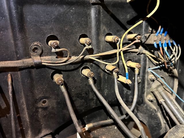

I would like to see more clues: Front view; passenger side view of the whole door; hand brake quadrant; view of the firewall (engine side) including the terminal board.

Thank you all for the responses! I'll get more images up this weekend when I'm back working on it. For the passenger side door (only door) interior or exterior? Here are some images I've already taken, but as they were not taken specifically for the purpose of dating the vehicle they are likely not good enough. Some may look a little odd (door and brake quadrant) as I had to lighten them up significantly to bring out the features.
I did measure the width of the firewall, and it also aligns with a '24 and up model year (28").
At a minimum the windscreen has certainly been replaced, but I expect to find more. I have a verbal history of the vehicle only, and know it was last restored in the early 60's in upstate NY.
Thank you all very much! Looks like I'll be looking for a '24 or so slant windshield with safety glass and bows for a one man top...:)

More all around pictures will definitely help. The ones you posted of the body seem to show your car may have been put together with various parts. Don’t know for sure but it may have been a partial body only without the running boards, splash aprons, fenders and rear deck. The rest may have been added later. A lot of T’s were built up from parts. If you have a frame, engine and running gear find a partial body and go from there. Or it could be your car was made into a pickup/runabout from the original. It’s a fun car to have and there are a lot out there like yours or similar. Finding the correct windshield would be a positive thing.

If the car was once a snowmobile T the windshield may be unique for the T snowmobile. Others would know for sure.
