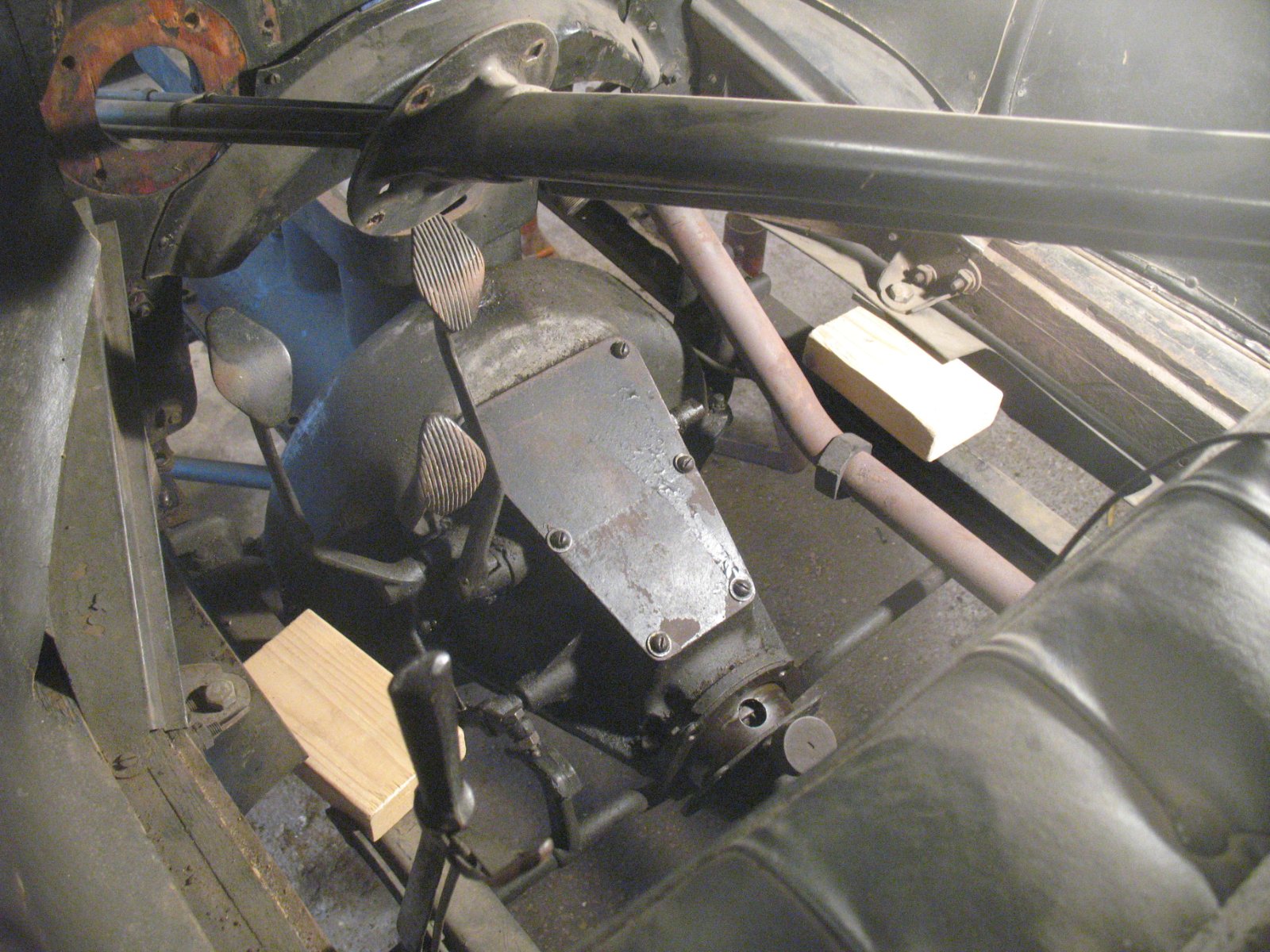

My internet died, so I'm starting over. The idea of raising the body is correct. Take the nuts off the front and middle body bolts, and loosen the two rear ones. Raise the front of the body and put a couple of blocks under it. The pan arms will slide forward as you pull the engine. You don't need to do anything with the firewall.

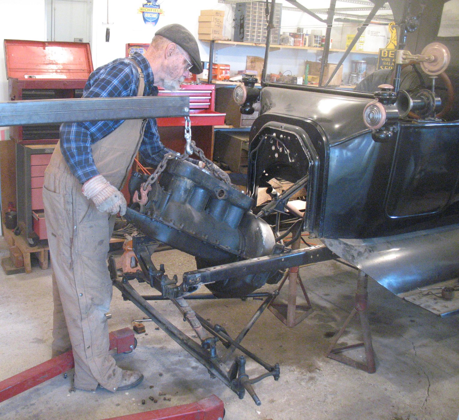

A long time ago, one of my first mentors in the antique automobile hobby had a 1915 runabout, and needed to repair something in the engine. So i went over for a couple evenings to help remove and then replace the engine after he fixed what needed fixing.
We did it as Steve Jelf said. Loosened the two rear body mount bolts, removed the middle and forward body mount bolts as well as the firewall to frame bracket bolts (I think that was the hardest part of the whole process, and they weren't that difficult). The drag link and steering column to frame bracket had to be unbolted also. The steering column was left on the firewall and we had to maneuver the engine around it a bit. As I recall, the hogshead was still on it, and we pressed the pedals down enough to clear the raised body and firewall.
I think we raised it about six inches in the front. Leaving the rear body mount bolts in place but loose kept the body basically in place, and made dropping it back down easier to line things up.
It wasn't difficult.
If I ever have to pull the engine on my 1915 runabout, I plan to do it the same way.
