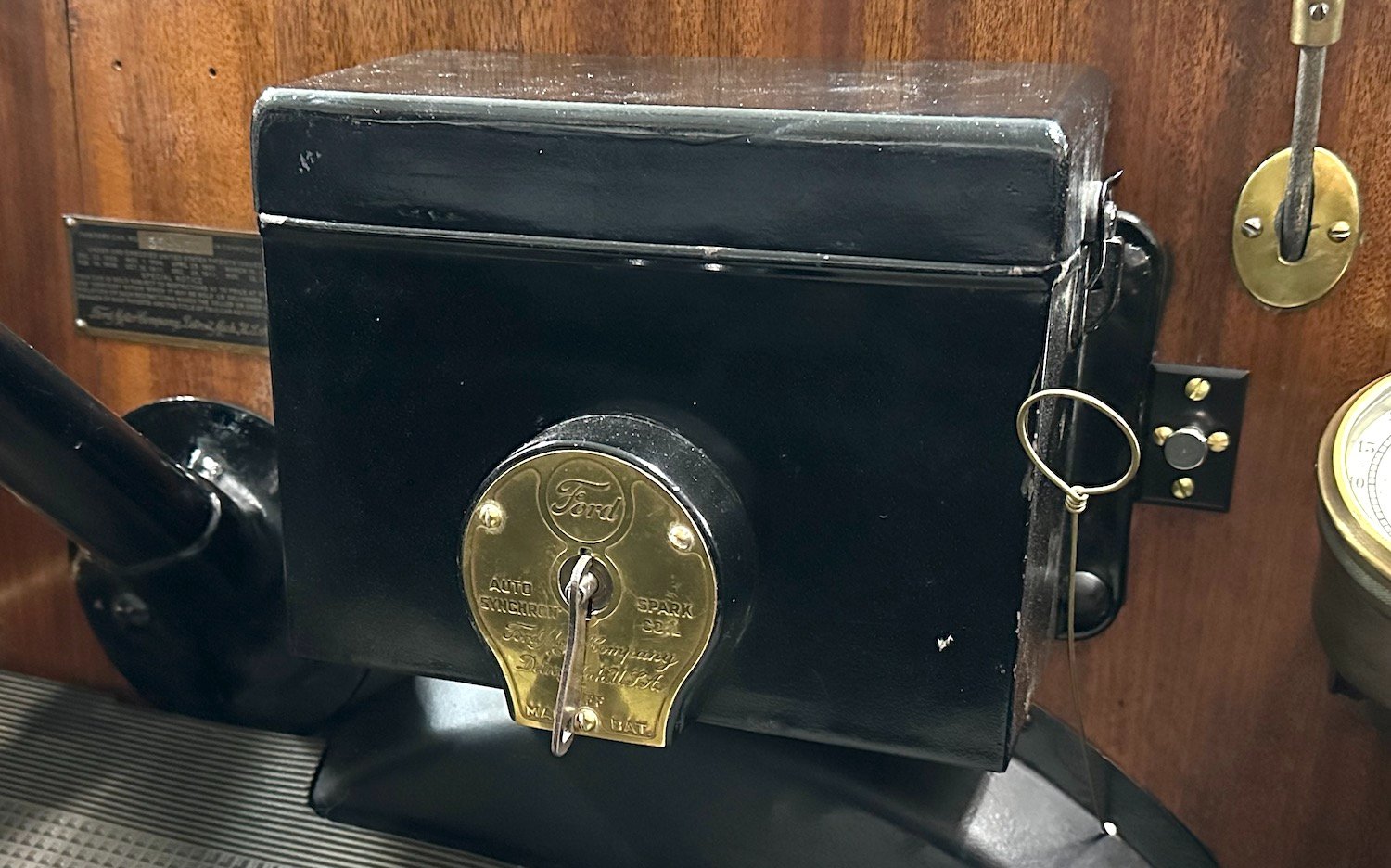

Is the push-pull switch for your head lamps or your ignition ? Whatever you do, don't jump the battery to your magneto terminal.
That's a standard '14 switch on the front of the coilbox.

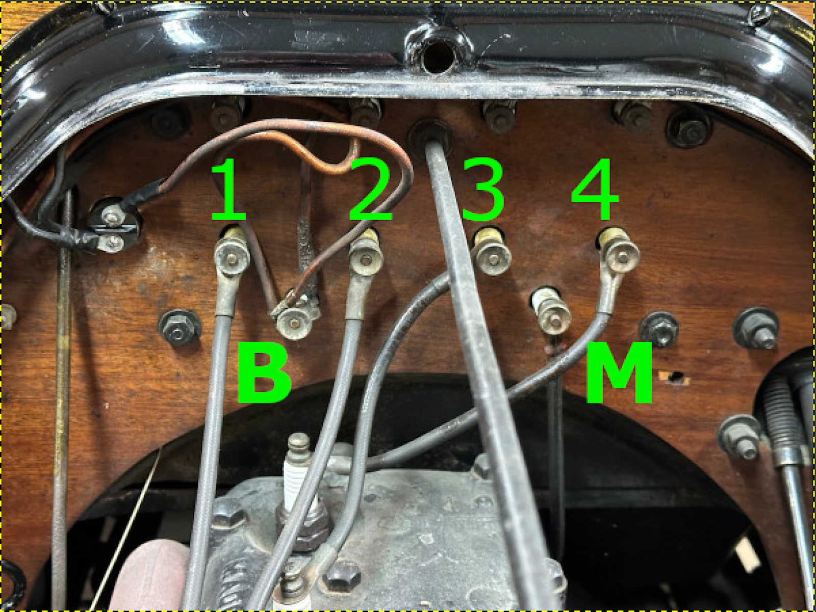

- Posts: 7413
Re: Hot Wire a Model T?

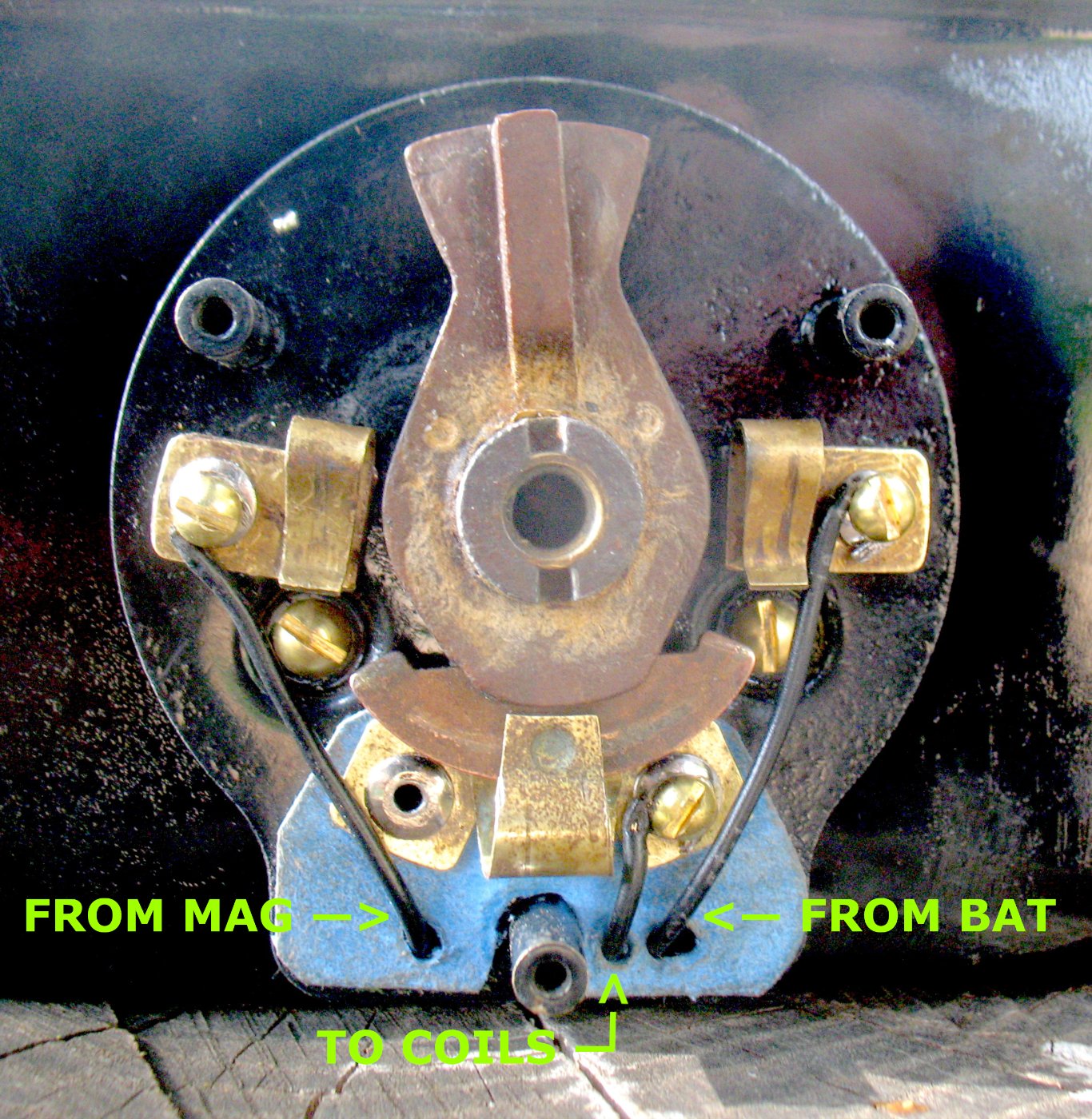

M is where the wire from the magneto attaches.
B is the terminal fed by the wire from the battery. You also see a wire from there to the headlight switch (left side of the picture). At the top, almost hidden by the hood former is where the timer wires are attached. The timer is a switch that fires each of the coils in 1, 2, 4, 3 order.
Of course, if your switch has been "remodeled" all bets are off. Now that I've confused everyone, I hope something I'v'e posted will be of some use.

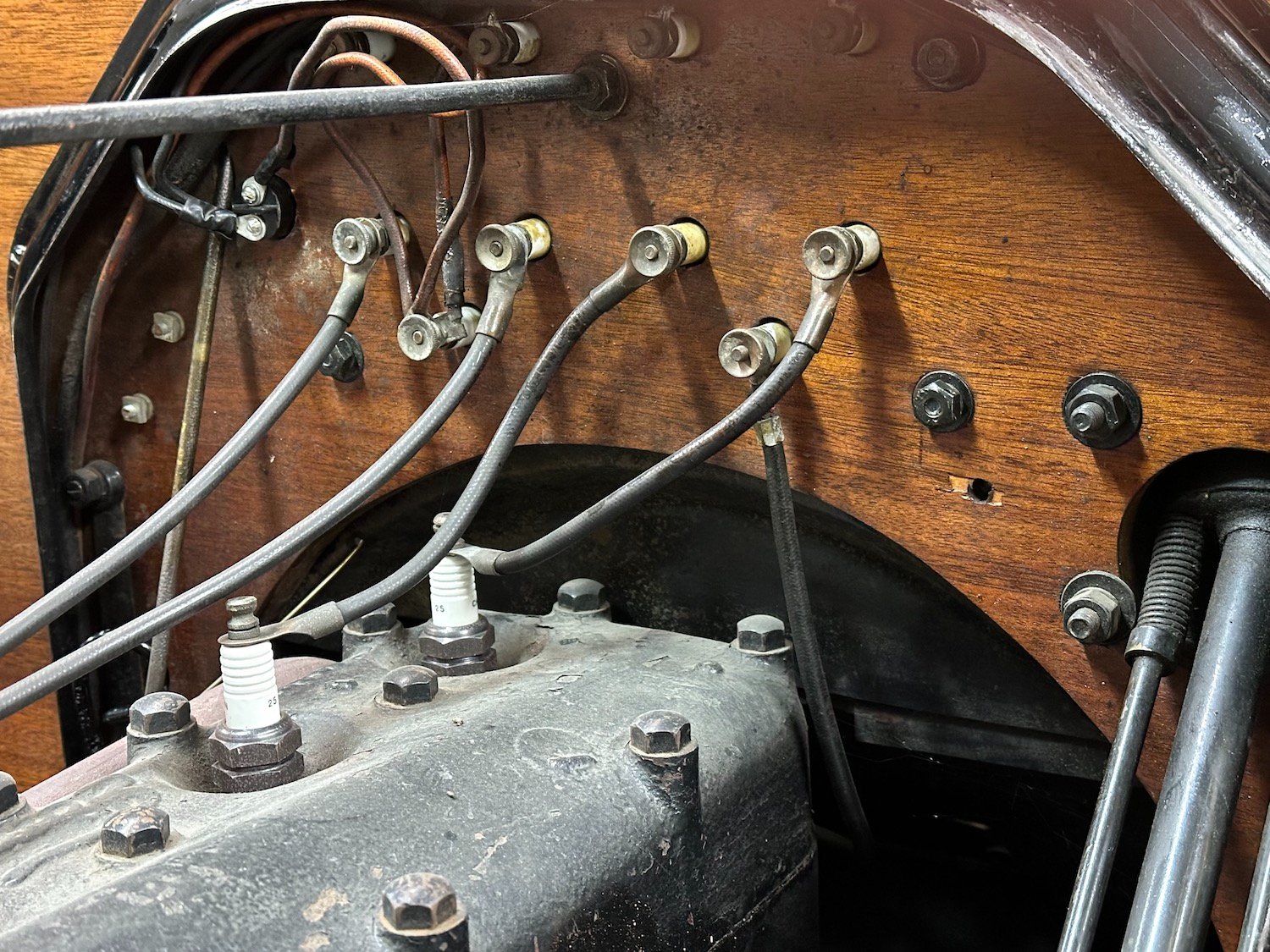

Troubleshooting Model T ignition issues with E-Timer Electronic Ignition installed is not the same as Troubleshooting a stock Model T ignition.
Do NOT "HOT WIRE" timer wires to ground to see if coils will Buzz!
Doing so will instantly BLOW the fuse jumpers installed across the coil points requiring removal and replacement fuse jumpers.
Here are a few troubleshooting suggestions:
With the car setup for normal engine starting (ie spark lever fully retarded, transmission in neutral, ignition power on set to battery, etc.) Slowly hand crank the engine and listen for coil point buzz while turning the crank 2 full revolutions. Each coil should buzz once after 2 crank shaft revolutions. Use caution when hand cranking engine because the engine may start even if it does not start using the starter motor.
1. If no coil buzz is heard while hand cranking the engine, check positive battery power (+6 to +12V) is present at each timer terminal using a DC voltmeter with respect to frame ground. (Be careful not to short the timer terminal to ground with the voltmeter probe or you may blow the fuse jumpers! ) If no battery power is present at any timer terminal, check battery power is present at the coil box battery terminal. If so, trouble shoot coil box power distribution. If not, trouble shoot why power is not getting to the coil box; the ignition switch is a common candidate vulnerable to contact failure. If this is the first time the car is being fitted with an E-Timer and battery power is present at the timer terminals, verify the E-Timer housing is making metal to metal contact with the mating surface on the timing cover. Newly rebuilt engines may have a fully painted timing cover that prevents the E-Timer housing from contacting engine ground. If so, remove the paint on the timing cover where it contacts the E-Timer.
2. If no coil buzz is heard during hand cranking 2 revolutions and battery power IS present at the timer terminals. The E-Timer internal fuse may be blown and will need to be returned for repair. Known causes of internal fuse blowing:
a. Metal coil box lid removed or replaced while ignition powered or operating, shorting coil points together or to ground while powered.
b. Improper routing of spark plug wires. Its good practice to route spark plug wires to remain a minimum 1" clearance from ANY other
objects between the spark plug and coil box terminal. Old, worn, dried out or cracked spark plug wire insulation can allow spark to jump to
adjacent objects such as other spark plug wires or timer wires which can damage the E-Timer. This is especially true for sharp edges of the
spark plug wire terminals. Your #2 spark plug wire looks like its sitting on or close to spark plug #3 in your first photo!
3. If each coil is verified to buzz once when slowly hand cranking the engine 2 revolutions but engine still will not start when electric starter engaged. The problem may be low voltage during electric starter cranking due to the heavy current draw by the starter motor. The engine may crank and crank and crank without a putt or without starting but does start immediately upon release of the starter switch. This is a sure sign low battery voltage during starter motor starting. Known causes of low battery voltage during starter motor cranking.
a. Weak or bad battery. Test the battery using a load tester after fully charging the battery. Replace if the battery is weak or bad. Battery
lifetime is typically 5 years or less.
b. Loose or corroded battery terminals, Starter switch terminals, starter switch contacts. Clean and tighten all battery power connections.
c. Check if battery terminals or connections get hot after starter cranking. Heat is a indicates power dissipation and subsequent voltage drop
d. Check battery ground strap is rated for battery voltage in use; 6V battery must supply twice the current compared with 12V battery to supply
the same starter power. A 12V battery ground strap installed with a 6V battery may drop too much voltage during starter cranking. The
battery ground strap should Not get warm or hot after cranking. If so, replace the ground strap with a 6V rated ground strap with good
electrical contact to the frame.
Hope these suggestions help.

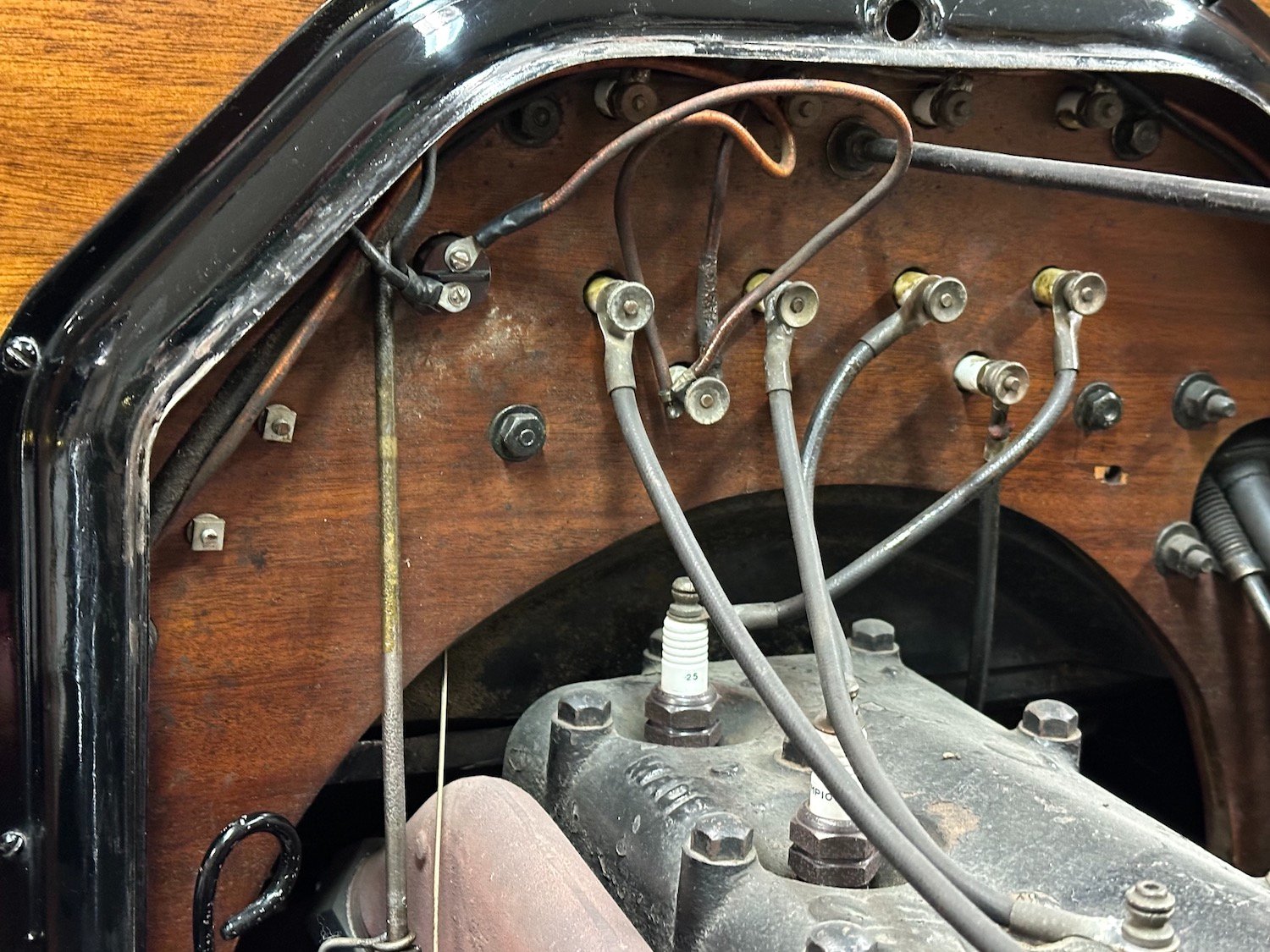

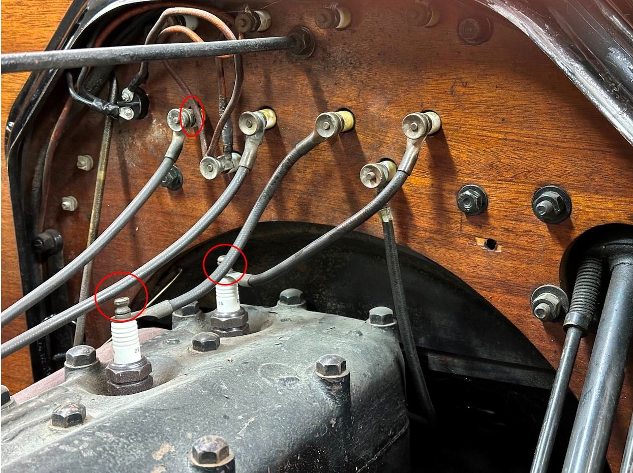

High voltage spark can jump between spark plug wires or from spark plug wires to other wires or objects IF the spark plug wires have old, worn or dried out or cracked insulation and should be replaced. It is good practice to route spark plug wires to maintain a minimum 1" clearance from any other object or wiring to reduce the chance spark energy is diverted from the any unintended place. This is especially true for any sharp edges of spark plug wire terminals as they are more likely to promote arcing to other objects or wires.
Note that errant spark plug wire arcing to unintended paths can damage the E-Timer, if one is installed, but also results in annoying engine misfire and loss of engine power because spark is diverted to the path of least resistance rather than the spark plug as intended.
Here are three places to check circled in red that appear less than 1" clearance between spark plug wires or terminals and other objects or wiring.

Thanks to everyone for the ideas here. Steve & Mike your pictures were helpful.
It sounds like hot wiring this Model T is not possible so I'll have to find a different way forward. The car was running happily when parked just a few weeks ago. The ignition has always been reliable in the past except for one time when it died on the road and coasted to a stop. Mysteriously, it restarted a few minutes later after I poked & prodded various items under the hood.
I do have a spare E-Timer if I have figured out a way to blow mine up but this seems unlikely as nothing in the ignition had been messed with since it last ran.
I will go though Mike's checklist and see what I can discover.

I wish we had an experienced hand near you. Many times a Model T won't start because of some simple thing. Then everybody says, "Why didn't I think of that?"

Thanks Steve, I too wish for some friendly help in these sorts of situations. Like many of us who have moved to rural locations from big cities I was well aware of the compromises such a move entails. I miss the warm embrace of the Orange County Model T Club very much. The meetings & tours were always fun and the great folks there even made breakdowns a fun experience. Whenever someone had trouble, the whole tour would stop and the mechanically minded would gather around and figure out what was wrong and try to set it right. As long as this didn't happen too often it was educational and enjoyable. Frequently a work party would form to help a member get an old T back on the road. It was great & I miss that.
On the other hand, I can actually drive my Model T here, more than just stop light to stop light. Its possible to put it in gear and roll for hours with few or even no stops and the scenery is grand. No one is worried by Model T speeds as the common farm equipment is even slower. Its a paradise for old car lovers. I'm sure you know all of this as you have often posted about it.
Reading through Mike's checklist, I see I have already messed up. I remember riding with a friend in his 1919 pickup which frequently had ignition problems. He would run with the coil box lid off & jiggle the coils or even shim them with matchbook covers while the engine was running to try to get it to fire on all cylinders. I tried something similar. With the key ON I removed the lid and got some sparks. Now reading what Mike posted I can see that was exactly the wrong thing to do. Whatever the initial malady might have been, I may have just earned to E-Timer issues on top of them. Drat!
Paul
