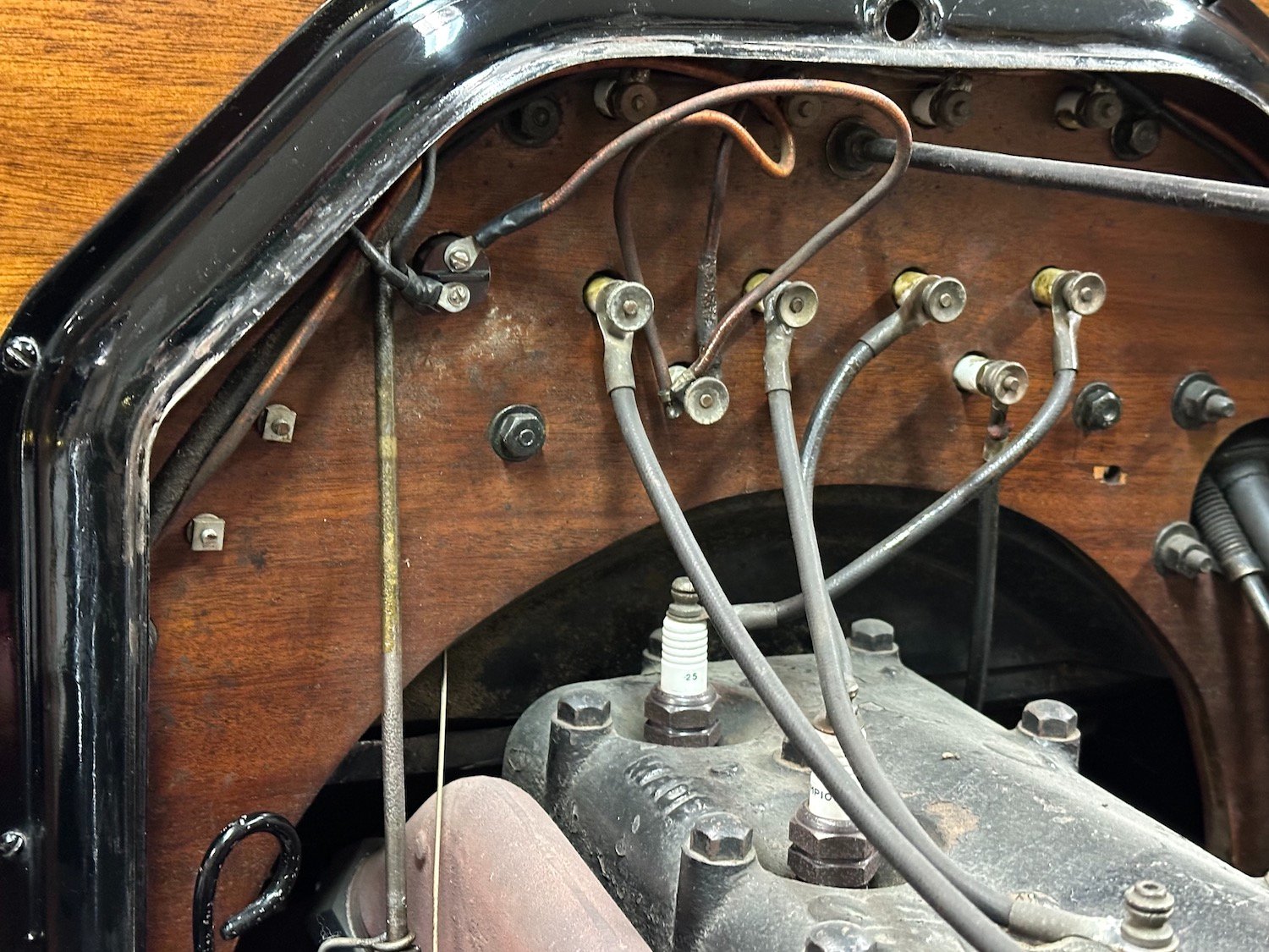

Troubleshooting Model T ignition issues with E-Timer Electronic Ignition installed is not the same as Troubleshooting a stock Model T ignition.
Do NOT "HOT WIRE" timer wires to ground to see if coils will Buzz!
Doing so will instantly BLOW the fuse jumpers installed across the coil points requiring removal and replacement fuse jumpers.
Here are a few troubleshooting suggestions:
With the car setup for normal engine starting (ie spark lever fully retarded, transmission in neutral, ignition power on set to battery, etc.) Slowly hand crank the engine and listen for coil point buzz while turning the crank 2 full revolutions. Each coil should buzz once after 2 crank shaft revolutions. Use caution when hand cranking engine because the engine may start even if it does not start using the starter motor.
1. If no coil buzz is heard while hand cranking the engine, check positive battery power (+6 to +12V) is present at each timer terminal using a DC voltmeter with respect to frame ground. (Be careful not to short the timer terminal to ground with the voltmeter probe or you may blow the fuse jumpers! ) If no battery power is present at any timer terminal, check battery power is present at the coil box battery terminal. If so, trouble shoot coil box power distribution. If not, trouble shoot why power is not getting to the coil box; the ignition switch is a common candidate vulnerable to contact failure. If this is the first time the car is being fitted with an E-Timer and battery power is present at the timer terminals, verify the E-Timer housing is making metal to metal contact with the mating surface on the timing cover. Newly rebuilt engines may have a fully painted timing cover that prevents the E-Timer housing from contacting engine ground. If so, remove the paint on the timing cover where it contacts the E-Timer.
2. If no coil buzz is heard during hand cranking 2 revolutions and battery power IS present at the timer terminals. The E-Timer internal fuse may be blown and will need to be returned for repair. Known causes of internal fuse blowing:
a. Metal coil box lid removed or replaced while ignition powered or operating, shorting coil points together or to ground while powered.
b. Improper routing of spark plug wires. Its good practice to route spark plug wires to remain a minimum 1" clearance from ANY other
objects between the spark plug and coil box terminal. Old, worn, dried out or cracked spark plug wire insulation can allow spark to jump to
adjacent objects such as other spark plug wires or timer wires which can damage the E-Timer. This is especially true for sharp edges of the
spark plug wire terminals. Your #2 spark plug wire looks like its sitting on or close to spark plug #3 in your first photo!
3. If each coil is verified to buzz once when slowly hand cranking the engine 2 revolutions but engine still will not start when electric starter engaged. The problem may be low voltage during electric starter cranking due to the heavy current draw by the starter motor. The engine may crank and crank and crank without a putt or without starting but does start immediately upon release of the starter switch. This is a sure sign low battery voltage during starter motor starting. Known causes of low battery voltage during starter motor cranking.
a. Weak or bad battery. Test the battery using a load tester after fully charging the battery. Replace if the battery is weak or bad. Battery
lifetime is typically 5 years or less.
b. Loose or corroded battery terminals, Starter switch terminals, starter switch contacts. Clean and tighten all battery power connections.
c. Check if battery terminals or connections get hot after starter cranking. Heat is a indicates power dissipation and subsequent voltage drop
d. Check battery ground strap is rated for battery voltage in use; 6V battery must supply twice the current compared with 12V battery to supply
the same starter power. A 12V battery ground strap installed with a 6V battery may drop too much voltage during starter cranking. The
battery ground strap should Not get warm or hot after cranking. If so, replace the ground strap with a 6V rated ground strap with good
electrical contact to the frame.
Hope these suggestions help.
MKossor
Posts: 529
Last Name: Kossor
Re: Hot Wire a Model T?
Post by MKossor » Wed Jul 24, 2024 9:03 am
High voltage spark can jump between spark plug wires or from spark plug wires to other wires or objects IF the spark plug wires have old, worn or dried out or cracked insulation and should be replaced. It is good practice to route spark plug wires to maintain a minimum 1" clearance from any other object or wiring to reduce the chance spark energy is diverted from the any unintended place. This is especially true for any sharp edges of spark plug wire terminals as they are more likely to promote arcing to other objects or wires.
Note that errant spark plug wire arcing to unintended paths can damage the E-Timer, if one is installed, but also results in annoying engine misfire and loss of engine power because spark is diverted to the path of least resistance rather than the spark plug as intended.
Here are three places to check circled in red that appear less than 1" clearance between spark plug wires or terminals and other objects or wiring.
