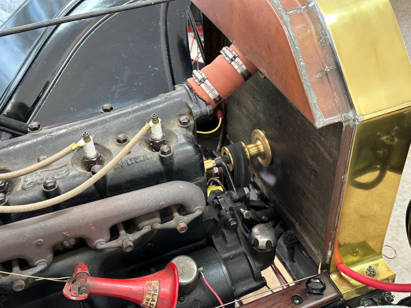

These pictures were taken with the engine roaring is wonderful 3 cylinder song.

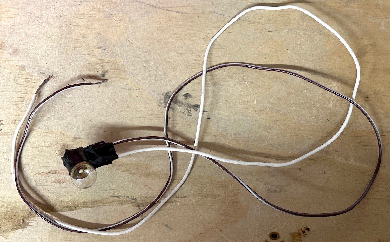

Last night I set out to see what I could discover with some helpful guidance provided by one of my pals in the Orange County Model T Club. He explained how to make a test light bulb which adds a "load" to the circuit and how to use that bulb to test the switch itself.

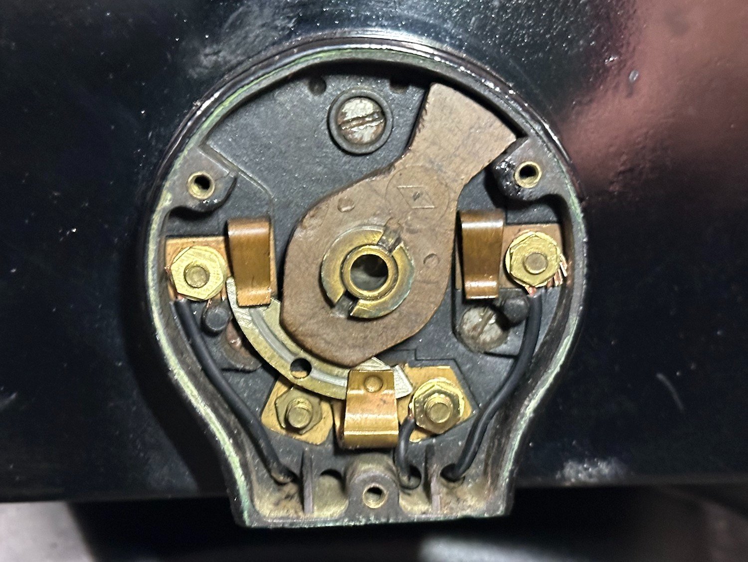

The first thing was to remove the brass cover off of the switch and back the screw out. This is the screw on the right side in the picture. Now the screw is no longer protruding into the coil box space.
Next, the battery was connected and the switch on to the BAT position with all four coils were inserted. The test bulb wires were connected to the manifold as a ground and the other wire to the various low tension posts, 1-4. The bulb did not light. The test was repeated with the meter, no voltage. Yes, the BAT post both lit the bulb & got 6+ v on the meter.
After that various combinations of coils in slots were tried. In all cases, the bulb lit unless there was a coil in the No.2 slot. When that happened, they ALL died and would not light the bulb. That No. 2 slot seemed toxic!
It made sense to investigate this so all coils were removed and only one coil was inserted in that toxic position. It lit the bulb!
Another coil was inserted in the No4 position. The bulb lit for both of them. The No. 1 slot was filled and the bulb still lit on all three. With much trepidation, I inserted the last coil in the No. 3 position fully expecting them all to die again. To my great joy, that did not happen, all four positions lit the bulb! I felt like jumping for joy.
While the coils were all working it seemed a good idea to try to start the engine. It coughed and hiccuped a few times but did catch and run and was smoother that the previous three cylinder session. The wire to the cutout was disconnected so I did not dare to run the motor for more than a few minutes. Who knows what electrical mischief the genny might get up to being turned without that wire being connected.
There it is right now. I will connect the wire and run it some more later after work. We shall see what additional adventures are in store.

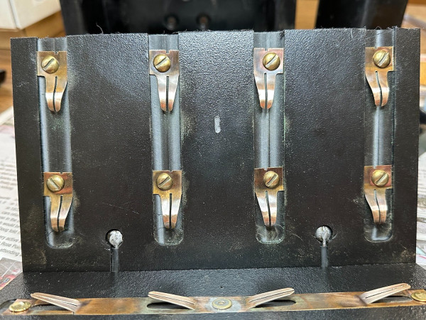

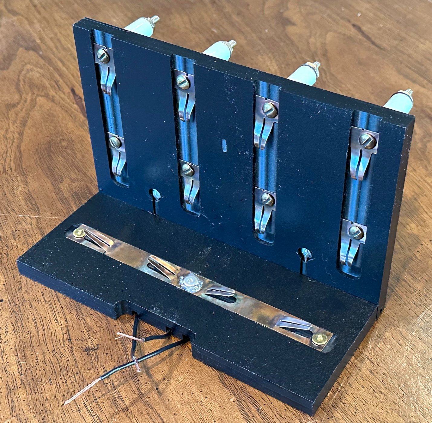

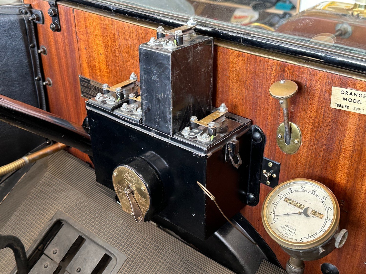

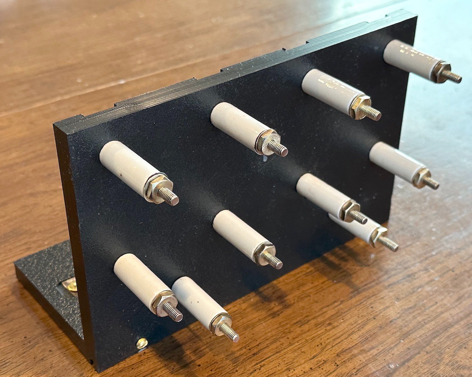

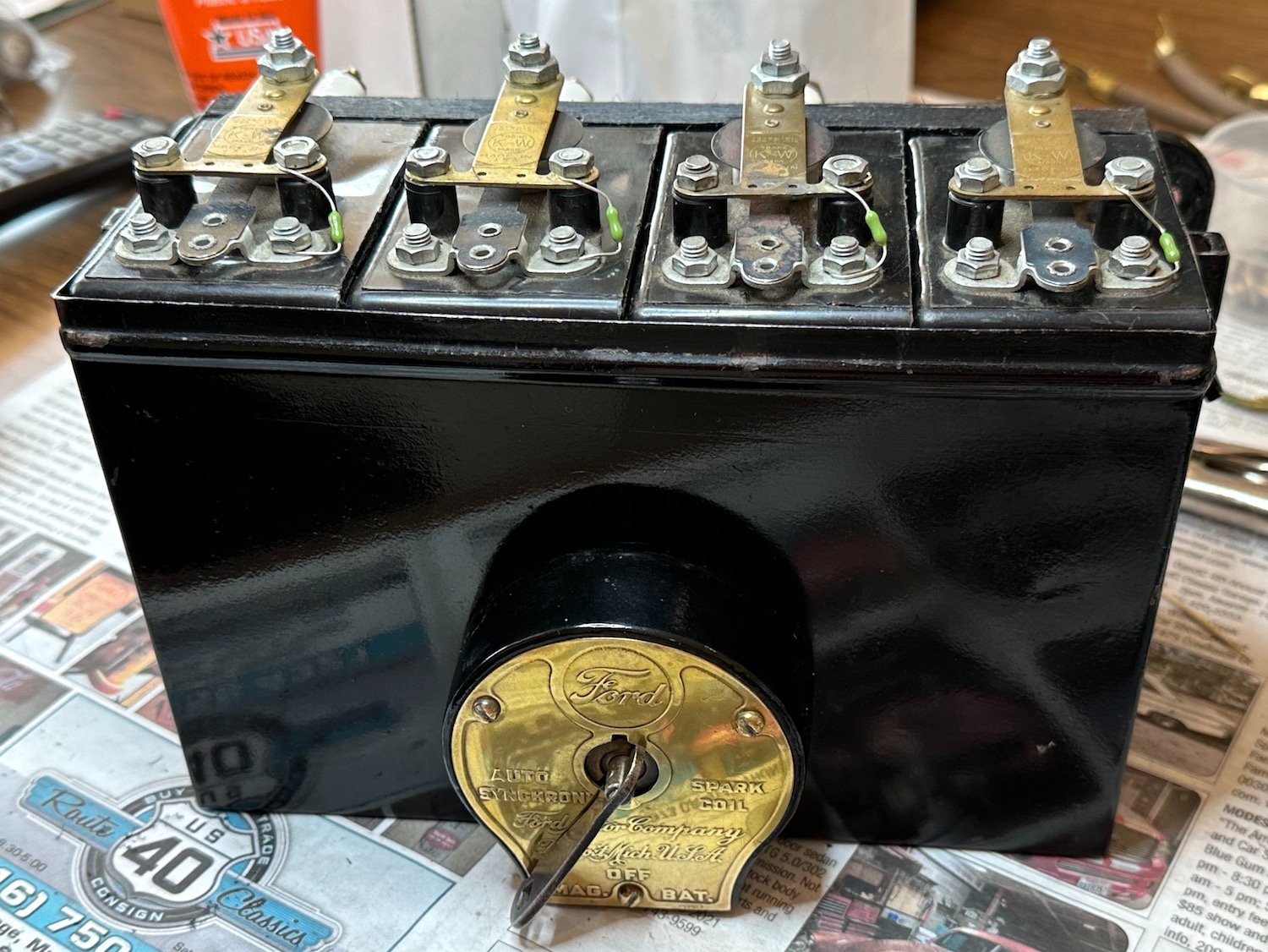

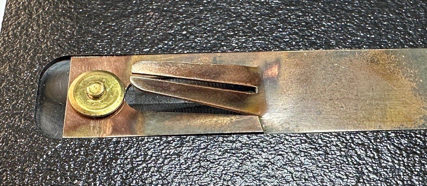

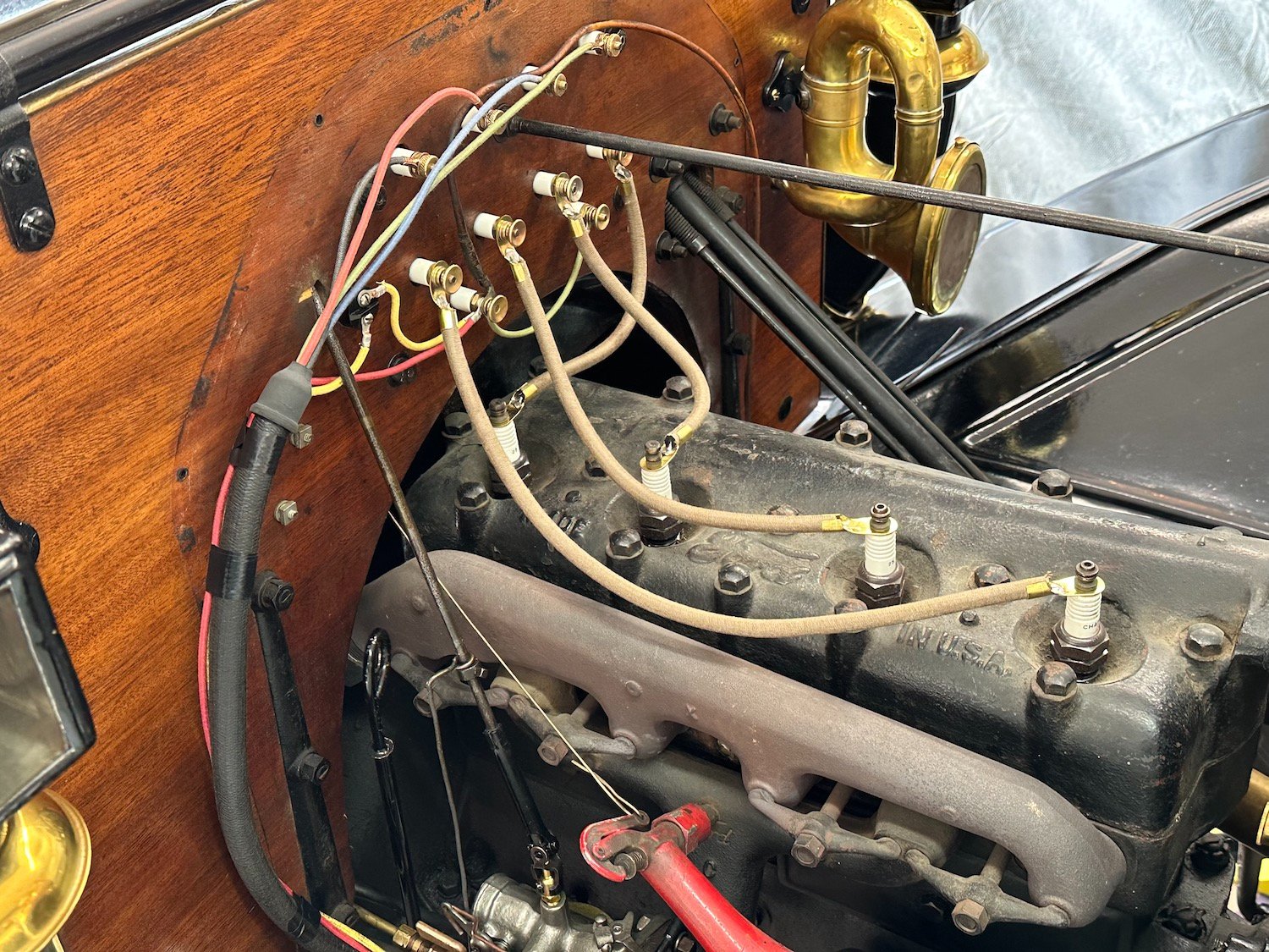

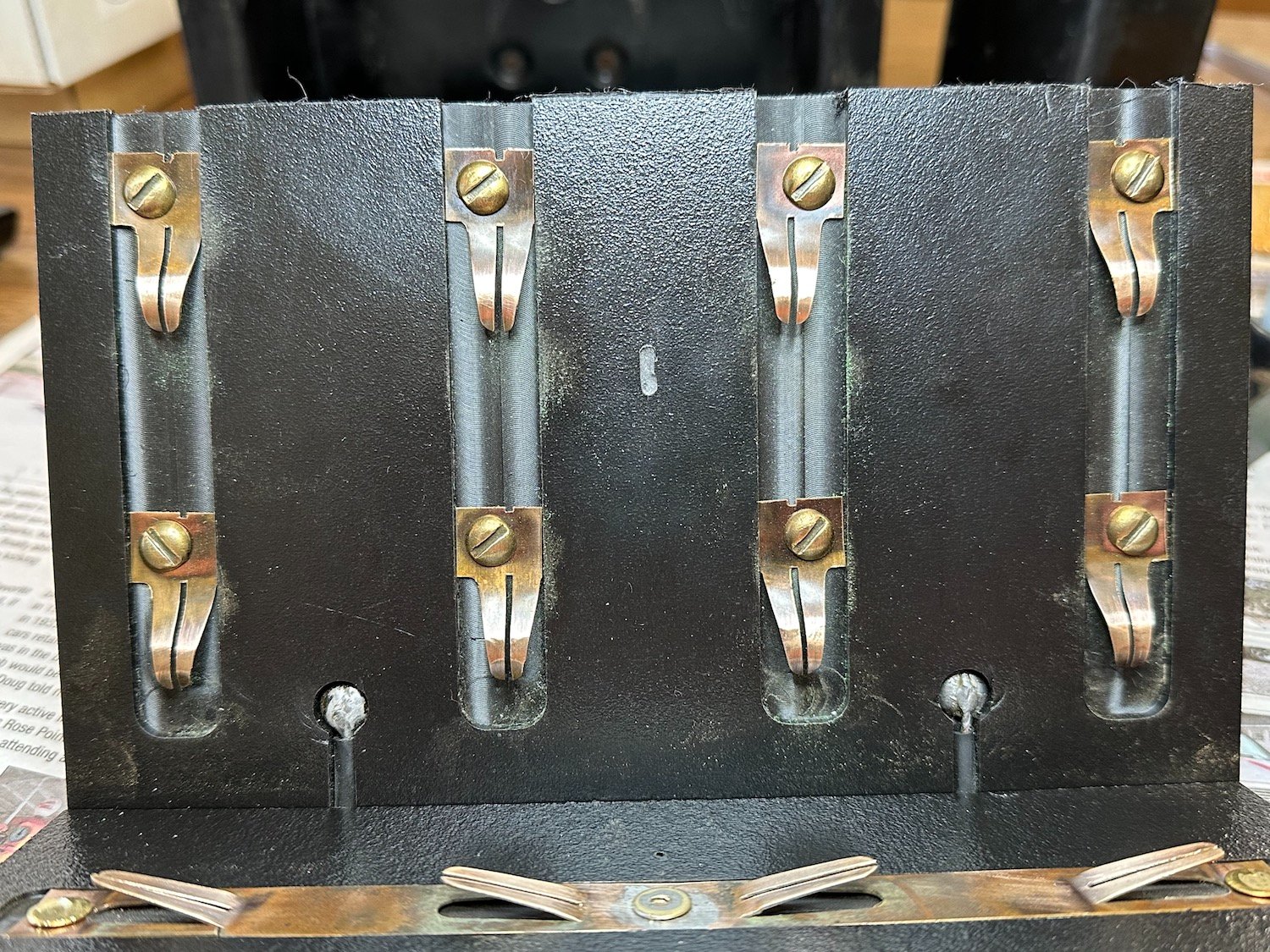

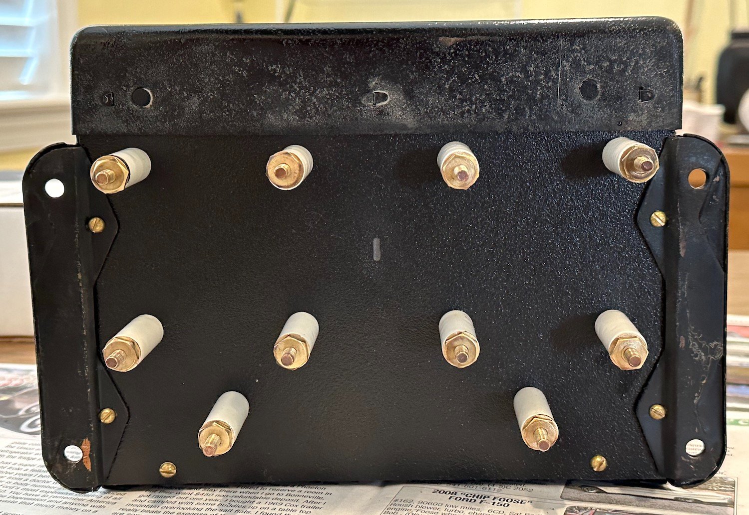

For those who did not follow the previous threads about this mystery, here are a few pics of the rebuilt coil box.
Paul
Paul

Paul, I would check the power wire and connection at the bottom bus bar if your problem continues. With the power lost happening after the fourth coil is installed it would point to a bad connection or wire at the bottom bus bar.

Paul, Would it be that you have installed the mounting screws of the lower bus bar up side down, because if the screws are too long they would hold up the coils up from the spring contacts of the busbar giving you no meter and or test light reading and an open circuit situation with your ignition coils....n

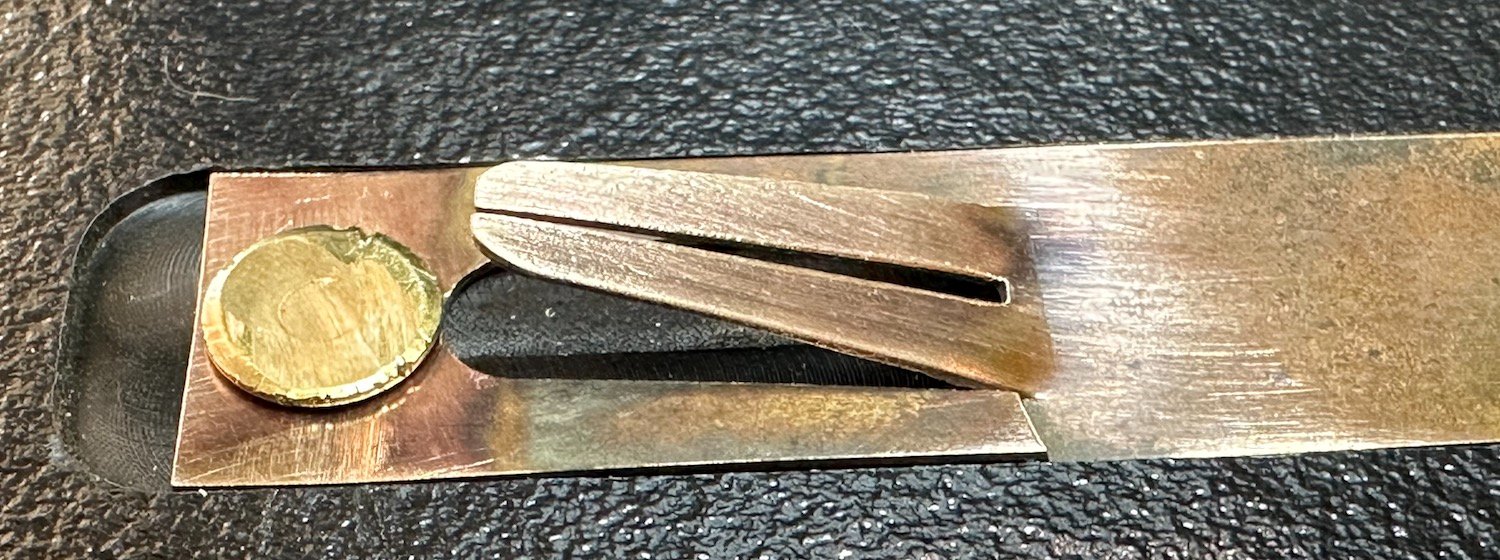

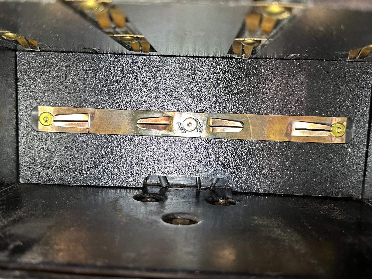

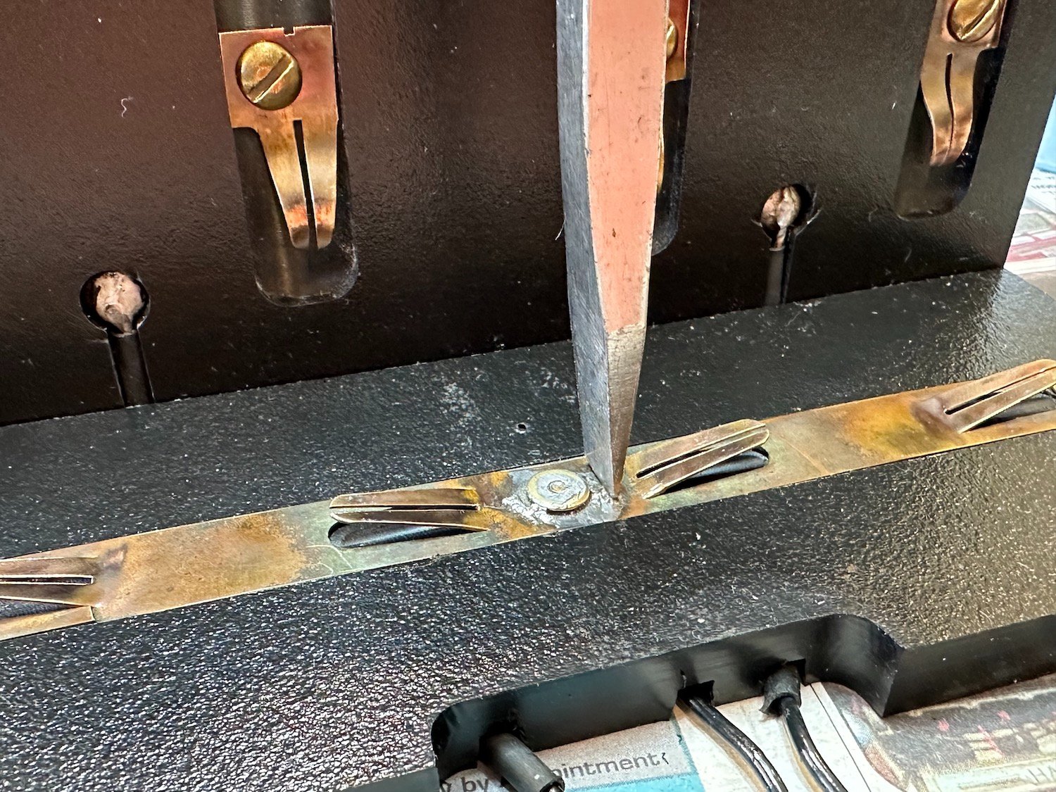

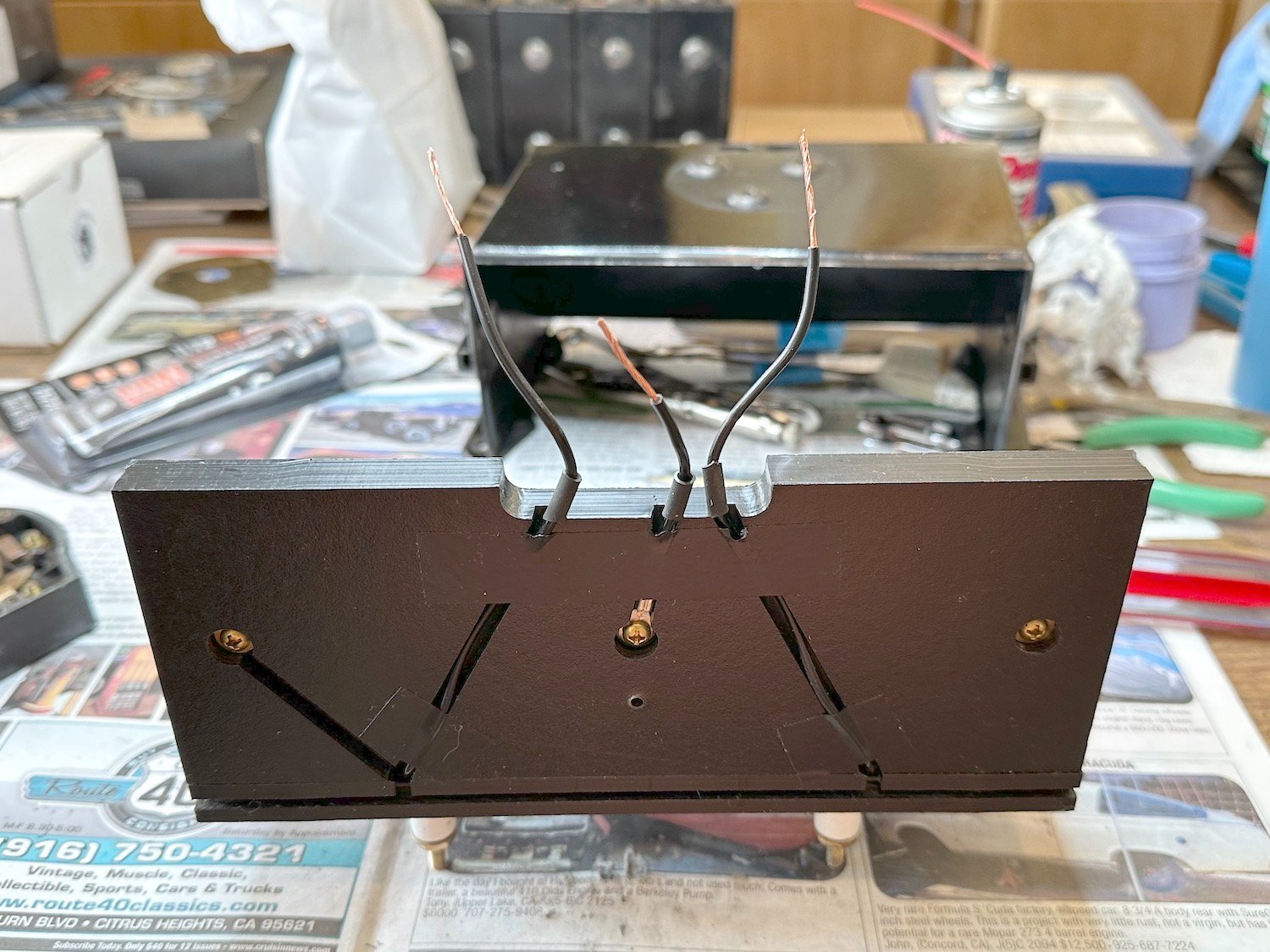

Those of you who suspected that the trouble lay in the coil box were correct. Even though I was being careful, I messed it up somehow. My suspect solder job (I don't do a solder joint every decade . . .) might have been at fault or possibly it was a plastic burr under the busbar that allowed a rocking motion.
My buddy from the Orange County Club spend better than an hour on the phone with me leading me through the troubleshooting procedures which isolated the trouble. A light was rigged so that with the system hot & the switch ON, a bulb from one of the low tension posts to a ground would light when a coil was in the same position as the light. Pulling the coils in and out revealed that the order of insertion mattered.
A screwdriver pushed down near the center solder joint would kill the light. A clue!

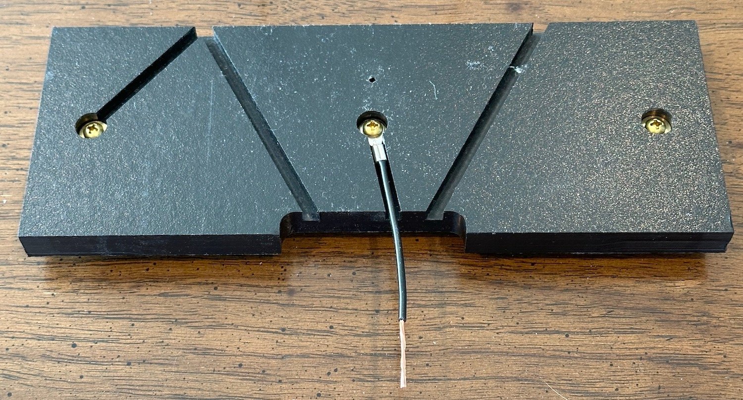

The coil box was removed and taken apart. The two end screws stood proud of the nut making the coil stick up a bit further than it needed to. The solder was removed and the whole thing reassembled. The end screws were leveled with a cutoff wheel. The whole coil box was reassembled and given a test on the bench with the meter. Pushing with the screwdriver no longer made any difference.
Just a note on this plastic coil box kit – the bottom was a full third thicker than the old wooden one. If the front was also too thick it might explain why those coils are such a tight fit. Overall, I am not impressed to the quality of this kit. It sure isn't like the Fun Projects one I installed in the '23 years ago.
Once installed in the car, the coil box was tested with the light bulb on all four positions and the all lit singaly & with all four coils installed. The car started and ran well with the switch in either MAG or BAT position. I was very happy with this and was ready to get back to the other work I started two months ago until I noticed the the freeze plug leaking rusty water right on top of the carbie.
I tested both the E-Timer that was my spare and the one that came with the car. Both ran fine, there was no issue with either. I will never know what caused the car not to start weeks ago. So many things were changed that the problem could have been anywhere.

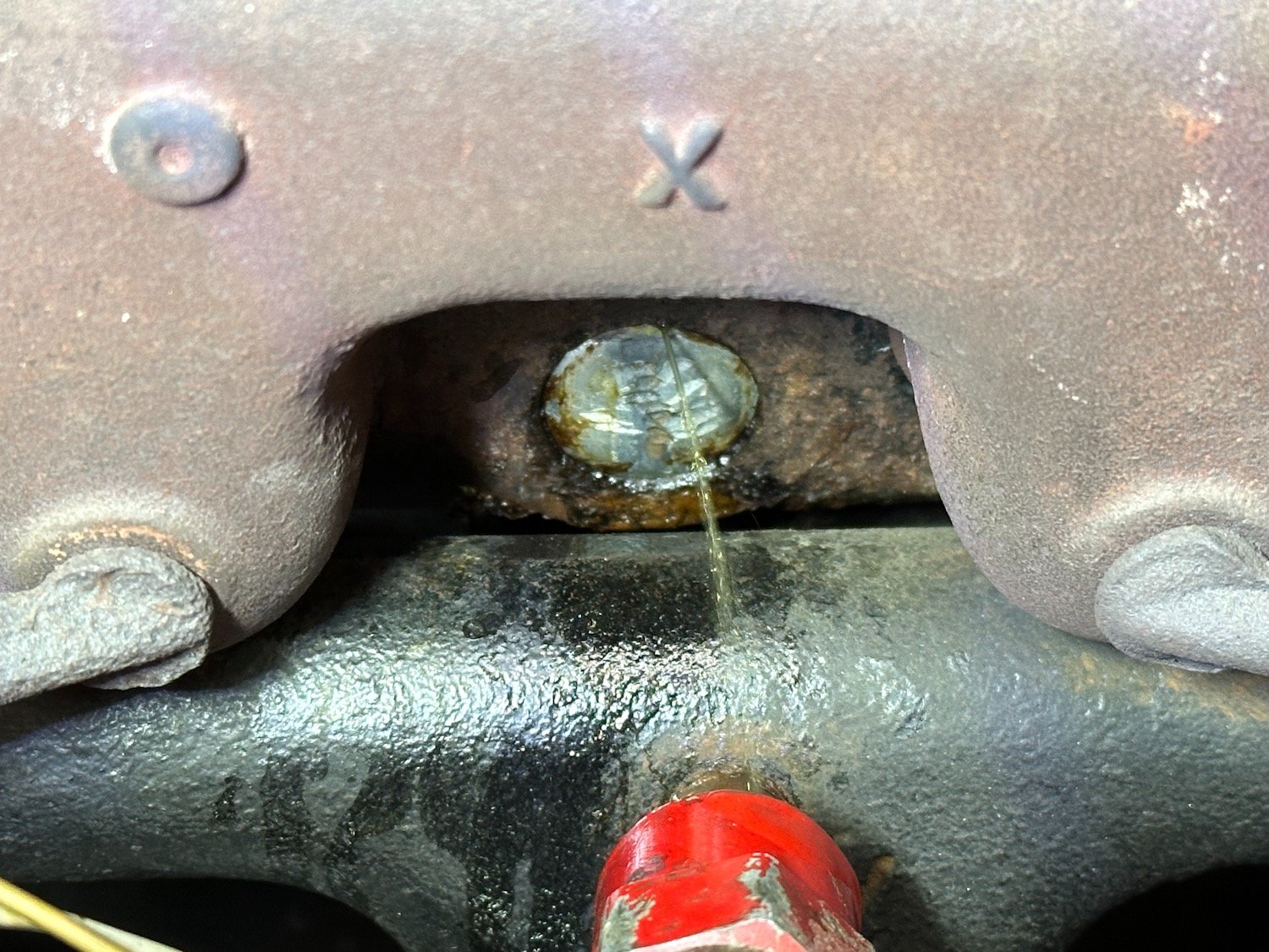

The manifolds came off and new freeze plugs were driven in but that is another story . . .
