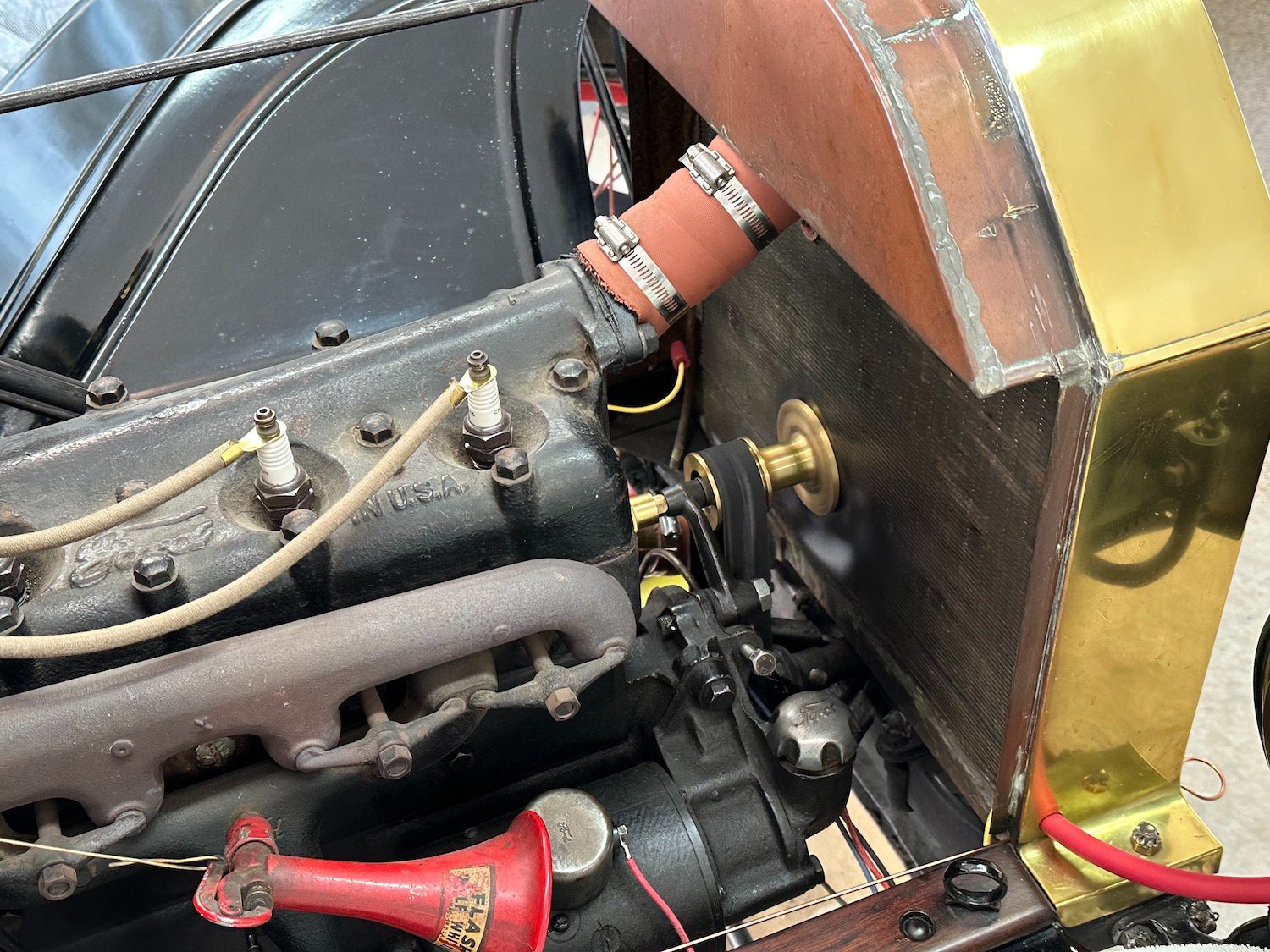

These pictures were taken with the engine roaring is wonderful 3 cylinder song.

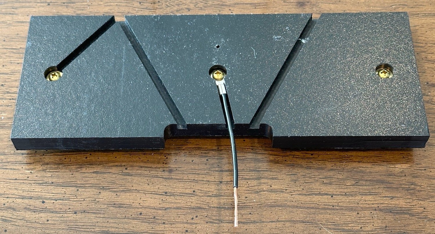

For those who did not follow the previous threads about this mystery, here are a few pics of the rebuilt coil box.

Those of you who suspected that the trouble lay in the coil box were correct. Even though I was being careful, I messed it up somehow. My suspect solder job (I don't do a solder joint every decade . . .) might have been at fault or possibly it was a plastic burr under the busbar that allowed a rocking motion.
My buddy from the Orange County Club spend better than an hour on the phone with me leading me through the troubleshooting procedures which isolated the trouble. A light was rigged so that with the system hot & the switch ON, a bulb from one of the low tension posts to a ground would light when a coil was in the same position as the light. Pulling the coils in and out revealed that the order of insertion mattered.
A screwdriver pushed down near the center solder joint would kill the light. A clue!
The coil box was removed and taken apart. The two end screws stood proud of the nut making the coil stick up a bit further than it needed to. The solder was removed and the whole thing reassembled. The end screws were leveled with a cutoff wheel. The whole coil box was reassembled and given a test on the bench with the meter. Pushing with the screwdriver no longer made any difference.
Just a note on this plastic coil box kit – the bottom was a full third thicker than the old wooden one. If the front was also too thick it might explain why those coils are such a tight fit. Overall, I am not impressed to the quality of this kit. It sure isn't like the Fun Projects one I installed in the '23 years ago.
Once installed in the car, the coil box was tested with the light bulb on all four positions and the all lit singaly & with all four coils installed. The car started and ran well with the switch in either MAG or BAT position. I was very happy with this and was ready to get back to the other work I started two months ago until I noticed the the freeze plug leaking rusty water right on top of the carbie.
