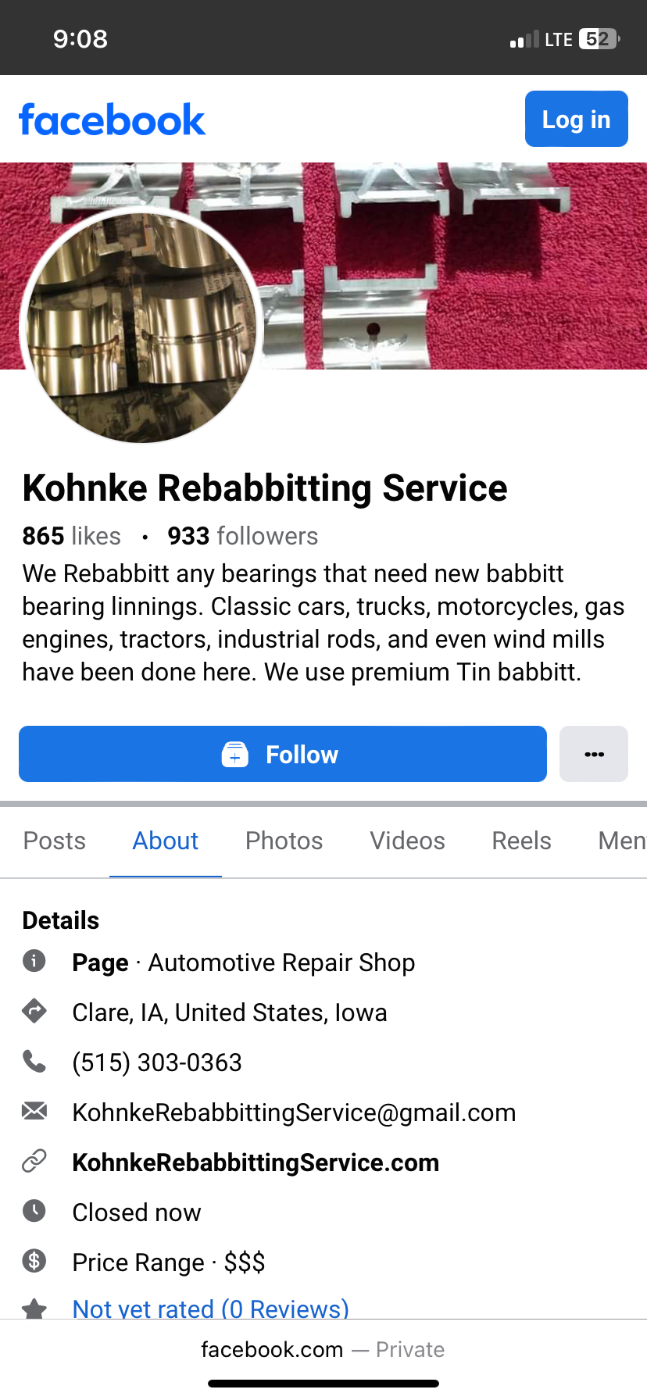

Does anyone know if Kohnke Rebabbitting is still in operation? I’m suspecting that I have a few bent rods in a newly done engine and would like to have them all checked. Herm had done excellent work for me in the past and I do know that his son was continuing the business after his passing, but haven’t had any luck reaching him. Also, who else is reputable for rod straightening nowadays?

Yes he in business and his name is John

Thanks guys. John sent me his cell number.

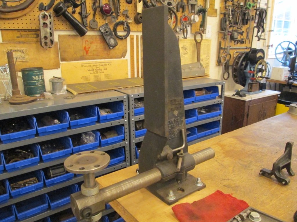

Stevens & KR Wilson both made superior tools for checking rods - I also have a flywheel attachment for setting magnet heights for my Stevens.

I took the idea from the Ford Service Manual !

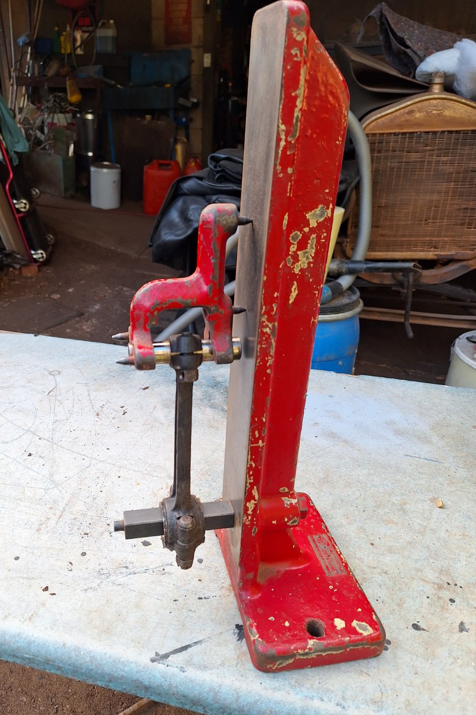

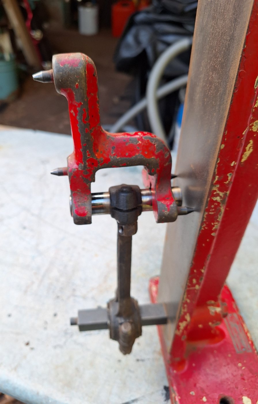

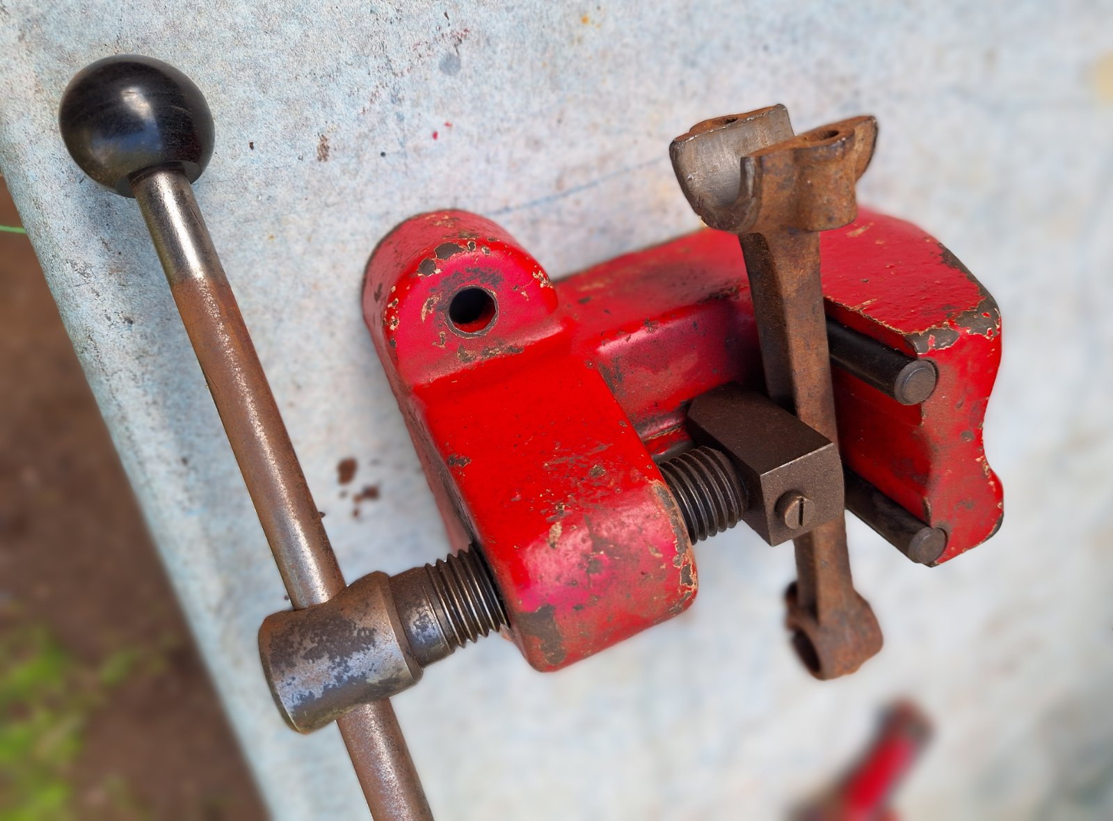

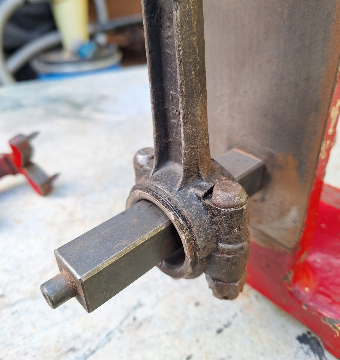

This is my Ausrtalian made set up for rod aligning.
Instead of multiple round mandrels to take multiple sized rods, it comes with just 3 machined square mandrels. These can take rods as small as T up to large diesel truck rods. My local machine shop never had a use for their small one, so it was given to me.
10 years later my cousin found the matching precision vice used to straighten rods.
