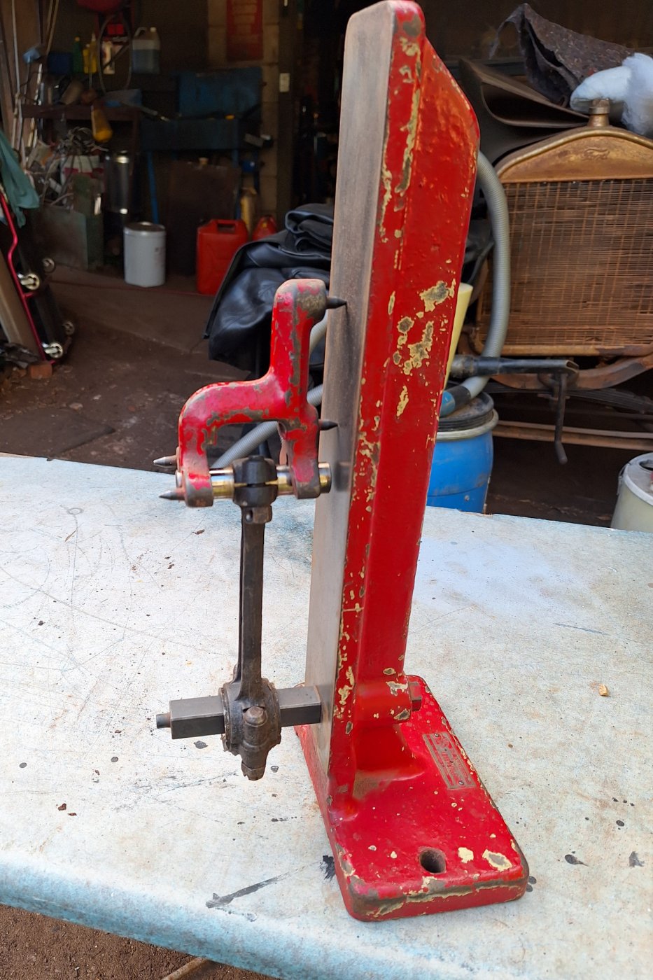

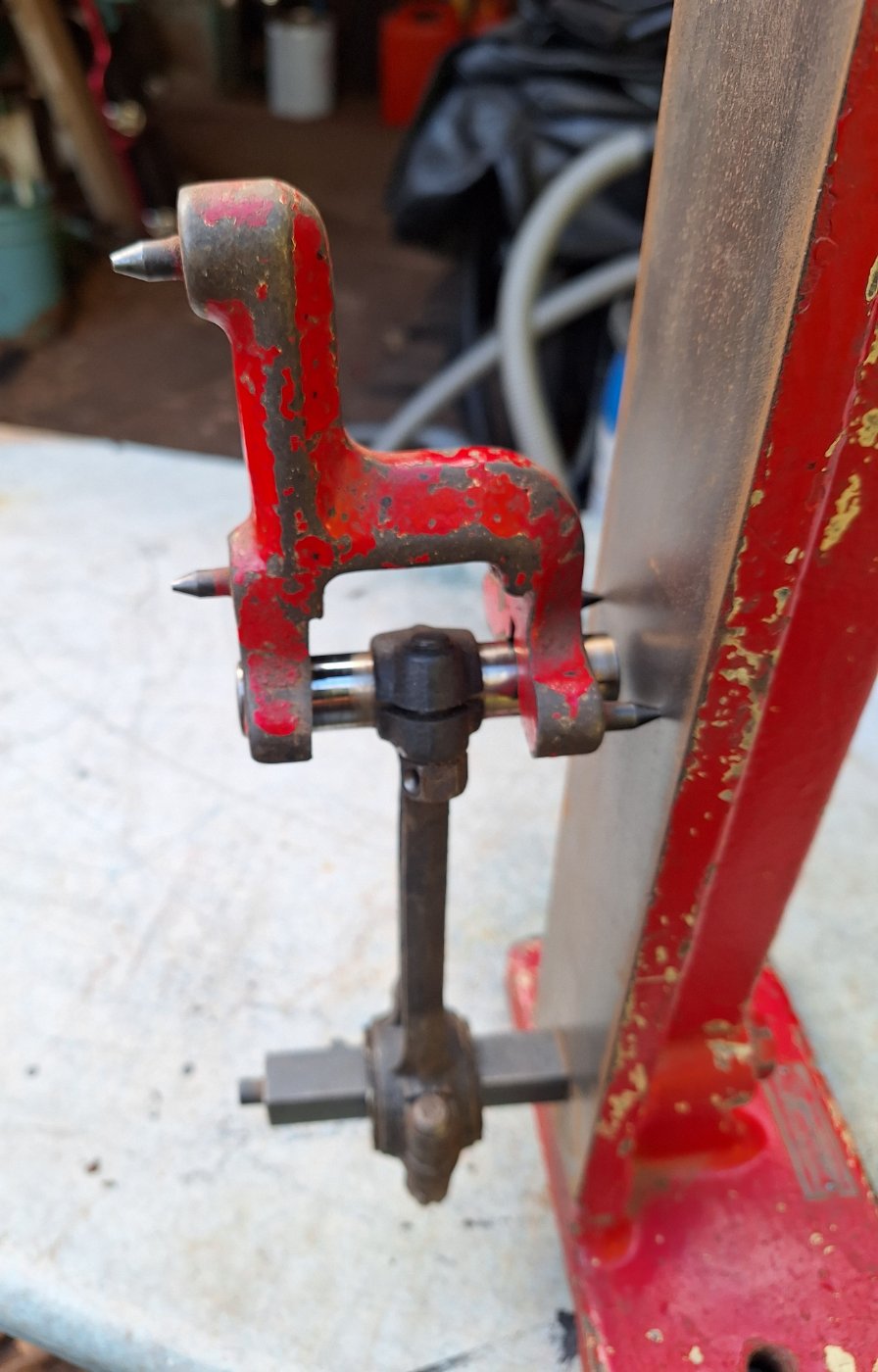

This is my Ausrtalian made set up for rod aligning.
Instead of multiple round mandrels to take multiple sized rods, it comes with just 3 machined square mandrels. These can take rods as small as T up to large diesel truck rods. My local machine shop never had a use for their small one, so it was given to me.
10 years later my cousin found the matching precision vice used to straighten rods.
Dave Young
Topic author - Posts: 245
- Joined: Sun Feb 24, 2019 9:37 pm
- First Name: David
- Last Name: Young
- * REQUIRED* Type and Year of Model Ts owned: 26 Touring, 26 RPU, 24 Coupe, 26 Speedster, 28 Chandler, 29 Chandler, 29 A
- Location: Mays Landing, Nj
Re: Bent Rods
I’d sure like to find one of these fixtures
- Posts: 5246
Re: Bent Rods
The fixtures show up @ swap meets occasionally but, the seals are rarely with them & a hard find.
Simple, functional substitutes can be made from about a 4" notched square plate.
