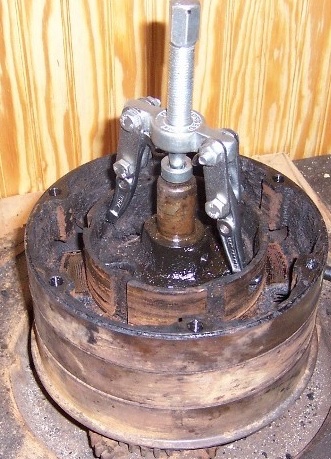

Used with success a heavy gear puller. Was snuggle but off it came.
- Posts: 5256
Re: Clutch Basket puller advice please
That looks like one of the HF 3 piece set.

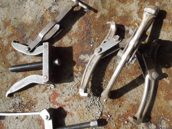

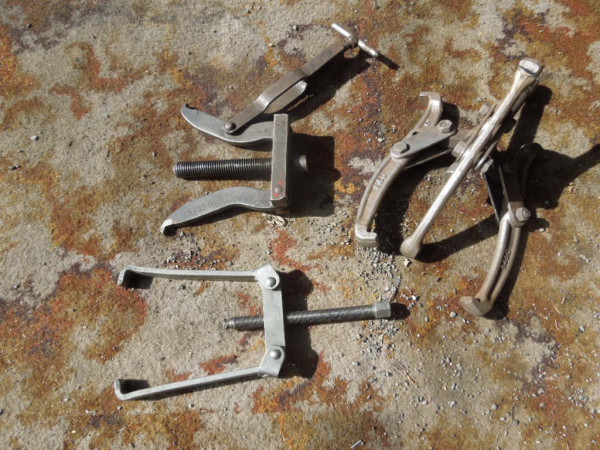

I do have a few pullers, top right is a 6".
I'm going to a swap meet this Saturday so any ideas on what to look out for would be great.

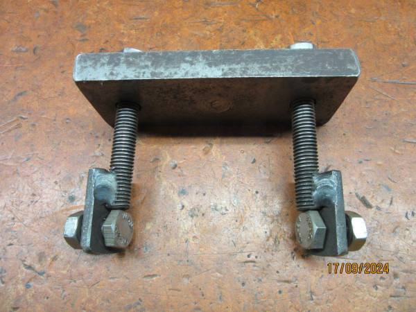

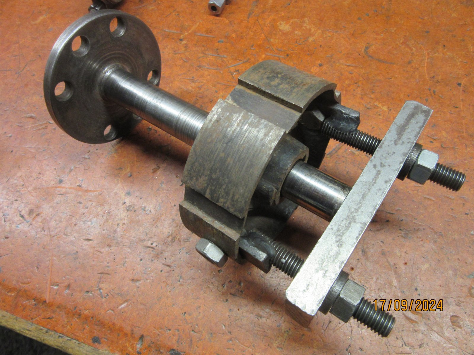

I use this puller , and works good .
Toon
Toon
- Posts: 7281
Mine's a bit like yours Toon. It has two hooks to engage in the clutch hub. The cross piece is a bit of heavy wall retangular hollow section, with a centre bolt to provide the "pull".

Toon - That looks a simple build, What's the distance between the 2 holes in the plate?
Ta
Ta
ABoer
- Posts: 237
- Joined: Mon Jan 07, 2019 2:41 pm
- First Name: Anthonie
- Last Name: Boer
- * REQUIRED* Type and Year of Model Ts owned: 1912 touring 1923 roadster 1925 pickup
- Location: Klaaswaal NL
Kevin W .
The plate is : 125 x 50 x 12 mm
The holes are 13 mm , and centre to centre 82 mm .
And the two small plates are : 40 x 25 x 6 mm with a 10 mm hole .
I hope this helps you .
Toon
Toon

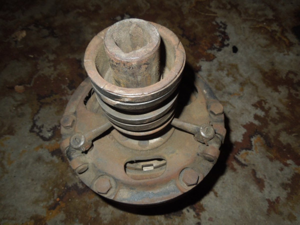

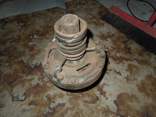

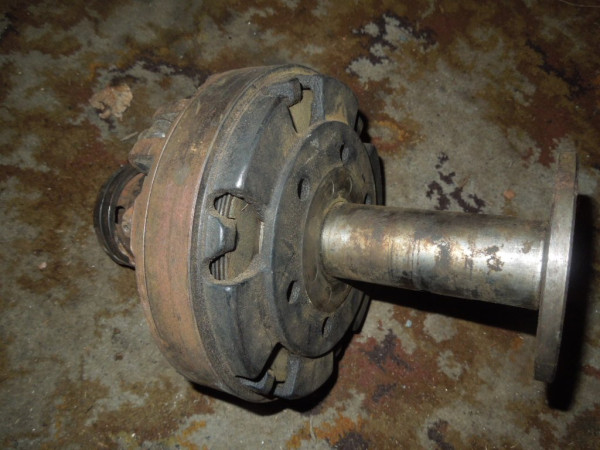

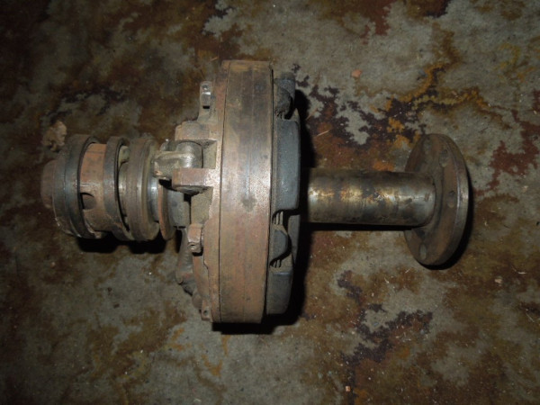

Couldn't find a suitable puller but I bought this today at a swap meet.
I'll pull it apart tomorrow and that might confirm if what I have on hand is suitable for the job.
What years is this set up from?
[attachment=0]DSCN5053.JPG[/attachment]
[attachment=1]DSCN5052.JPG[/attachment]
[attachment=2]DSCN5051.JPG[/attachment]
[attachment=3]DSCN5050.JPG[/attachment]
[attachment=4]DSCN5049.JPG[/attachment]
