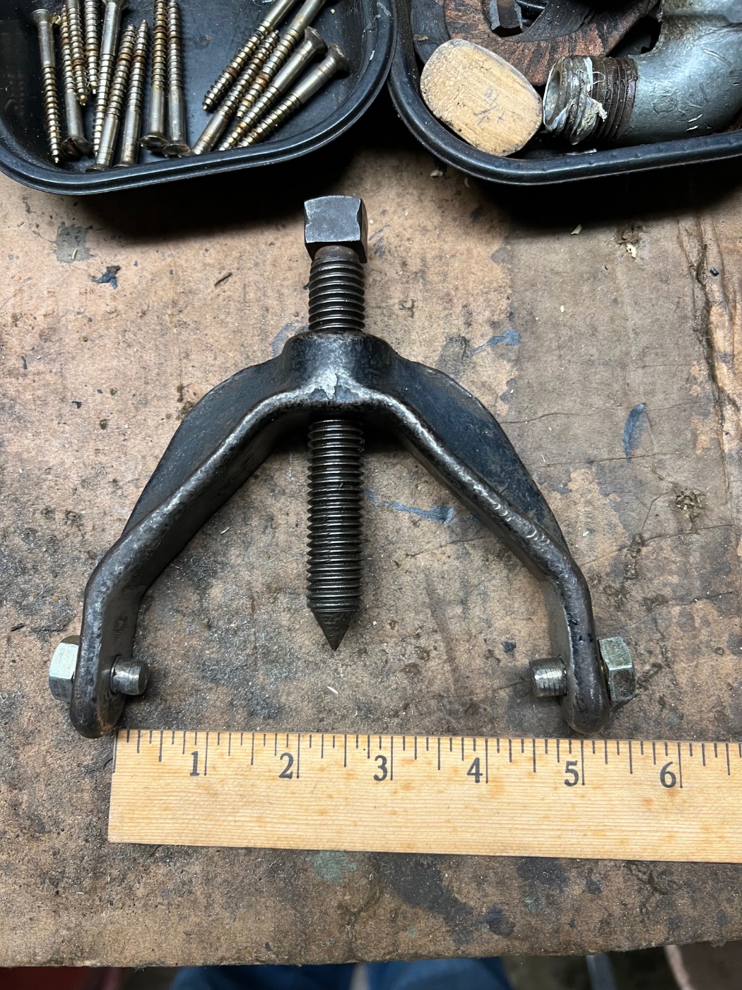

I do have a few pullers, top right is a 6".
I'm going to a swap meet this Saturday so any ideas on what to look out for would be great.
[attachment=1]DSCN5029.JPG[/attachment]
[attachment=0]DSCN5030.JPG[/attachment]

I’ve successfully used an original puller on a non-rusted transmission.
Here’s a 2017 post showing one Mr Jelf has used. http://mtfca.com/discus/messages/708324 ... 1485141493
