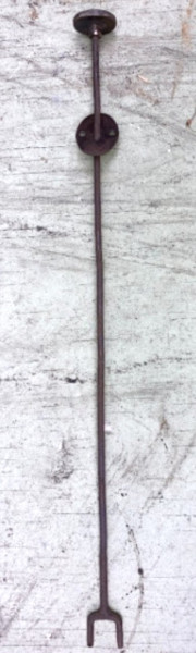

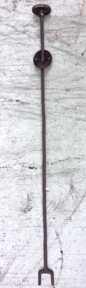

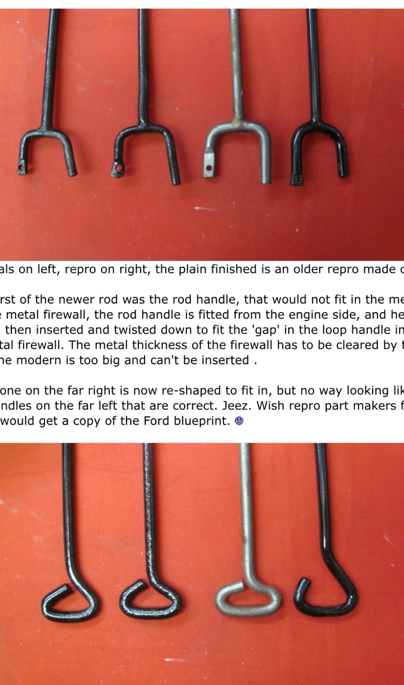

- Posts: 4048
Re: Carburetor Adjusting Rods
Rich P. Bingham wrote: ↑Thu Sep 19, 2024 11:40 amDuh !! Thanks, Steve, I didn’t even think of the forked mixture rod. Still, it would be great to see pictures of the different types, for us shut-ins to see !![]()
Here is the early style, forged fork, brass knob, later into 1916 has welded end fork.
Later adj rods all steel looped handle and welded fork. These pics show originals and reproductions, some repro have loop too large to slip into the metal dash slot, rather useless.

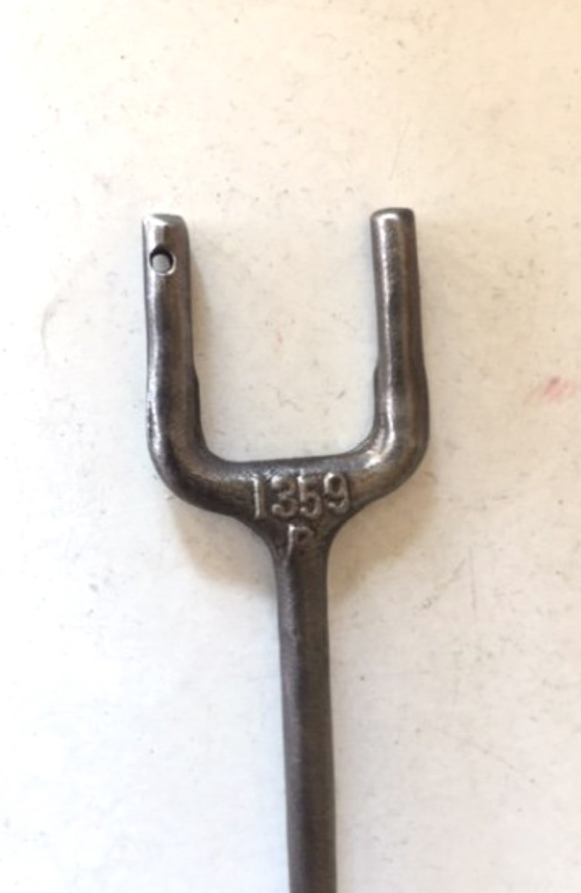

Topic author - Posts: 3913
- First Name: Larry
- Last Name: Smith
I don't think a picture would do much good. The weld is difficult to see, where the forged end is welded to the mixture rod. I would really like to see how Ford did this?
- First Name: Larry
- Last Name: Smith
Not all the forged ends had the number on the forged end. Some do, some don't.
- First Name: Larry
- Last Name: Smith
Not all the forged ends had the number on the forged end. Some do, some don't. As you can see in Dan's post, the weld is not visible.

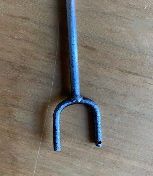

This is the rod that came with the Ghost, welded at the fork. Signs of wear, but not sure if it's original or an older repro.
The most recent post is on a 1915. The fork is welded on whereas the earlier one posted have the forged ends welded on about 1 3/4" up from the top of the fork. I noticed Ford supplied these rods in 1925 still, and says they fit 1909-25.
