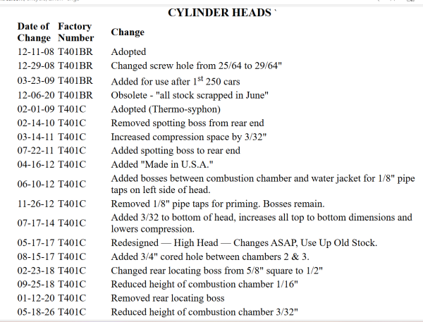

Post by Kerry » Fri Oct 25, 2024 4:12 pm
Might be a challenge to work out what head you are working with.

Post by Dan Hatch » Fri Oct 25, 2024 4:45 pm
If I read that chart correctly, 26/27 heads have a smaller compression chamber than earlier heads.
Therefore higher compression?
Didn’t the Tulsa club do a test on compression chambers size?

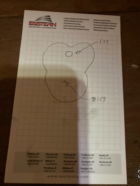

Post by RecklessKelly » Sat Oct 26, 2024 8:45 am
From a head removed from a 26, the center depth measures 1.19" and at a point next to the plug hole, 1.35".
RecklessKelly
Posts: 304
Last Name: Maxson
Location: Old Saybrook, CT
Re: Depth of head?
Post by RecklessKelly » Sat Oct 26, 2024 8:47 am
Stetch where measurements were taken with a vernier from a straight edge. No gasket.
