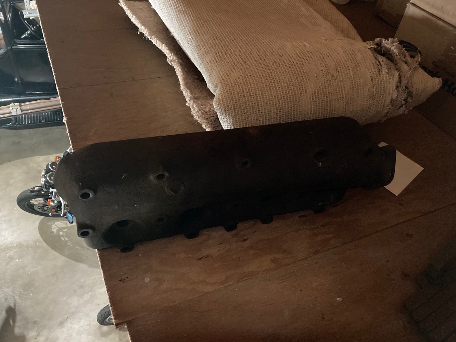

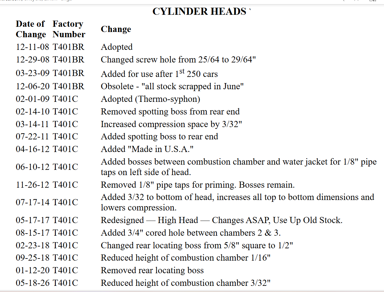

Might be a challenge to work out what head you are working with.

If I read that chart correctly, 26/27 heads have a smaller compression chamber than earlier heads.
Therefore higher compression?
Didn’t the Tulsa club do a test on compression chambers size?

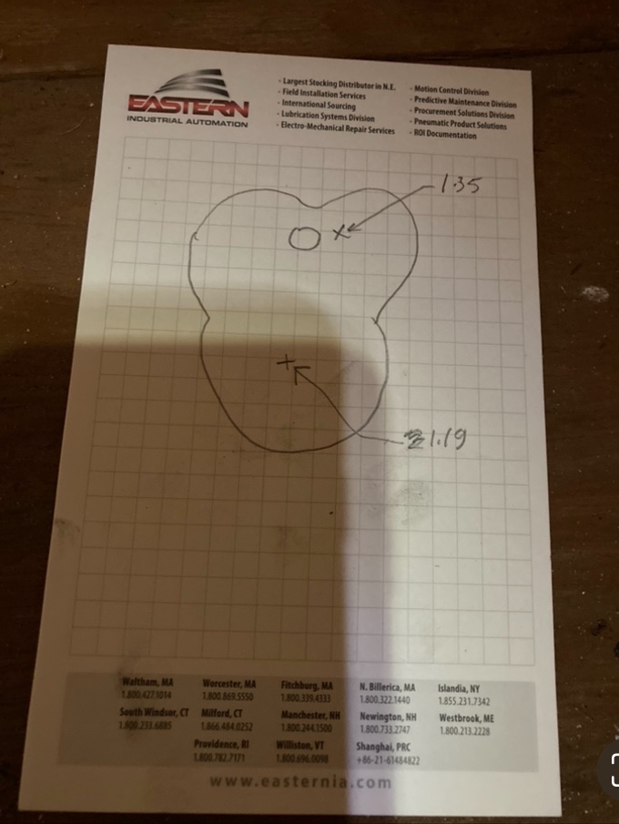

Re: Depth of head?
From a head removed from a 26, the center depth measures 1.19" and at a point next to the plug hole, 1.35".
RecklessKelly
- Posts: 303
- Joined: Sun Sep 01, 2024 8:57 pm
- Last Name: Maxson
- * REQUIRED* Type and Year of Model Ts owned: 1926 model t coupe
- Location: Old Saybrook, CT
Re: Depth of head?
Stetch where measurements were taken with a vernier from a straight edge. No gasket.
