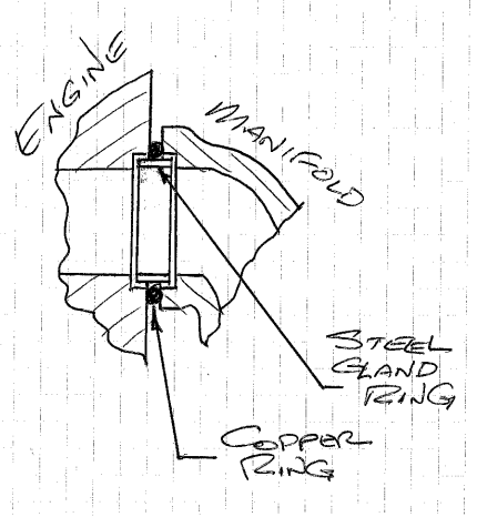

The copper rings don't go into anything. They go between the manifolds and the side face of the engine block. Steel gland rings go into both the manifold and the engine bock. The gland rings keep the manifolds aligned and also support the copper rings, (crush rings).

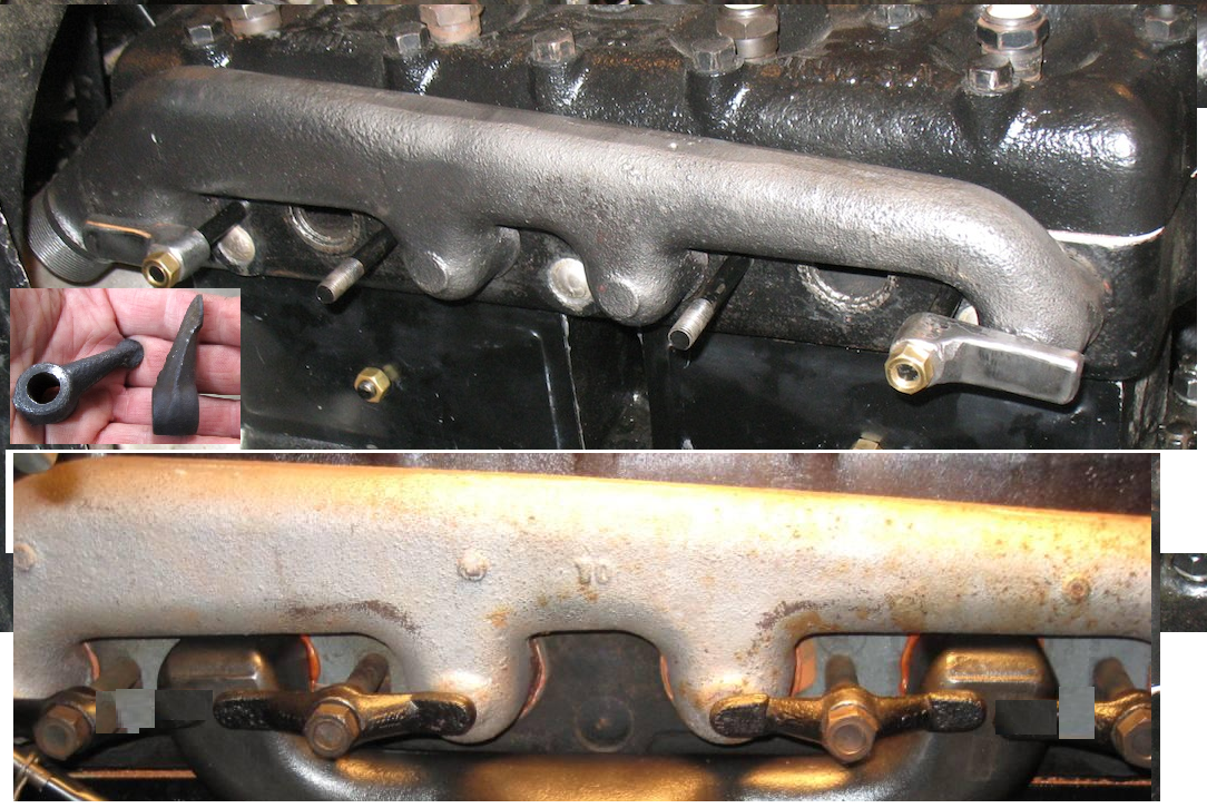

Didn't have pictures so I borrowed some from the internet & modified
Once you have the rings in place into the block with the copper rings around them - setting the exhaust & intake manifolds can be made easy by making a simple tool. Cut off one ear of each of to manifold clamps. Set the exhaust manifold in place and hold them there with the clamps in the outer positions. Then place the intake manifold in place and use the regular clamps in the inner positions to hold both manifolds. Replace the short clamps with the full ones. Done
Some use high temp seal to hold the gland rings & copper ring in place as well

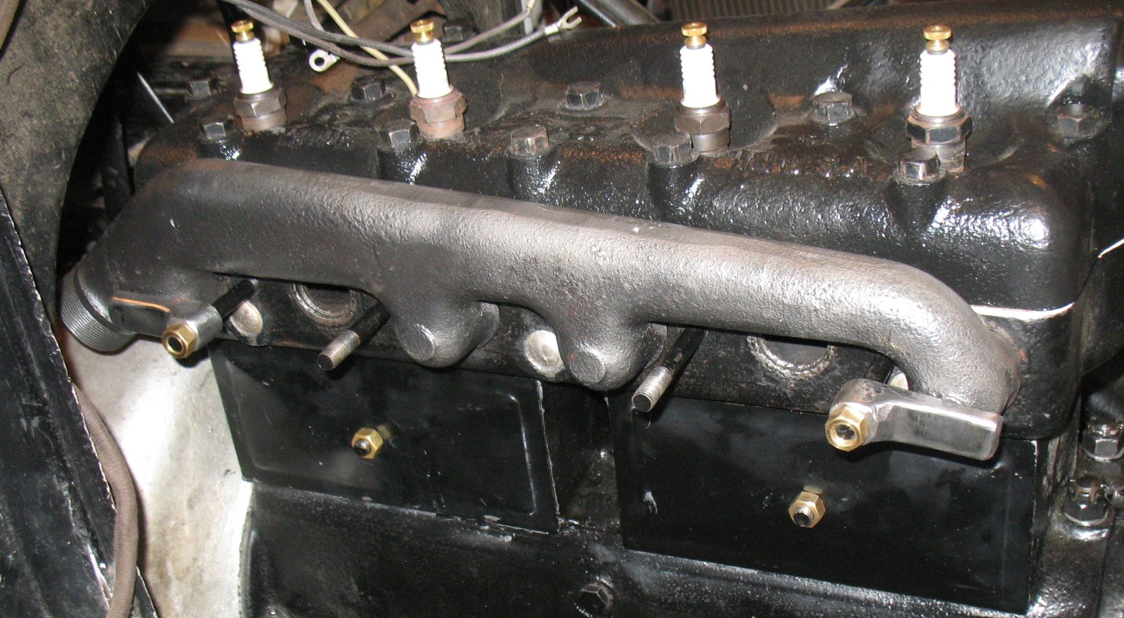

I made a pair of installation clamps because I dislike the idea of cutting up original parts.
If your exhaust manifold is warped, you can buy a new one, or...

Thanks guys, your descriptions and Jerry's drawing made the situation quite clear. If I had the parts on hand I could have seen at a glance how the assembly worked. This car had some very nice one piece gland/gaskets when I took it apart and so I ordered the same ones. They would not allow the manifold to fit even though it looked pretty straight. A new manifold proved just the same. The manifolds both acted like they were a 1/16 or so too long to fit. Both new & old manifolds fit fine with the old one piece gland/gaskets. URRRGH!!
