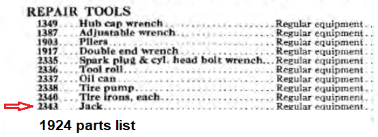

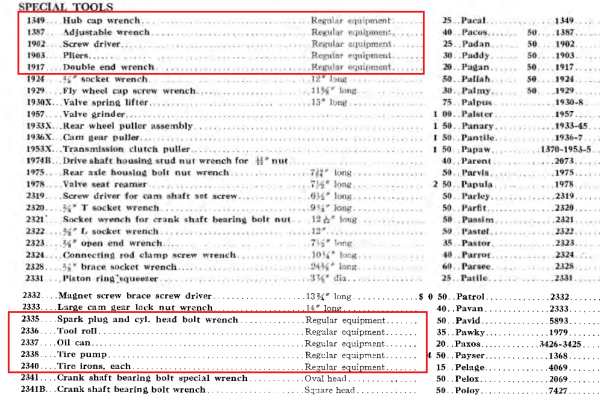

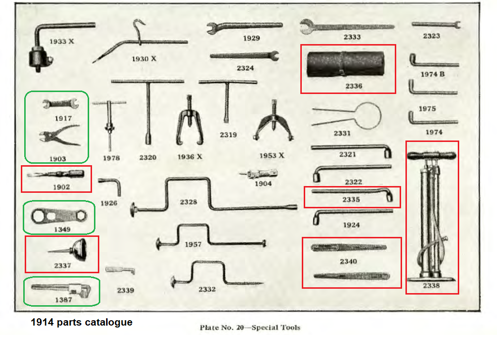

I checked Cimorella's Library and open the 1914 Parts list. I think its reasonable to assume that the parts identified as "regular equipment" were all part of the tool kit (tool roll) https://www.cimorelli.com/mtdl/1914/default.htm
I have many of the ones in green box for sale. All Ford Scripted. Note 1387 Adjustable Wrench does not have the square tip
Also in looking through various Part Lists by year, I didn't see a jack referenced until 1924, that's not to see there wasn't just that it wasn't listed as regular equipment (which doesn't make sense not to have one)

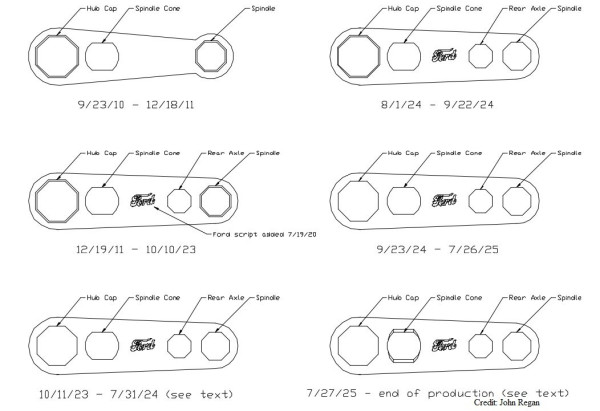

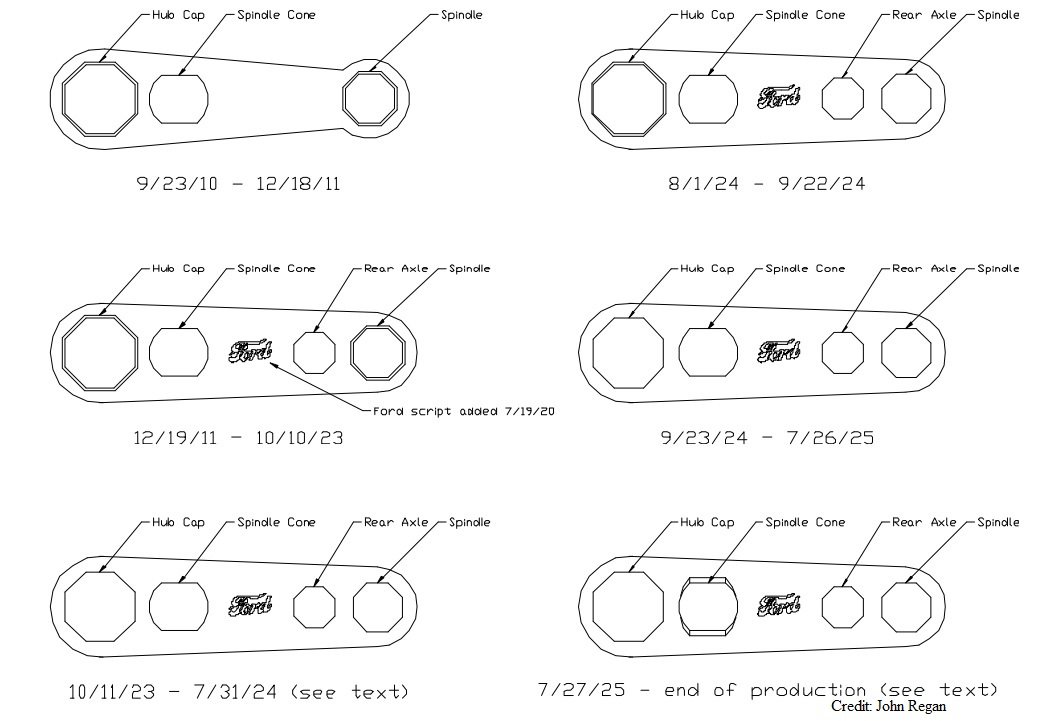

The drawings of the hubcap wrenches have octagonal holes for the front axle nut????

Allan wrote:
Tue Nov 05, 2024 5:06 pm
That is"artist license" by John Regan who made that chart of the styles of hub cap wrenches. :lol:
This is the '12-'23 style hub cap wrench, note the raised collars around the spindle nut and the hub cap.

Dan, I have an eye for these. I found two of the early three hole type on visit to Ford and More in Spokane. I had my wallet out on the counter to pay for them, and just happened to count the flats on the hubcap end. They were hexagonal!

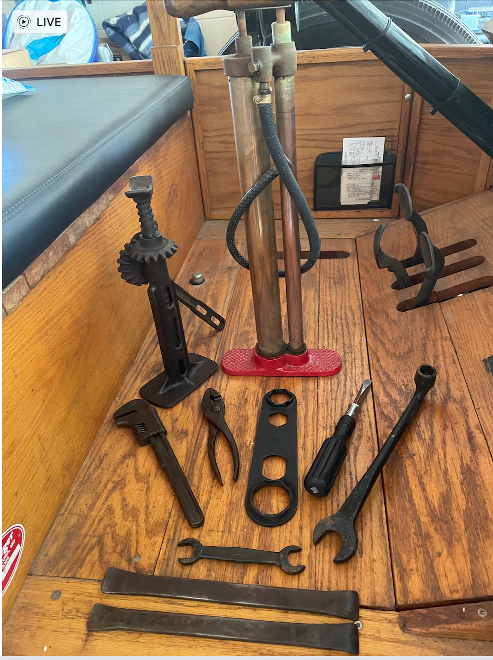

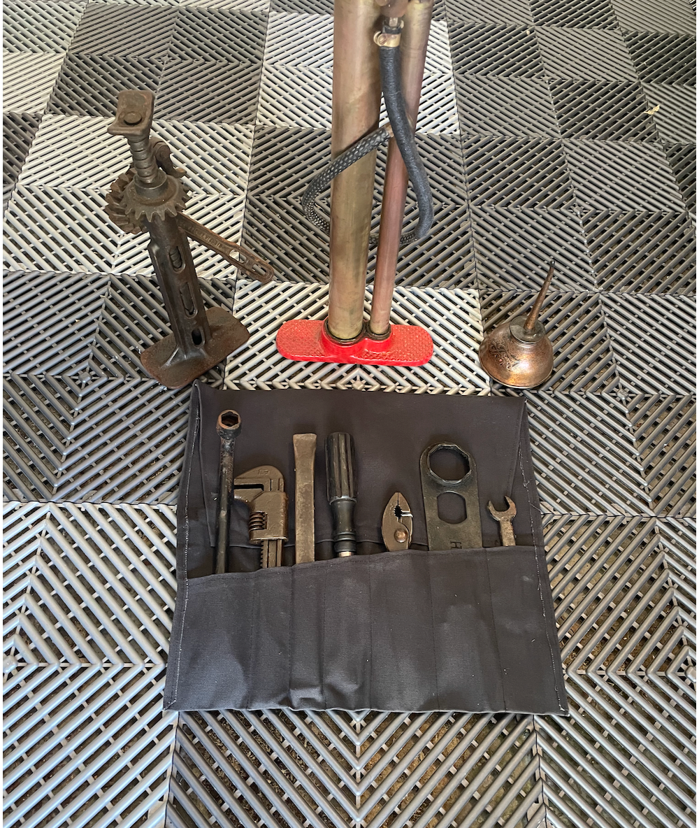

Here is a set that took me years to assemble for a representative 1915 set of tools.
Yes, the tire irons may not be correct...but at the same time this set was restored to be functional and roadside if needed. As a guy who held the land turtle record on changing a clincher tube that eventually became a near speed record...lol...I'll eventually get a set of the tapered forging irons, but they will stay in the box...lol.
I also have the T1923 tool shipping box...(actually a modern facsimile, with modern sisal nesting and a closure method that was 'normal' in the era.). Bruce list had said the box did start with the first 1909 and carried through at least for a decade or so. Some have held the dealers trashed the box at point of sale...my view is that the tools stayed in the box until the box fell apart. Who knows...but I've had fun. :lol: :lol: :lol:
