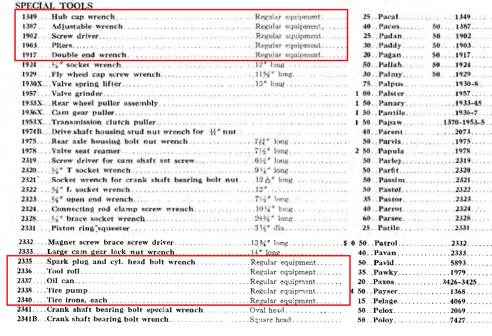

I checked Cimorella's Library and open the 1914 Parts list. I think its reasonable to assume that the parts identified as "regular equipment" were all part of the tool kit (tool roll) https://www.cimorelli.com/mtdl/1914/default.htmbdtutton wrote: ↑Tue Nov 05, 2024 2:23 pmHello,
Whenever I replace something on my early 1914 Touring car (Assembled October of 1913), I try to find parts matching the build date of the car. I was wondering where I could find a chart that shows the correct jack, correct air pump and correct tool set that came with the car. Any help would be appreciated.
Thank you....Bryan
I have many of the ones in green box for sale. All Ford Scripted. Note 1387 Adjustable Wrench does not have the square tip
Also in looking through various Part Lists by year, I didn't see a jack referenced until 1924, that's not to see there wasn't just that it wasn't listed as regular equipment (which doesn't make sense not to have one)

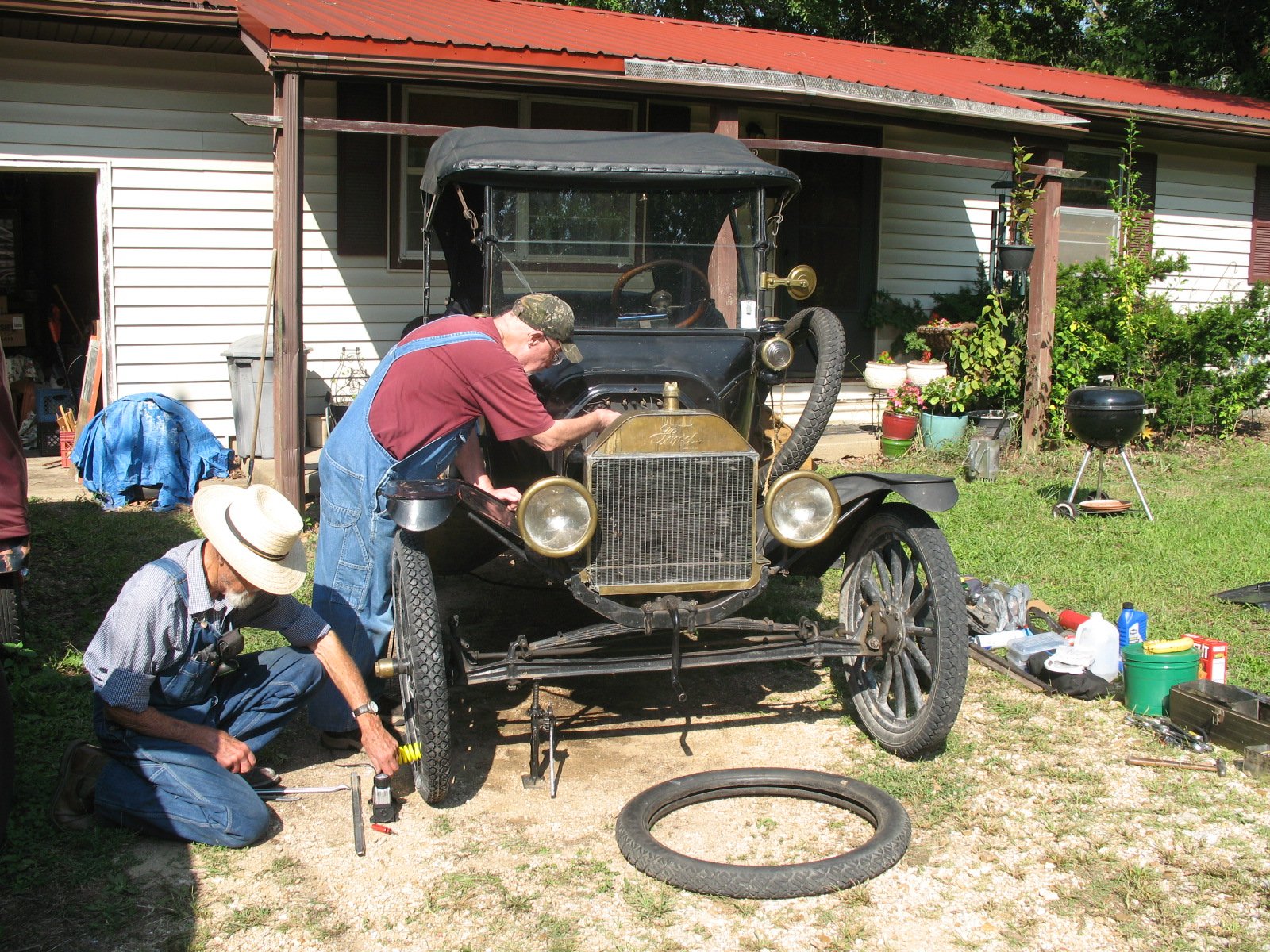

I haven't researched jacks enough to be sure when the common screw jack, as in my picture above, was introduced. But it came with every car during the years of peak production and is one of the most common Ford relics. It's the one I carry in my car. I've used it more times than I can remember, and always found it more than adequate. If you look for it online you'll find it for sale at shocking prices, sometimes hundreds of dollars. If I needed another one I would look for it at swap meets, where I've often seen it for bargain prices.

That's a very nice display. But those short little Ford tire irons should be for display only. They make changing a clincher tire the job from Hell. Mister Archimedes and I have discovered that a long lever is easier to work with than a short one. For tools that I actually use in the real world, I have found that some two-footers from Harbor Freight are ideal for changing clinchers, and that's what I take traveling.
I think George is dealing with loose ignition wiring while I install a new Wards tire. My tools are the Ford screw jack, HF irons on the ground, a valve wrench, and a 12 volt compressor. But some of those things are not original/authentic! Right. T.S.
