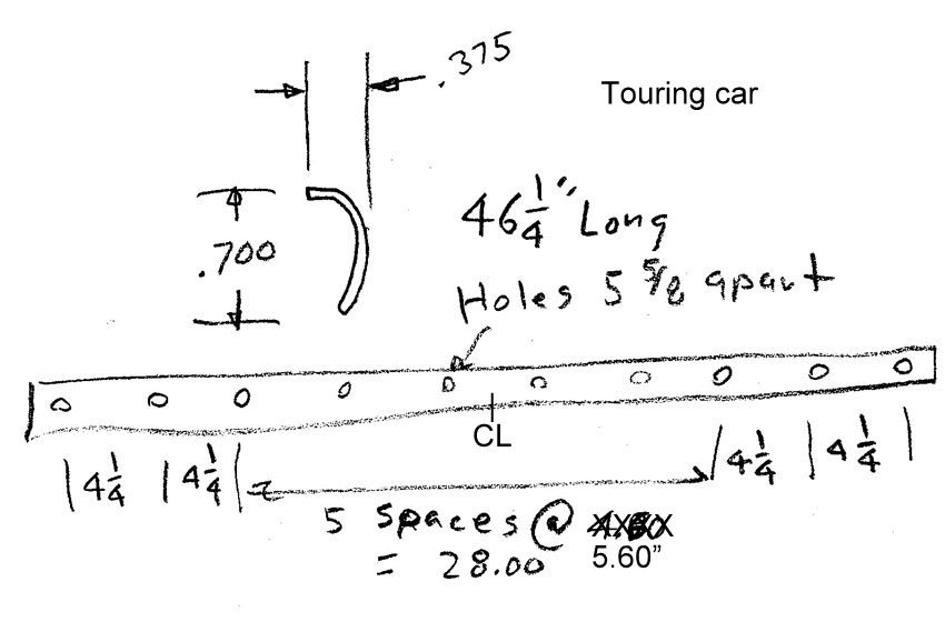

The 15 has a steel round that fastens the rear of the top to the body. Anybody have an idea as to where to source the material?

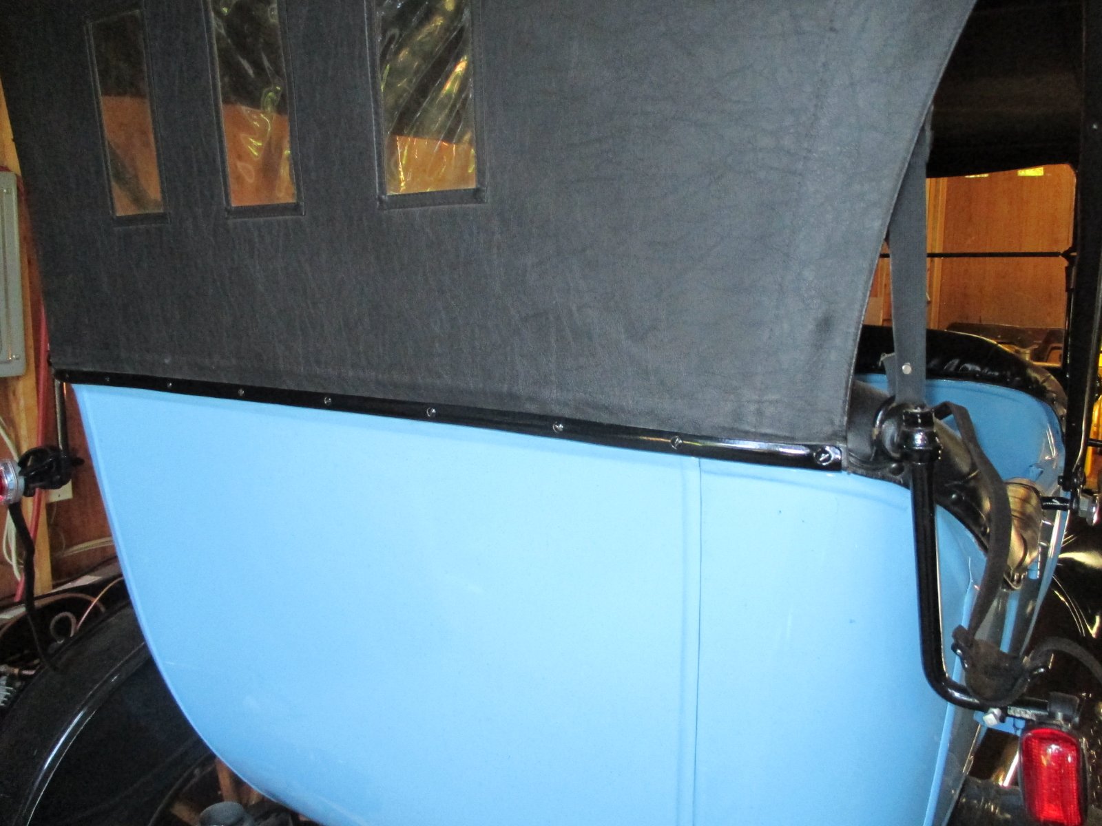

Is this what you are looking for?

See a possible product on this speedster site. https://www.facebook.com/groups/496619540483459. Scroll to James Starkey post.

Thank you Jsaylor. It looks like a likely solution

In the meantime, you could use a length of trim strip and upholstery nails. Hidem binding is a bit late to be using on an early car.
