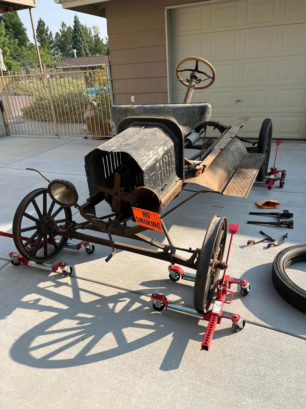

I have a brass era Model t chassis which I'm looking to purchase as a project car. Is this car the correct measurements for a coupelet? Im looking to build one using a model t chassis.

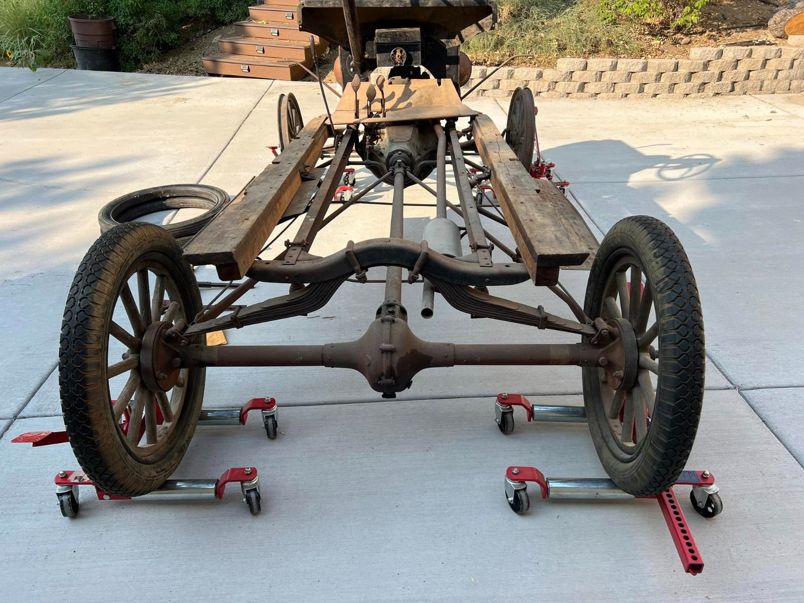

All chassis were of the same dimensions. The devil is in the details if you want to build a car of a certain year.

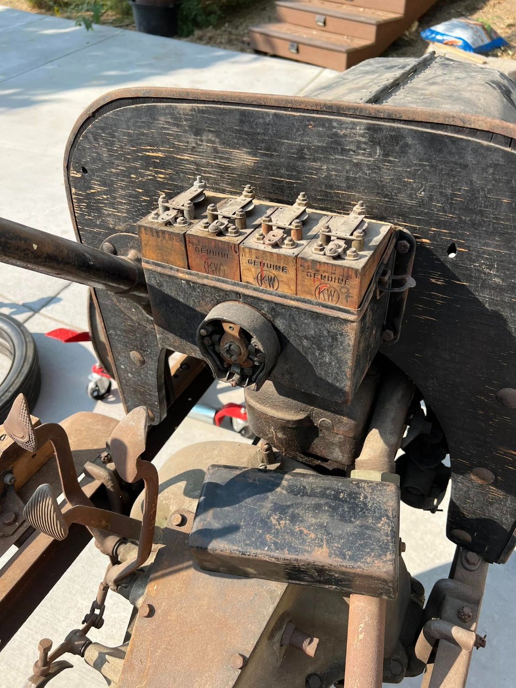

Apart from the brass hub fan with its bent arm and the aluminium trans cover with the lettered pedals, it looks to me to be about 1918. The bits mentioned are earlier.

Now I have seen the photos on a bigger screen, can I change my mind? I was put off by the square felloe non demountable wheels, typical of the 1918 cars we have from Canada. Perhaps these are later replacements on a 1915-16 chassis.

Dozens of details to be looked at for actual correctness, however in general it appears to be basically a 1915 or 1916 chassis.
If you are wanting to build a Couplet for those years? Unless you already have most of an original body? That is a rather ambitious project? Very little about the 1915 into early 1917 couplet body is like the later 1917 or 1918 couplets. And pieces from the 1919 to 1923 coupes are even further removed from anything even close to what was used on the earlier cars.
That chassis could be a great start for a fine late brass model T.

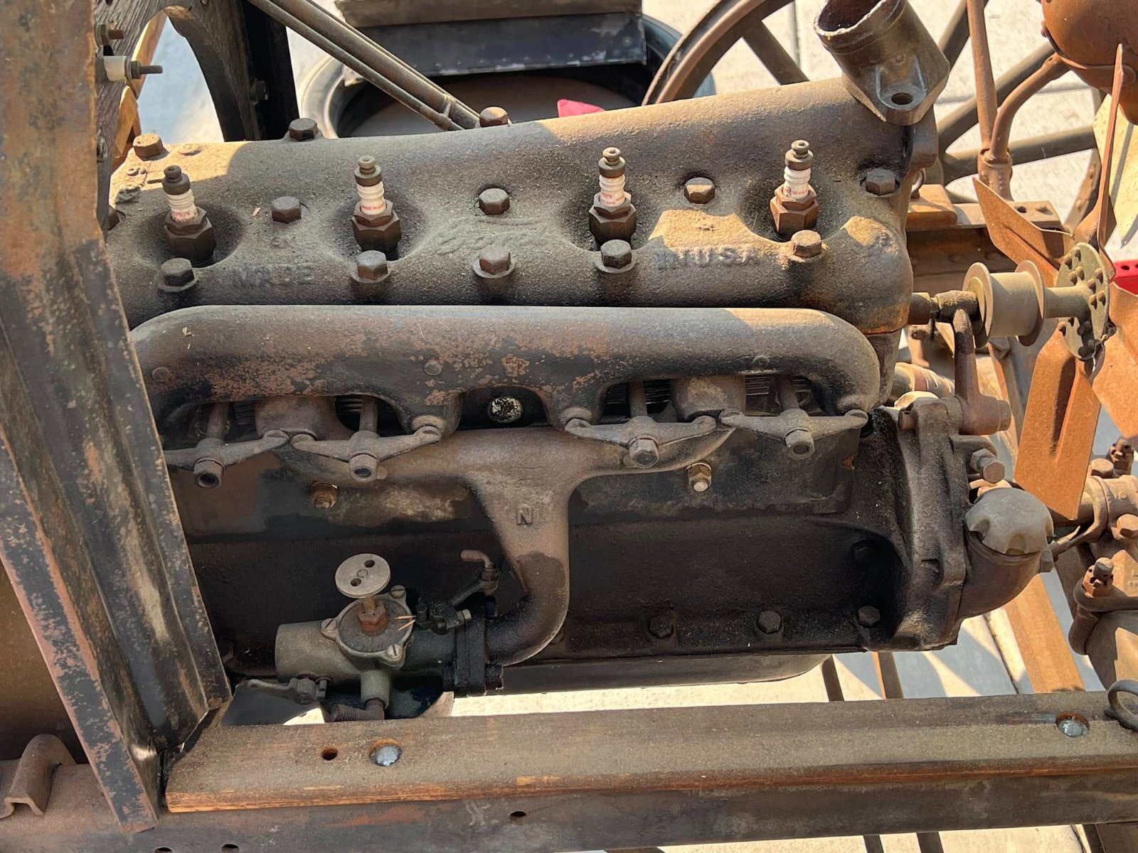

Yes, good building potential. Will the engine turn over and the engine serial number would be nice to know, but even without that, it looks like a good starting point for a project. If the price is right I would go for it.

If everything I see is working, then you could "drive" it within one day.
In some ways there's a lot more there than what I started with.
I hope this is a family project because it's going to take time.

Does that sign imply that it doesnt burn oil? Do you have the couplet body or are you just in love with the style? If you like speedsters, there is a speedster body posted in the for sale section.

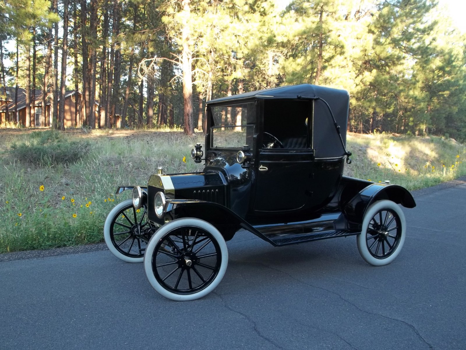

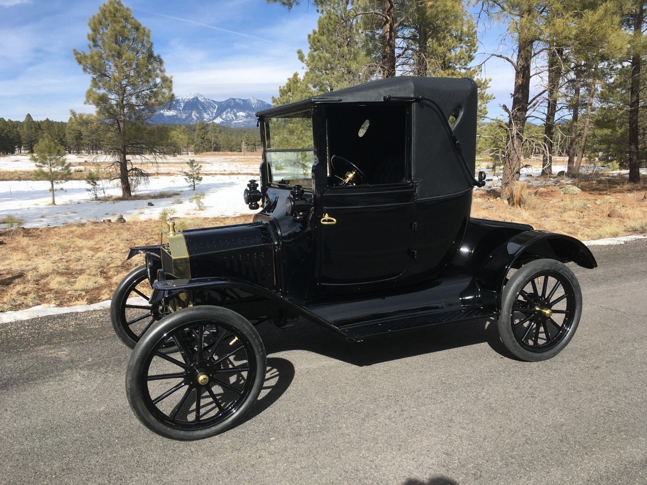

Ford made the Coupelet from 1915-1917. The 1915-1916 had a brass radiator, but both are quite unique. The chassis you have would work for a Coupelet restoration, as all chassis were the same regardless of the body style. Here are a couple of photos of my 1915 and my 1916 Coupelets. I hope this helps, RussFurstnow

In case you do not know, Russ F is the hobby's top model T couplet expert! (And a fine human being!)
The 1915 T couplet is also one of my favorite of all model T factory offerings. They are rare, and have many unique to them parts. Some very good friends had one many years ago, but it was sadly destroyed in a garage fire.
At some time in the past, I considered trying to put one together, but instead, am happy having my 1915 runabout (also cute as a button!).
