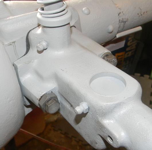

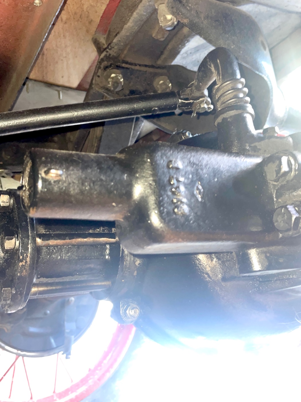

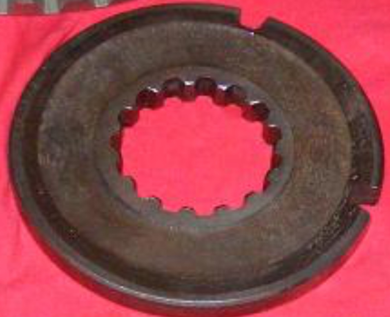

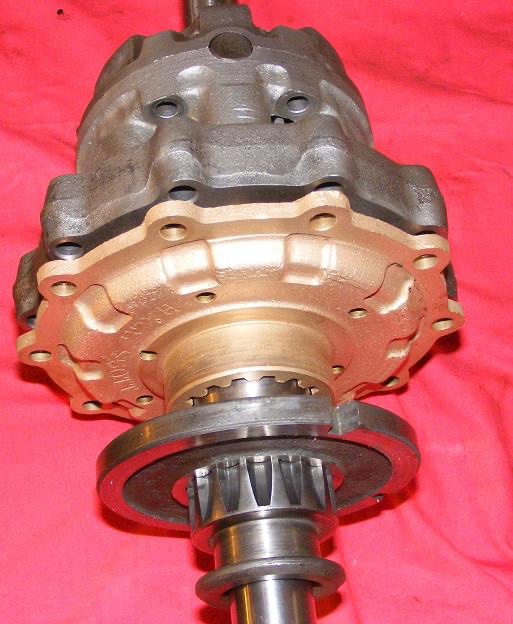

Dan you have 2 bolts that locate the brass gear locking notch plate P147, one bolt will have a lock nut on it the other does not. Those must fit into the notches when reassembled or you’re not going to be able to use the Ruckstell. Fairly easy to put back in place once done. Stan Howe would add some grease zerks to long snout shift lock to lubricant his Ruckstell rebuilds. Right before Christmas I rebuilt one of his Ruckstells by adding a 3/1 crown gear & pinion set up with the long snout shift lock.

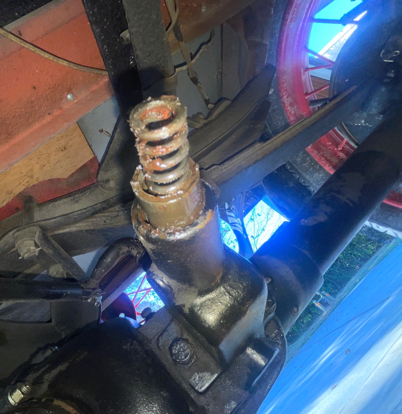

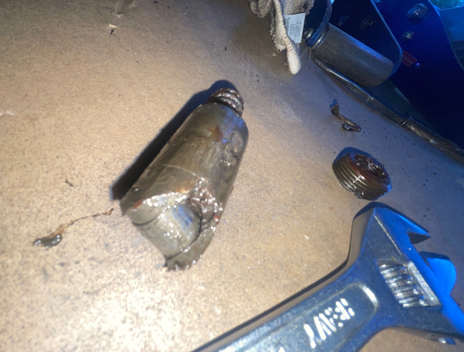

The plunger screw can be removed & pull the spring & plunger. Grease can be packed in without removing the shift lock body. Lube the plunger well. that's the piece that gets dry, wears & gets stiff. A drop of oil on the shift lever shaft & felt washer also.

I took out the cotter pin on the plug at the end of the tube and removed the spring, then packed the tube with grease and re-installed the plug at the end. The adjustment in or out of plug at the end of the spring will change the tension on the spring. You want it tight enough to keep the lever in place but not so tight it makes it hard to shift. When you get it right, install the cotter pin to hold in place.

Thanks guys. I’ll do the cotter pin out and unscrew the plug, spring, and plunger. Clean and re-grease and replace the parts. Easier way than off with the whole assembly.

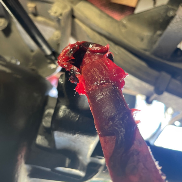

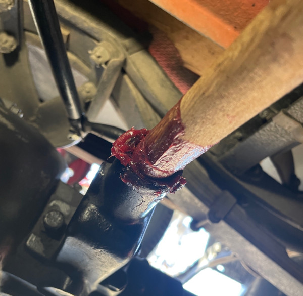

Followed advice and can report the Ruckstell shifts just fine now, as lube was helpful.
Rather easy, removed the spring and plunger and packed the nose and housing. There was some residue of old grease, but not much.
Buttered the nose full with a tongue depressor, and then a wooden dowel push stick deep into the housing to be sure of a good pack of dope in there too ;) More added when inserting the plunger and spring.
