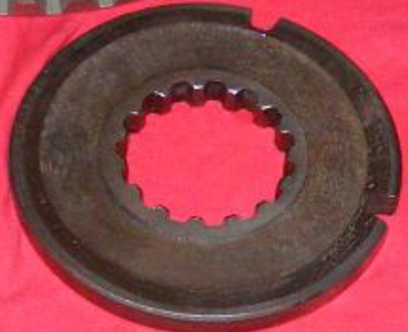

Dan you have 2 bolts that locate the brass gear locking notch plate P147, one bolt will have a lock nut on it the other does not. Those must fit into the notches when reassembled or you’re not going to be able to use the Ruckstell. Fairly easy to put back in place once done. Stan Howe would add some grease zerks to long snout shift lock to lubricant his Ruckstell rebuilds. Right before Christmas I rebuilt one of his Ruckstells by adding a 3/1 crown gear & pinion set up with the long snout shift lock.

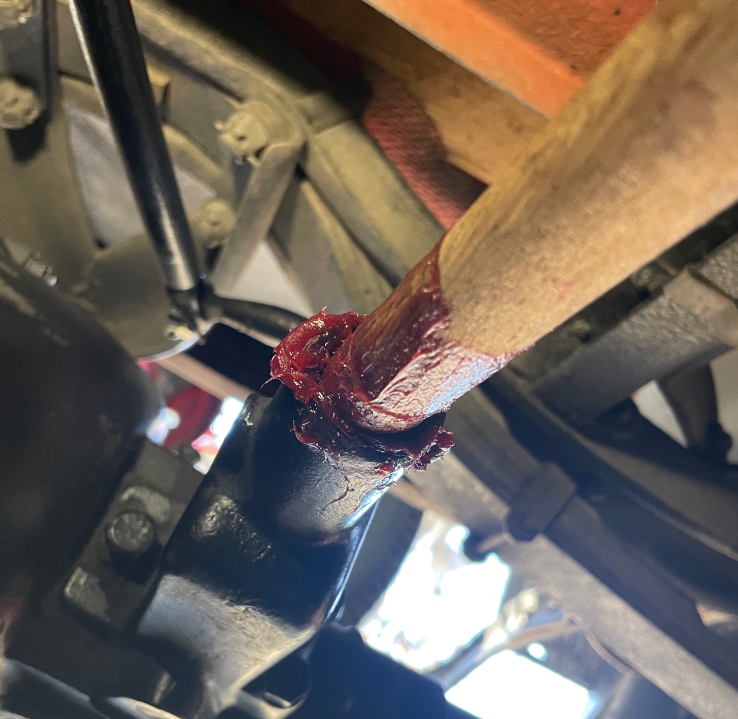

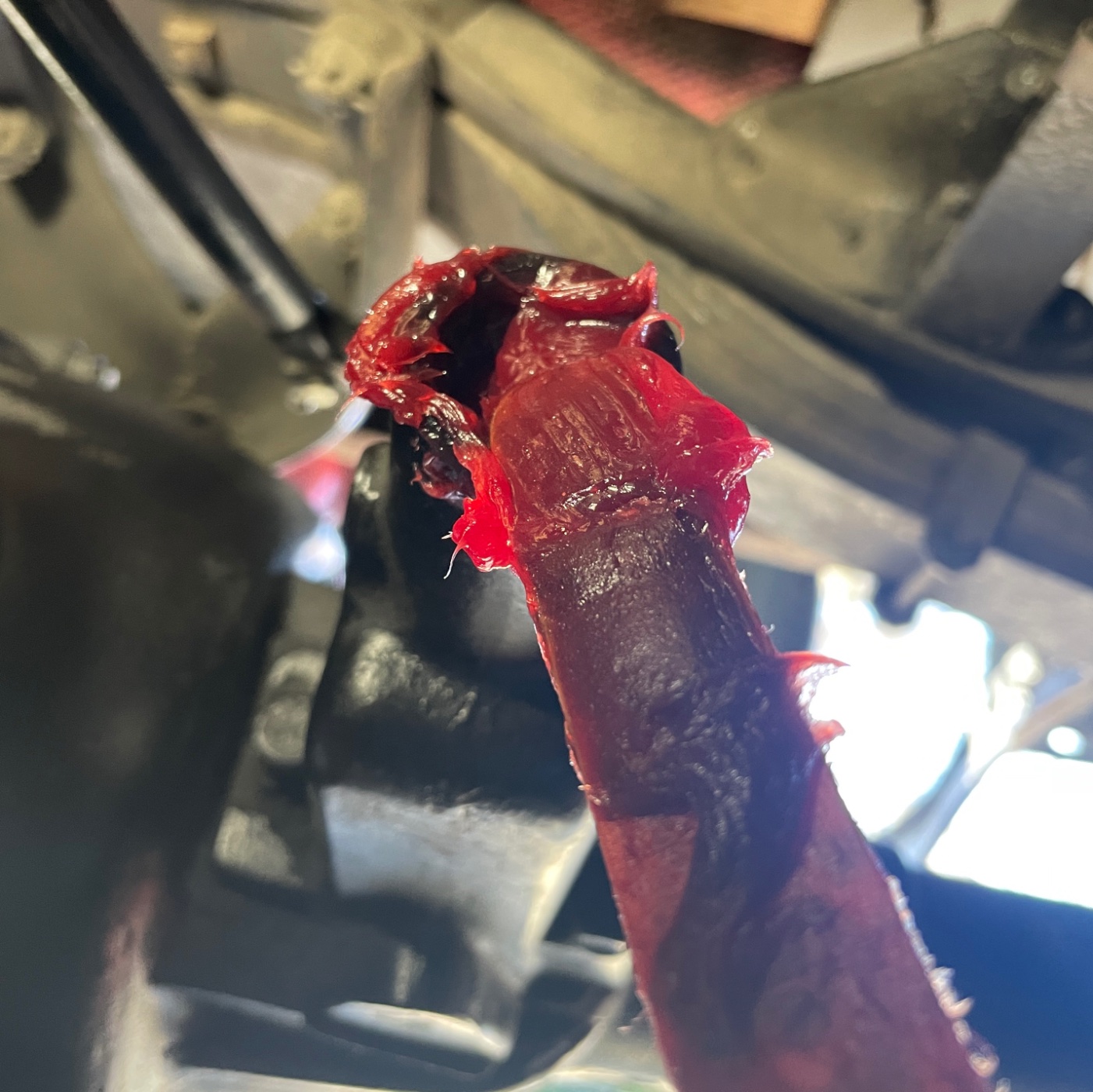

Rather easy, removed the spring and plunger and packed the nose and housing. There was some residue of old grease, but not much.
Buttered the nose full with a tongue depressor, and then a wooden dowel push stick deep into the housing to be sure of a good pack of dope in there too
More added when inserting the plunger and spring.
