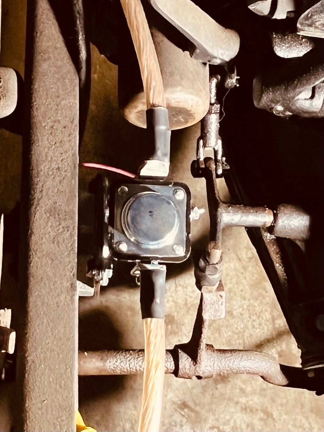

Post by browning » Wed Jan 01, 2025 12:35 pm
I did the ‘19 yesterday. It took about half an hour to install. Here is a top view.

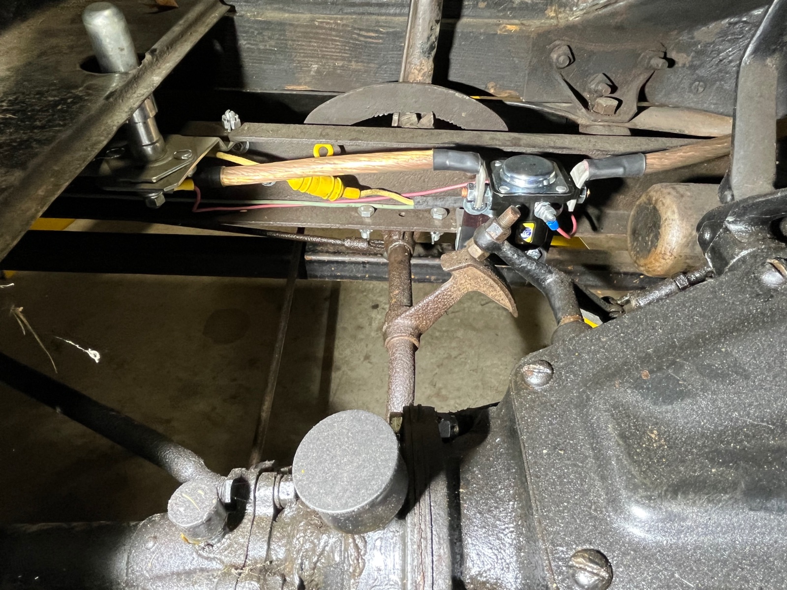

Post by browning » Wed Jan 01, 2025 12:38 pm
One from the side.

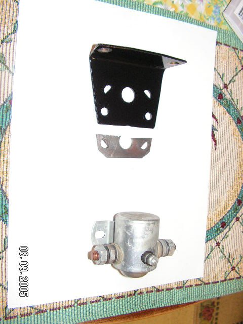

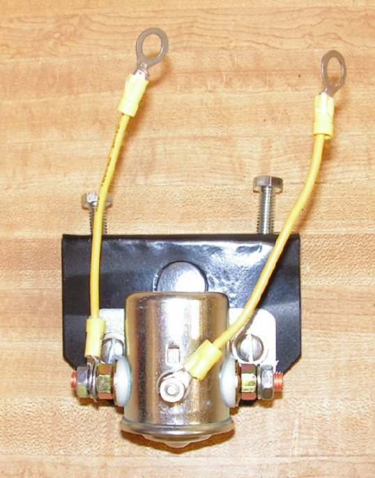

I made those kits about 10 tears ago and often took the old switch plate and bent it dow to hold the solenoid.
Electric covers make a good substitute.
