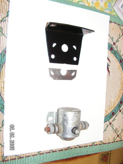

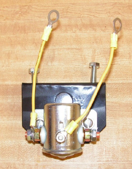

I took advantage of the Christmas time off to play with my '26 touring. The foot starter switch was to the point that it had to be engaged squarely and carefully and still wasn't making great contact. It was either time to replace it or attempt a repair. I decided to add a 6 volt solenoid but didn't necessarily want to modify the car or the wiring. I located an appropriate solenoid and mounted it to the bottom flange of the frame just ahead of the brake quadrant with electrical hangers for bar joist that clamp over the flange and an adapter to elevate the solenoid to the right height. I then took the 2/0 cable that goes from the starter switch to the starter and cut it so that when 90 degree terminals were added, it lined up with the solenoid terminals. I mounted that cable to the same starter switch terminal that comes from the battery. I wired the trigger terminal of the solenoid to the remaining starter switch terminal and was done. The installation was simple and invisible and works very well. The cost was somewhat less than 75.00 and a bit of labor. It would be very easy to wire a remote starter button if desired and the installation can be reversed in minutes with no harm done. I am going to do my '19 roadster the same way and could take some pics as I progress if there is any interest.

I am contemplating making a kit. I think it can be sold for under a hundred dollars for solenoid, cables, mounting bracket, trigger wire, and clamps. Do you think it is worth pursuing?

I have decided to make up ten kits just to get a firm number on material and labor. They would include the 2/0 cables, solenoid, mounting bracket, trigger wire, clamps and bolts to mount. That would be all that would be required to complete an installation that used the foot switch to energize the solenoid. If you desired to use a remote push button switch on the dash or wherever it would require the switch and wire to complete. I don't want to sell on the general discussion forum so you can pm me through the club website for details. Cost of materials looks to be $55.00 and I would need to add the shipping to that. Less than an hour to install with no modification to the car and easy return to stock if desired.
