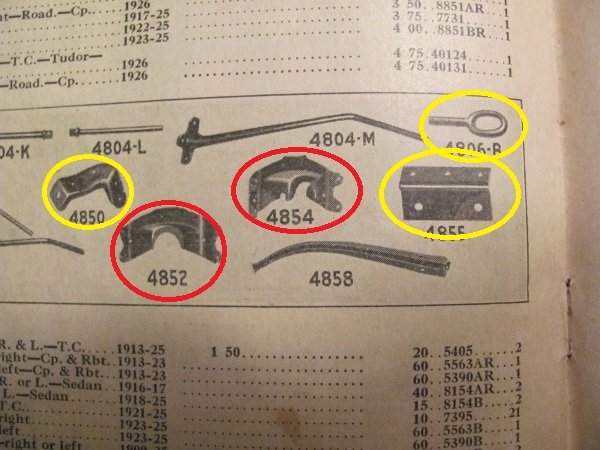

no repro's except for brass-erabrowning wrote: ↑Thu Jan 23, 2025 4:32 pmI am considering replacing the fenders etc. on my 1919 Roadster with new and hate to strip the mounting hardware from the existing parts since they are in pretty good shape (no rust) and could be used by others if unmolested. Is there a place where replacement mounting hardware can be purchased, new or used. I don't think I have ever seen it advertised.
eBay, forum, Facebook for parts or used trash fenders
Could find someone to trade
Red circled hard to find
Yellow circled much easier

- 740492.jpg (84.02 KiB) Viewed 3623 times

You might call Lang’s. They have a supply of good and NOS T parts. The top fender brackets are the same for L and R. But the corner brackets aren’t. They have to be L or R.

The top fender brackets with which I am familiar are left and right. The mounting holes in the fenders may be the same pattern, but one of the brackets would need to be rotated to align with the holes, putting the mounting slot either in front or behind the frame iron.
