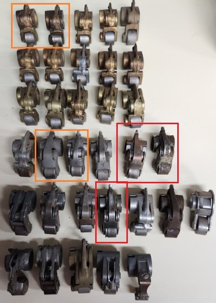

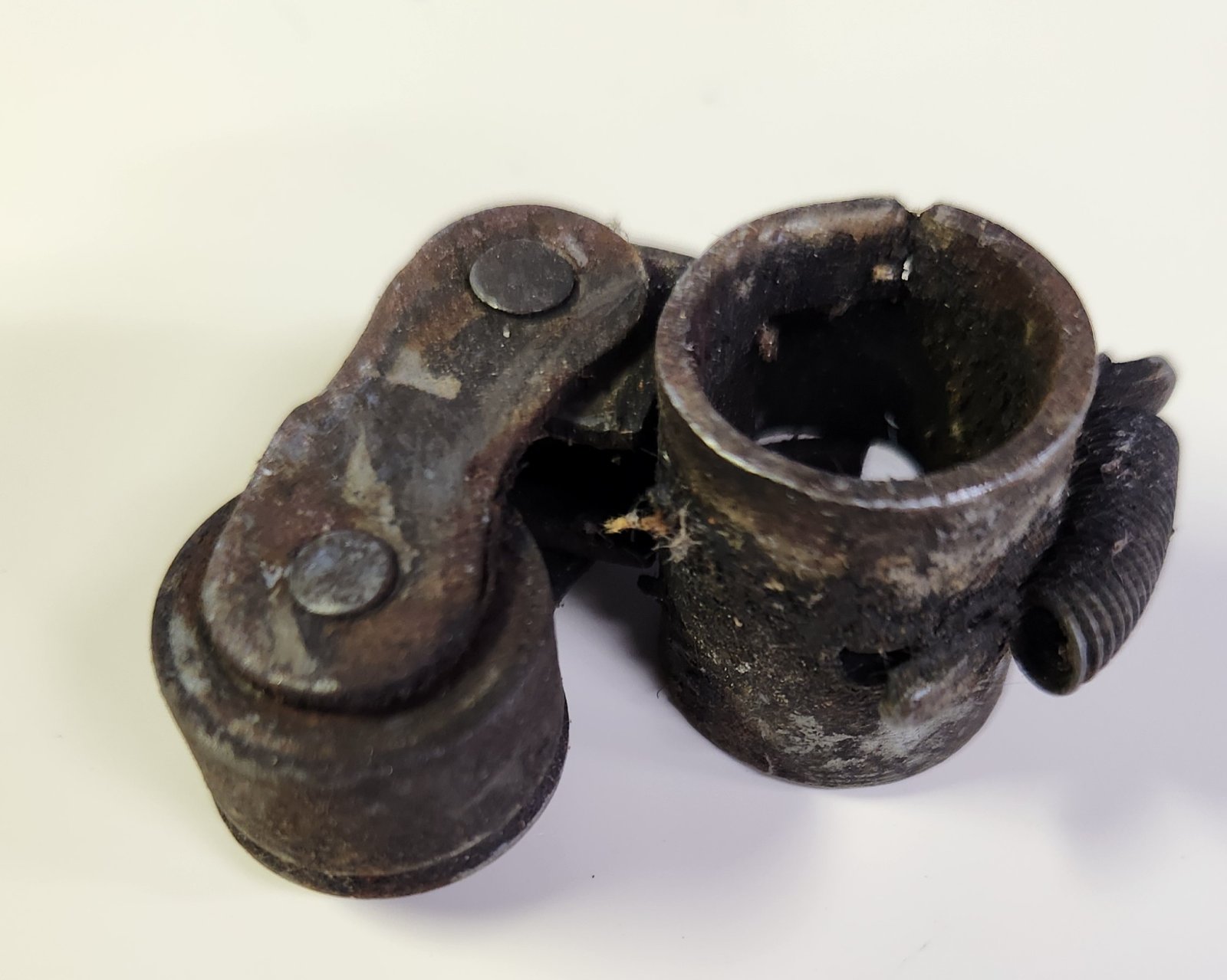

Good day. I have a few timer rollers and was wondering how do you tell if they are good to clean up and keep as spares and use and when they are just scrap.
My assumption is that if they roll relatively freely and the roller does not have a groove in it, then it should be good. Would appreciate any good rules of thumb that people might have.

Post by Jerry VanOoteghem » Sun Jan 26, 2025 3:03 pm
They are used up when the roller gets very sloppy on the pin. Also, when the roller diameter becomes tapered, grooved, or reduced in diameter. Best way to determine is to compare to a new one.

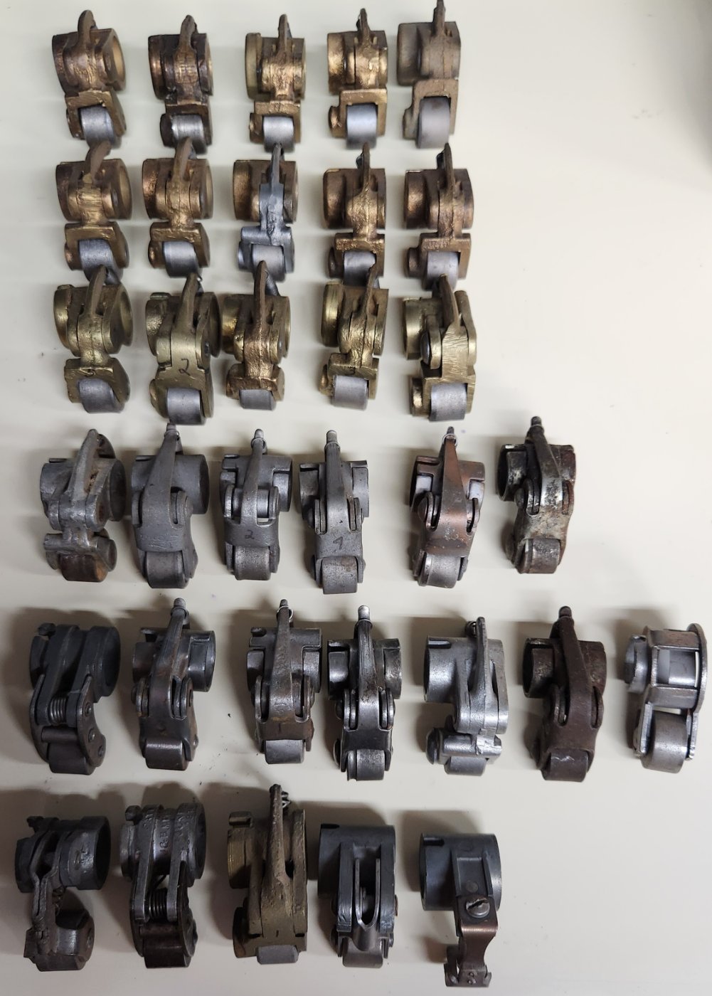

Post by Retro54 » Sun Jan 26, 2025 7:03 pm
I should have stated more clearly earlier... I have some spares.. 30+... just really asking to see how to tell whether they are good ones or bad ones...

I see two that look a little iffy. Good or bad? If the roller doesnt have excessive play and its not worn uneven, if the spring action is smooth and the pivots seen firm with a little twisting action, its clean and not pitted, should be a good one.

Post by Jerry VanOoteghem » Sun Jan 26, 2025 9:52 pm
At least 5 or 6 are toast. Any others need eyes & hands on to tell.

Post by TRDxB2 » Mon Jan 27, 2025 12:25 pm
My picks for the trash bin

Re: Timer Roller condition ?
Post by Retro54 » Mon Jan 27, 2025 4:48 pm
Agreed, was thinking those grooves indicated a lot of wear has occurred.

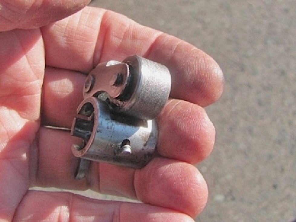

Post by DanTreace » Mon Jan 27, 2025 8:52 pm
Just one picture to assist, this roller was causing intermittent higher speed misses, the T was running real rough on tour. So much so the driver had to slow down, finally pulled over and we investigated issues. Checked coils, checked switch, etc, etc, before going to the timer case and pulling it. The roller was as shown, too much wear debris causing the rough surface, was not smooth and shiny as the roller surface should be.
(spring removed for other uses)
Replaced with a new spare, and the T ran great after that.

Post by Retro54 » Mon Jan 27, 2025 9:46 pm
Fascinating! Very helpful Dan. Starting to wonder if this stash is got my hands on was a collection of rollers whose time had passed.... lol. Very helpful.
