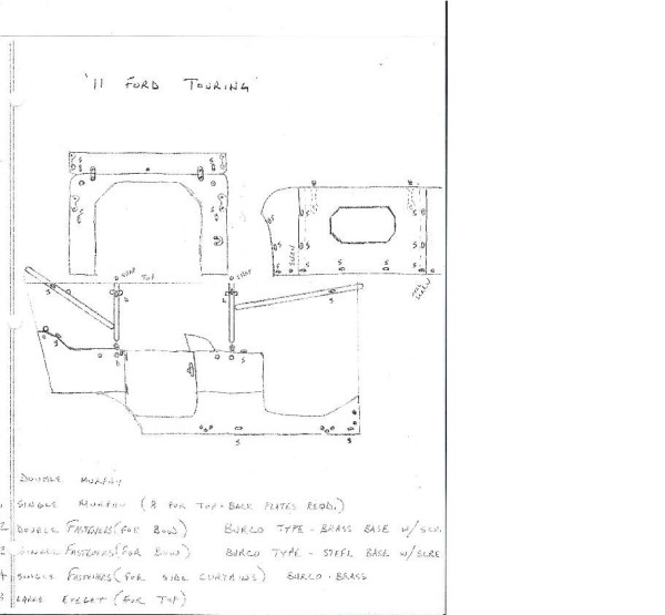

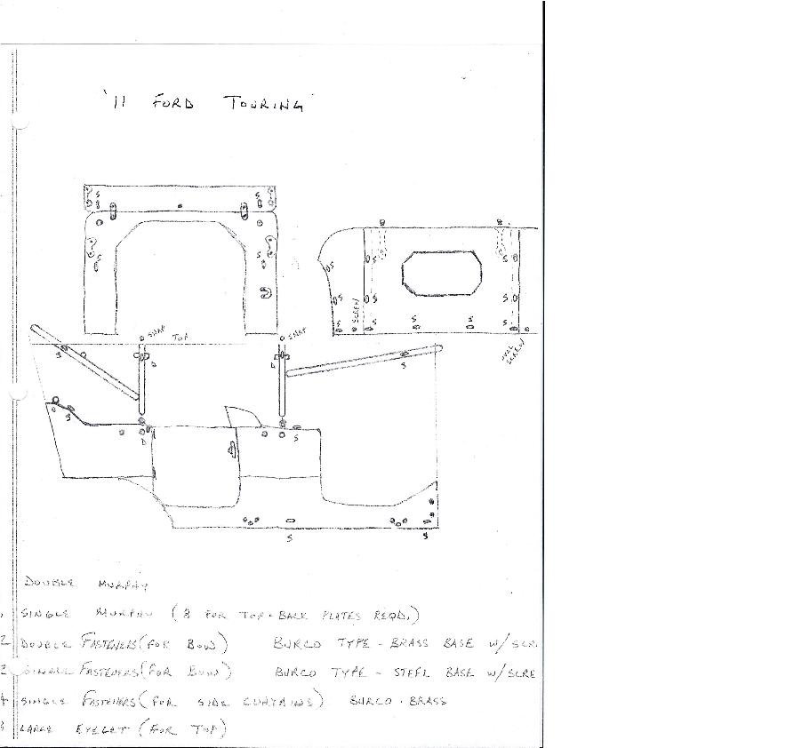

I am in the process of having a new top built and installed. I have tuned up the top irons and fitted new bows. I have a friend that has done 2 tops for my brass Buicks but he has never sewn up a T top. I would like to be reasonably accurate on stitching details for the new Touring top. I decided against the top kit route and purchased the necessary fabric for the new top. I would like to be as correct as I can with the top details.
Can someone with a 12 Touring top that you believe to be accurate take the following measurements for me:
1. What is the cross body width for the front to back sewn seams that is the wide center top Fabric (about 40 inches?)
EDIT: IS THE WIDE CENTER TOP FABRIC THE SAME WIDTH FRONT TO BACK?
2. Is the sewn seam on the lower edge of the top (front to back) single stitched or 2 rows of stitching?
3. How many murphy fasteners are on each side of the vertical edge of the roll up rear panel/window? I have seen pictures with just 2 per side including the bottom double Murphy style fasteners or 3 or 4 per side including the double fastener?
Any assistance much appreciated.

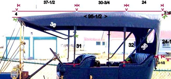

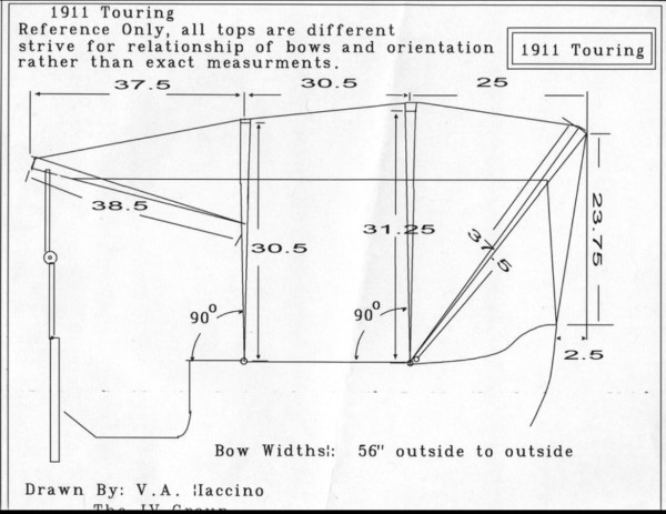

Re: A few questions about 12 Touring Top
Hope these help:
These are the dimensions on my top. Note the vertical bows should be close to the same height.
-Keith
-Keith

I just saw the attachment Keith sent. That nailed it exactly
John
Did Vince make diagrams like that for all years?
I have his video on DVD
dave
dave
My thanks to all that responded. Keith Townsend established contact and with his Late 1911 touring has provided great photos and responses to my questions. I am off and running now with my trimmer making the new top. I am new to T's and this forum, what a great forum with helpful folks!
