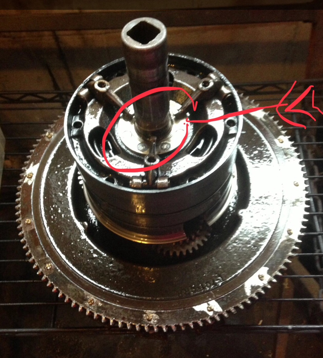

I had a 27 roadster that did exactly that. Joe Bell suggested it was possibly loose rivets in the tailshaft. Sure enough, that took care of it. About a 4 hour job for him to fix ,but he’s superhuman !

Tell me more ... but first let me know what you mean by “tailshaft” and where is it riveted?

Mark, my symptoms were exactly what you describe. If you take off your inspection cover, you can see the end of the tailshaft . You have to put some pressure on it from different angles and look VERY closely at the rivets. If you can see a little squish of oil, your rvits are lose. The only way to fix it is take it out and replace or remove and re-rivet them.

I’ll check the plate for loose rivets ... but fingers crossed it’s not that. Removing the engine for that would be such a pain given my limited work space.

I agree , a real pain. If that is the problem, it’ll only get worse and wear everything else out, too. Joe made it look easy but would have taken me a month of Sunday’s !

The only way I can think of to see if the rivets are loose without removing the transmission would be to have someone put on the foot brake hard with the clutch in neutral and someone else rock the car back and forth while you look in with a good flashlight. This would take at least 2 people and better 3. Problem with trying to pry up and down is the 4th main will keep the shaft from moving up and down.

Your video showed you moving out of low pedal, ( no real chatter then), and coasting to a stop with pedal halfway, no clutch engaged.
Then a lot of rattling when brake applied, noise to me would be trans. Worn bushings in triple gears, or as mentioned tailshaft that takes all the go and stop to the driveline has loose rivets, or maybe other pieces of the trans. Or, loose ball joint, and loose U-joint can contribute to the drive line separation gaps, that is happening when you stop, making that clucking, clunking sounds.

Hmm ... well, the transmission was all rebuilt, all new bushings etc. and everything that rotates balanced. The U-joint was good and tight, the forth bearing new and reamed for the shaft. The only thing overlooked was the upper drive shaft bushing. What is the sequence of trouble shooting I should do short of removing my engine, which would be a very difficult thing for me to fo at this point given where I live and the limited space I have.

My Kevlar bands were great until my cracked block let some coolant in the oil. I think it was the antifreeze that caused my bands to chatter. It’s been several oil changes now and they are better.
