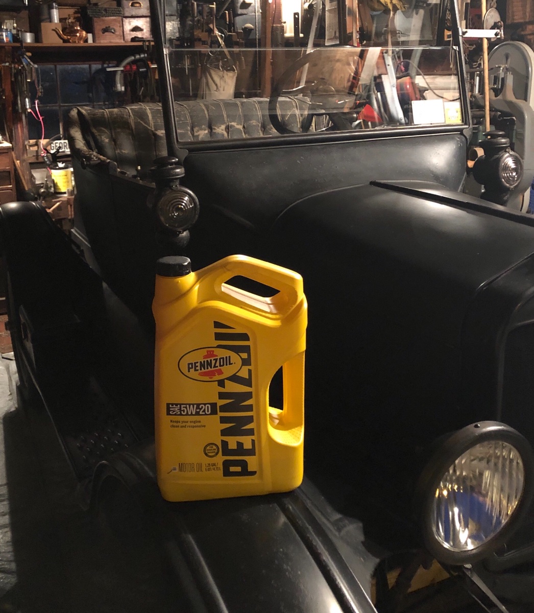

Just for the record and my curiosity Mark.
And NOT to poke the hornets 🐝 nest... :lol:
What type of oil are you running ? :o
Mark Osterman
Posts: 1014
Last Name: Osterman
Location: Rochester, NY
Re: Chattering Brakes
Post by Mark Osterman » Sat Jun 29, 2019 9:46 pm
WHAT ... I’m supposed to have oil in there?!
LOL ... well this month I have Pennzoil 5w 20 in there. Other times I use 10w 30. Generally what’s on sale and I change it about every six weeks. I drive the car nearly every day ... about 100 miles a week or more.

Post by Scott_Conger » Sat Jun 29, 2019 10:28 pm
Mark
you should really rethink the present choice of oil in your car
When oil ceases to be a hydrodynamic film, it's simply boundary lubricant. Nearly all tailshafts have more runout than they should have and if the lubricant cannot sufficiently maintain it's wedge, you're going to beat out the 4th main and this can cause trouble like you're experiencing.

Post by Mark Osterman » Sat Jun 29, 2019 11:47 pm
Ok .... no problem, easy to do. I have used 10w30 for years in my other T and in this one. I tried the current oil weight based on what people posted on the forum. What weight or type oil would you suggest?

John
I agree with you. That is because I did not suggest that changing viscosity will fix the problem. I stated that when oil loses it's ability to maintain a hydrodynamic film, wear will occur rapidly.

Post by Ruxstel24 » Sun Jun 30, 2019 10:56 am
I too doubt the oil is the cause of the chatter.
I agree that 5W-20 is not recommended, especially in the summer. I recall Steve J attributed his rod bearing failure on 5W-20.
When hot, that stuff has the viscosity of kerosene !
Take pictures when you decide what to do. ;)
