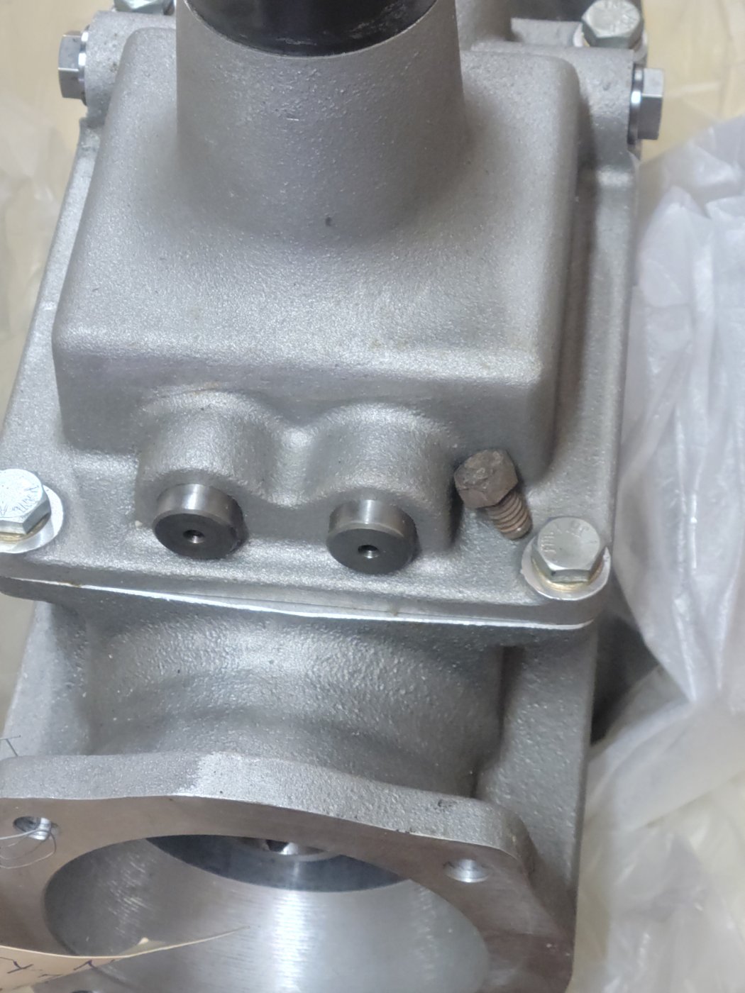

Looking for information on best location on the shift tower of Layne warford to drill & install the Layne supplied vent.
Thank you in advance.

This is where I was told to install one by someone knowledgeable. Where the bolt is sitting. I used a 1/4" pipe thread cintered bronze vent.

The Ford Model A transmission has a vent hole on the shift tower.

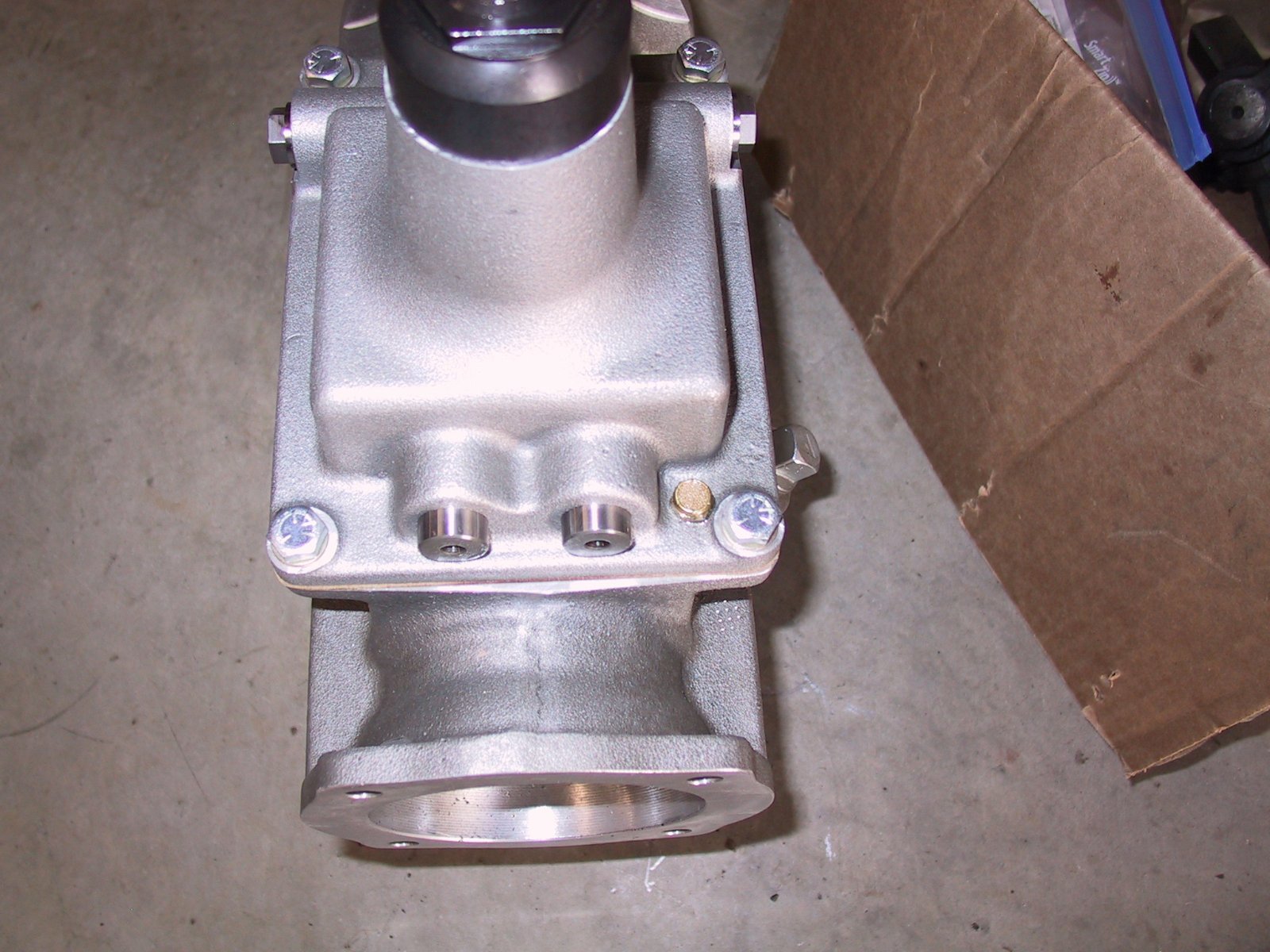

The later Layne Warfords come with a vent. See picture for location. You guess looks pretty good.

Gentleman , thanks for all input, I have drilled fill plug & installed vent hose over fuel tank w/ catch bottle, getting some fluid after some miles.
One additional question.. all photos show brass vent location at rear of shift tower. Can it be installed at front area of the tower?
