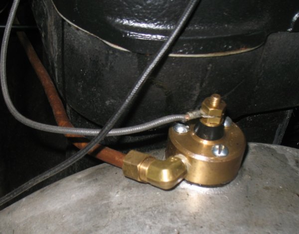

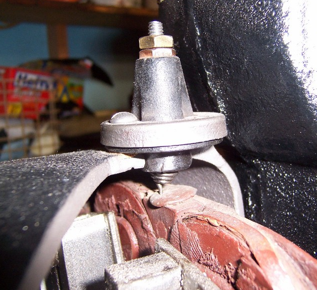

Forget the electrical tests for now. Confirm that there's no band lint issue. The mag post sits at the very top of the hogshead and has the magneto power wire attached to it. The post will be held on with 3 slotted head screws, (unless your car is a 26/27).
Here is a pic showing the mag post and how it contacts the magneto coil ring. (The hogshead has been cut away for clarity)
It's also possible that you have a mag post with an accessory oil pick-up. Like this...
They can be troublesome at times as well...

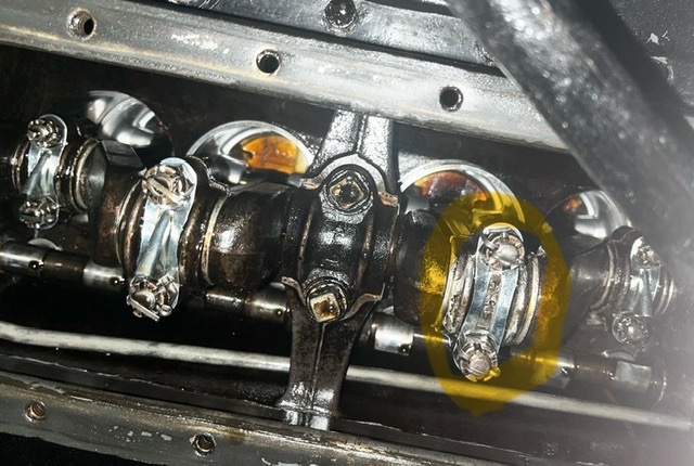

Re: Magneto woes…
Post by Norman Kling » Mon May 19, 2025 5:23 pm
One common cause not posted above is loose rear main bearing on engine. The thrust surface worn on the rear side toward the flywheel. Try this. run for a while with the front of the engine elevated. Then turn off the engine and take a pry bar between the front crankshaft pulley and the front of the engine. If the crankshaft moves forward it will move the magnets farther from the coils which will cause less current to flow. Best cure is to re-pour the babbitt in the rear bearing, at least in the cap. Sometimes a temporary fix would be a shim made for insert between the cap and the rear flange of the crankshaft.

Ok here is where something is weird.
Testing the ohm.
Unhooked the wire, tested and got .1 ohm.
Removed the unit to check to see if the elbow was protruding into the body.
Curious as to what the pin was riding on I stick my finger into the hole in the hogshead.
I see something shiny and pin like (needle bearing)? And I touch it and it falls into the pan.
I reassemble and check the ohms and it is reading .5-.6 ohms.
I start the car and use the test light and it shines right up.
Switch the key to mag and it functions like it should.
Question, what the hell was the metal thing?
Where did it come from?
Am I dropping the pan to find it? What’s my next step?

Sounds like something was shorting out the mag. You got lucky!
BUT what was it?
It may have gone to bottom of pan. Or is stuck to the magnets.
I would drain oil and see if can feel it at drain hole.
If you got a bore scope look in transmission and see if can find it. Dan

Scrap of safety wire or cotter pin? Especially if recent transmission work was done, that would also explain what appears to be brass particles in the last photo you posted.

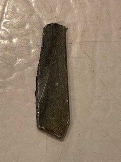

Post by WillyR » Mon May 19, 2025 10:11 pm
Oil changed, no metallic look to the oil.
This is what came out, it doesn’t feel as heavy as it sounded when it fell.
There is a shiny spot than made me think it was cylindrical for the 8/10ths of a second I visualized it…
Not sure why the trend, but there is a banana for scale…
Started it again and switched to mag and it functioned like it always has…
Sent from the panic room, via two tin cans attached with a string, and a jail broken Marconi, while wearing a Tin Foil hat.

Post by Line_Noise » Mon May 19, 2025 10:24 pm
That looks like a piece of clutch lug shoe from the brake drum.

Post by Craig Leach » Tue May 20, 2025 12:56 am
Hi Wilhelm,
How thick is that piece? could be a piece of clutch plate or clutch lug shoe but I think they are different thicknesses. I have had clutch plates
crack & fracture into pieces much like that. Do you have a trans screen with a magnet in it? That was were I found my clutch pieces. Plates
& shoes are hard enough to reek havoc on triple & drive gears.
Craig.

Post by WillyR » Tue May 20, 2025 1:18 am
Hi Wilhelm,
Craig.
It’s fairly thin, I’ll check it with my micro-meter tomorrow. I’ll need to fix it since I used it to remove my drain plug. It’s a pretty shittu adjustable wrench.

Post by WillyR » Tue May 20, 2025 9:26 am
Hi Wilhelm,
Craig.
Jerry VanOoteghem wrote:
Tue May 20, 2025 6:36 am
Don't know if it will help, but could you post a few close-up images of the "thing"?
Dan Hatch wrote:
Tue May 20, 2025 8:47 am
Is it steel, aluminum or (hopefully not) Babbitt?
Having trouble getting focused close ups
It’s magnetic steel
I do have a trans screen and magnets. I’ll pull that tonight and see if I caught anything

Post by Jerry VanOoteghem » Tue May 20, 2025 10:23 am
Maybe try backing away a bit with the camera/phone and then zooming in??
Is it hard steel? Can you file it, or will a file not "bite"? If you try to bend it, will it take the bend, or just spring back?
There are not a lot of thin metal parts inside your motor. I almost want to say that it's a piece of broken off transmission band, but I'm not sure how such a fragment would break away like that. Another thought is a piece of a high-speed clutch disc.

Post by WillyR » Tue May 20, 2025 11:37 am
Witchcraft and alchemy
It is quite hard, I doubt it would bend without breaking and a file would have little effect.

Piece of clutch disk.

Post by Craig Leach » Tue May 20, 2025 1:41 pm
Hi Vilhelm,
Had the same part show up in my screen back in 2023 & decided to pull the engine this is what I found
I attribute this to my own fault, when I filed the clutch lugs with a square file I made the lugs tapered to the center, there for putting all of the
load on the very tip of the notch in the plates instead if evenly spread over the flat. My solution is to grind opposite sides of the square file so
the none cutting edge rests on the curve of the hub holding the cutting edge square. Thusly finding out that trying to saving money by not buying
a new hub the more labor intensive route. And the clutch worked just fine so don't let that fool ya.
Craig.

Post by Jerry VanOoteghem » Tue May 20, 2025 2:40 pm
Yup. I'd say clutch disc, 100%.
Sorry dude...

WillyR
Posts: 359
Joined: Wed Aug 21, 2024 5:24 pm
First Name: Vilhelm
Last Name: VonRaschke
* REQUIRED* Type and Year of Model Ts owned: 1924 coupe
Location: ABQ
Re: Magneto woes…
Post by WillyR » Tue May 20, 2025 10:27 pm
I just cleaned the screen less than 200 miles ago.
There was a little bit of metal on the magnets nothing like this there is a metallic sludge all over the magnets.
Had it for just over 6 weeks
Posts: 4479
Re: Magneto woes…
Post by Jerry VanOoteghem » Wed May 21, 2025 6:28 am
That's an oil dipper from the bottom of one of your connecting rods. Good that you found it! Remove the oil pan inspection cover and you'll immediately see where it came from. As for the metallic fuzz, that's normal.
Last edited by Jerry VanOoteghem on Wed May 21, 2025 10:24 am, edited 1 time in total.
Posts: 5548
Last Name: Hatch
Location: Alabama
Re: Magneto woes…
Post by Dan Hatch » Wed May 21, 2025 8:04 am
Pull the screen and look at drums.
Also pull the bottom cover and see what took out the dipper.
When you go back, don’t use reproduction clutch disc. Never had any luck with them. Go with 400 disc and original large disc.
If you have to replace brake drum get one with replacement lugs.

Your magnet is on the wrong side of the screen!!!
The magnet fits in the screen trough on top.
The way you have it makes it likely to fall into the transmission.

I think they're in the right place. They seem to be smaller magnets than we're used to seeing and are obscured by the fuzz.

Post by WillyR » Wed May 21, 2025 10:28 am
First, watch your language...
That's an oil dipper from the bottom of one of your connectiong rods. Good that you found it! Remove the oil pan inspection cover and you'll immediately see where it came from. As for the metallic fuzz, that's normal.
yes, apologies, and edited.
the drums and bands from the trans cover seem fine, should I attempt to rotate and further inspect?
this is the second time I have inspected the magnets, and first time was more of a black iron filing look this time is more silvery fuzz, and a bit more, so that had me worried.
I was almost expecting more of the same hardened steel pieces like the first one.
I'll get the oil pan inspection cover off tonight and see what is going on there..
the crud in the first two pics looks to be some band material and a wisp of silicone.
What parts should I be buying?
the dipper set is $22
looks like the clutch disk set is about $200 with a couple different options.
speedytinc wrote:
Wed May 21, 2025 8:18 am
they are small neodymium magnets, I added some bar magnets across the top of those for more surface area without blocking the mesh.

I'm seeing how the con rod dippers are attached.... I'm nervous about what tore it off...

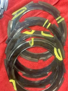

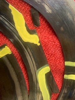

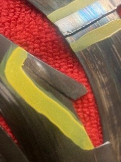

I was told not to recommend bead blasting new disks, they warped. Original disks do not warp with bead blasting.
I suspected new disks were cut from hardened sheet thus adding a stress memory that appears when hot or blasted. I expect ford disks were hardened after forming. For this reason, I only use original disks and the majority of the time with TH400 clutch sets.

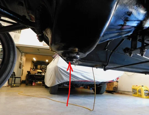

Ok so when I pull the inspection pan, I just need to look for a cause of the dipper coming off? but I don't need the dipper? I'm ok with that...
or is there a real cause? just cheap junk spinning off into the ether...
I don't have an inspection pan gasket, so if I don't need to remove the pan just yet, I'd prefer it.
AND I don't need to worry about taking the engine out yet? she has been otherwise driving fine.
I'll get an inspection pan gasket on my short list of things to buy.

Question - did you jack the front of the car up when you drained the oil? If not, you want to do that before you pull the cover. There is like half a quart of oil in the pan dips, it is a lot less messy when you can get as much out as possible ahead of time. It is probably still going to be messy.
Also, I don't know how clean and dry your garage is, or what other purposes you use it for. If there is any chance of dust, moisture, rodents, etc. getting up in there, you might want to make two studs out of bolts or threaded rod so you can quickly get the cover back on, start a few bolts and close it up hand tight between inspection sessions, rather than just leaving it off overnight. I took a couple of matching thread size bolts and cut the heads off, worked great. You will need something anyway when you go to close it up final, when there is wet sealant on the mating surfaces and don't want to smear it all off fighting to get bolts started into the horseshoes.

Line_Noise wrote:
Thu May 22, 2025 12:53 pm
I was going to drain out the lower oil check valve and jack the car up.
It's dusty on a good day so I was going to button up the cover after inspection. not having taken one off before I wasn't counting on the gasket being re-useable.
Posts: 4479
Re: Magneto woes… turned into clutch disk woes...
Post by Jerry VanOoteghem » Thu May 22, 2025 2:20 pm
WillyR wrote:
Thu May 22, 2025 1:40 pm
Did you remove the drain plug at the bottom of the pan?

Posts: 5268
First Name: john
Last Name: karvaly
Location: orange, ca
Post by speedytinc » Thu May 22, 2025 2:42 pm
What the point of that?
Pull the drain plug & feel around & find any other pieces.
If you want to limit good oil loss, save it & put it back in.

It looks quite nice in there, no signs of other foreign matter.
The holder piece for the scooper is tight no signs of con rod problems. On any of the caps.
The previous owner recalls one of the rod may have had a shim removed some time ago.
It this was the one and the old scooper was reused that could explain its failure.

Post by Dan Hatch » Mon May 26, 2025 12:25 am
Look at rod number 3, marked in yellow.

The dippers need fiting. This means if they are too wide to go between the raised edges of the cap, they need to be narrowed to fit. If the rod bolt holes don't line up when they do fit between the ridges, the holes need to be reworked. The dippers should not just be placed over the bolts and the nuts drawn up, deforming stuff as they are tightened. I believe the dipper part id spot welded to the base, and stretching/deforming it may have broken that weld.
With the pan cover off, it is wise to remove the horseshoes in the pan and clean out any crud which may have lodged between the shoes and the pan sides.

Post by TFan » Mon May 26, 2025 8:38 am

Post by Dan Hatch » Mon May 26, 2025 9:43 am
I don’t see one either. But something made the scoop come off.
They don’t just fall off for the fun of it. Need to at least take cap off and check bearing. Check the cover and be sure not hitting something.

Maybe it's just my eyes but I see no hole for the dipper to push the oil through where the scoop is missing. Jim
I believe you're correct, Jim. That being the case, there's no reason to use dippers at all. If it were mine, I'd just remove them entirely.
Some will say that they will still splash oil around. They apparently, will also fall apart... Not worth it.

Post by WillyR » Mon May 26, 2025 1:57 pm
There is a looberkashun hole in the cap.
I have a new dipper and I can see how it’s spot welded to the flange.
When I get the old one off I’ll see where the old one failed.

Post by WillyR » Mon May 26, 2025 4:31 pm
The old dipper sheared off and the flange with the spot welds was intact.

Those dippers show signs of never being fitted, just put over the rod bolts and drawn down, conforming to the rod as they go.They should not distort inwards at the sides of the scoop, and the rod holes should not be stretched oval If they were fitted, there would need to be some relief on the sides so they would settle between the webs on the cap without distorting the sides of the dipper. Then, if the bolt holes did not line up, they should be deliberately reworked into an oval shape so that the foot can rest on the cap bolt holes. The bolt will the fit without stretching the eye in the dipper body.
Like a number of reproduction parts, they need reworking so they can do what they are supposed to do. Who can remember the amount of fettling needed to make the old two piece, cast iron, lined emergency brake shoes?
Allan from down under
Could be, I fitted this one, (rounded to the cap shape) it didn't take much, I think I'll check my transmission screen every time I lube my timer. so 200 miles or so.

Is there actually a hole in the rod cap? That looks like it is just a punch mark, if a hole it is rather small.
