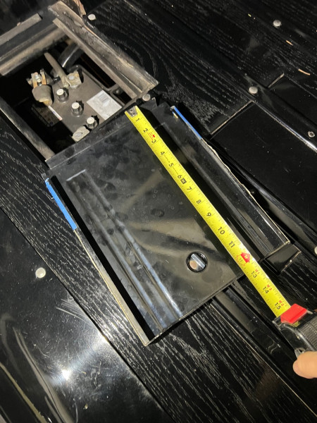

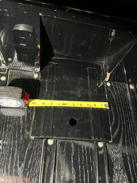

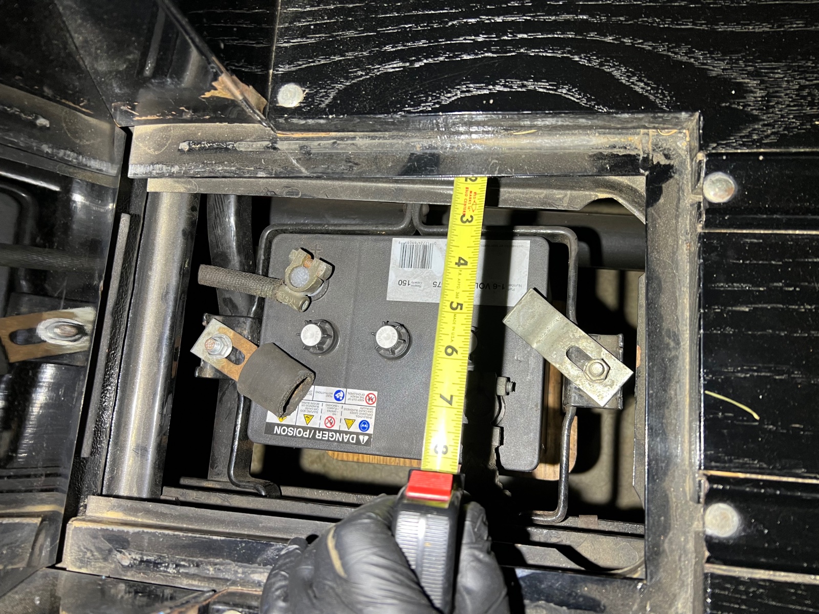

Photos of the pressed metal battery cover on my 1926 RPU.
Same as the one in Langs catalogue.
10” by 12 1/2” x 3/4”.
The forward edge is angled.
The hole allows you to pull it out.
It is supported in the bed by a U-shaped flat frame, 2” wide, that is fastened to the bottom of the bed by the four galvanized carriage bolts seen in the photo. There is a second support frame attached ~1” below the 2” wide steel frame but it currently is not being used. I’m not sure on the history of that frame, seen from underneath the pickup in the photo below.

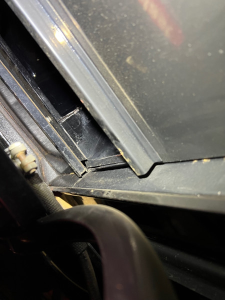

K, Thanks for posting those pics. What I'm wondering is what is used to keep the lid from falling through the hole. I can see something in your pics but can't quite make it out. Thanks again Jim
Moxie26
- Posts: 2071
- First Name: Robert
- Last Name: Jablonski
- Location: New Jersey
Re: 26 pickup battery cover
The opening in the floor is flanged to hold the covering lid
