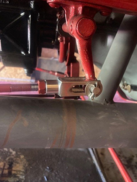

Balancing RM brakes & park brakes is a art in it's own. The pedal travel doesn't change much when the brakes are wet or you are rolling
backwards so I try to set the Rocky's to work with the stock brake but not before. The issue I have is mostly with the park if you ajust the
Rocky's to tight they energize stopping the park brake travel before it is working so if you are rolling backwards & pull the hand brake the
Rocky's stop the hand brake from engaging & sometimes the park brake adjustment will not let the brake handle go far enough forward
to engage the clutch. I found some clevises & milled a slot in them to help solve this issue. Not the conventional solution but works for me Craig.
