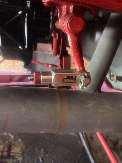

This may help you out: https://www.fordmodelt.net/rocky-mountain-brakes.htm
I hope I got that right. Mitch Taylor wrote that up. There's a lot of good info there. Yep, I tried it and it is correct.

Balancing RM brakes & park brakes is a art in it's own. The pedal travel doesn't change much when the brakes are wet or you are rolling
backwards so I try to set the Rocky's to work with the stock brake but not before. The issue I have is mostly with the park if you ajust the
Rocky's to tight they energize stopping the park brake travel before it is working so if you are rolling backwards & pull the hand brake the
Rocky's stop the hand brake from engaging & sometimes the park brake adjustment will not let the brake handle go far enough forward
to engage the clutch. I found some clevises & milled a slot in them to help solve this issue. Not the conventional solution but works for me
Craig.
