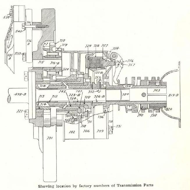

What size cotter pin used in clutch finger adjustment?.... Diameter and length. Thanks in advance

Per Bruce's CD parts listing, the cotter for the clutch finger adjusting screw is Factory No. 757 , as shown on the cutaway drawing.
Cotter pin, 3/32 x 7/8". Clutch finger
