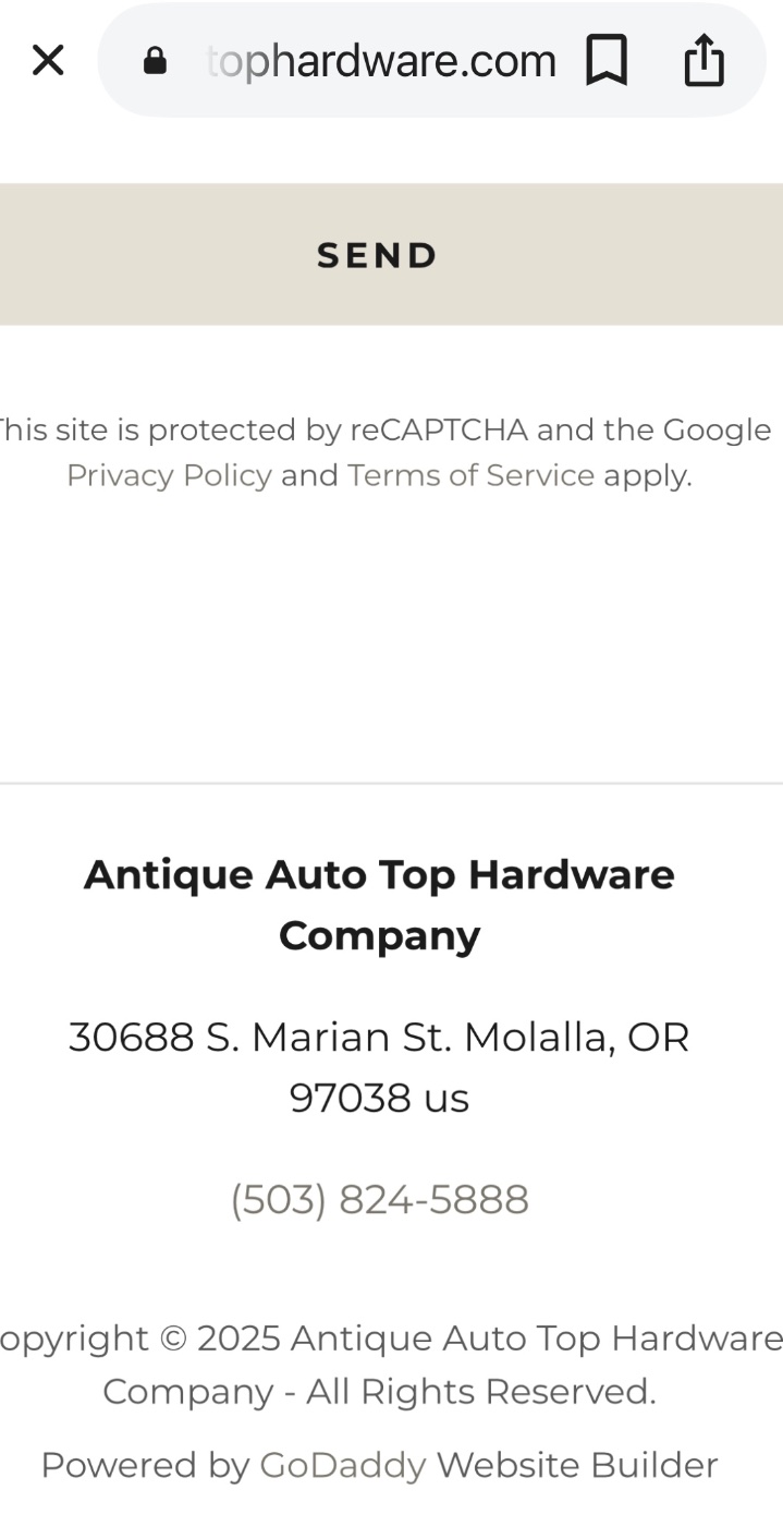

You might call this outfit , may have a saddle that fits.

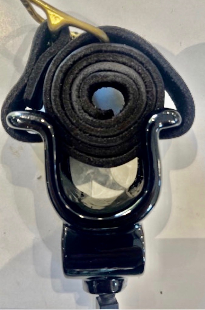

Post by DanTreace » Thu Jul 10, 2025 9:14 pm
This is the measure made on the socket diameter.
1910 touring, original saddles, reproduction top sockets with the following measurements:
Top socket width 1-45/128"
That would be about 1 3/8" diameter, give or take.
But remember the saddle will have a leather strap laying in the curve, so you have to add that thickness too.
Dan, is there a specification for the thickness (weight) of the strap leather ? Diameter of the rolled strap can be adjusted by skiving down the thickness of the strap.
