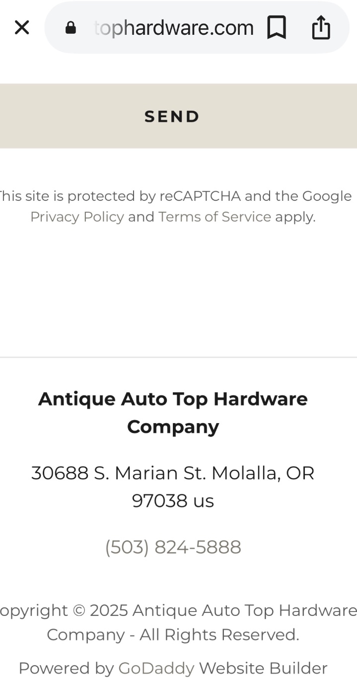

Post by DanTreace » Thu Jul 10, 2025 5:20 pm
You might call this outfit , may have a saddle that fits.
