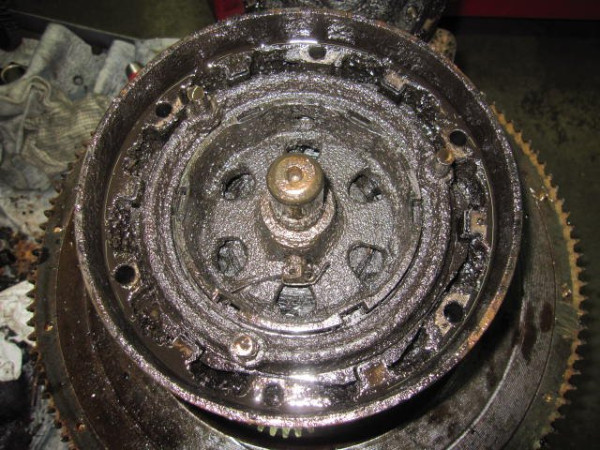

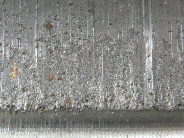

If we look at it ,you know what we're going to find
Problem with a Model T is it all has to be done, there is no 50%. The first 50% will affect second 50% and vice versa.
If they didn't do transmission, though did engine part all the dirt from flywheel and magnets will reintegrate with the engine part.
As seen in submitted picture of babbitted rear main bearing with debris stuck in it as babbitt does.
You'll see the bronze speckles .
second picture is dirty transmission. Just can't expect to get these clean by washing alone.
Money well worth doing it right rather than doing it twice.

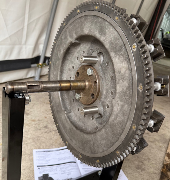

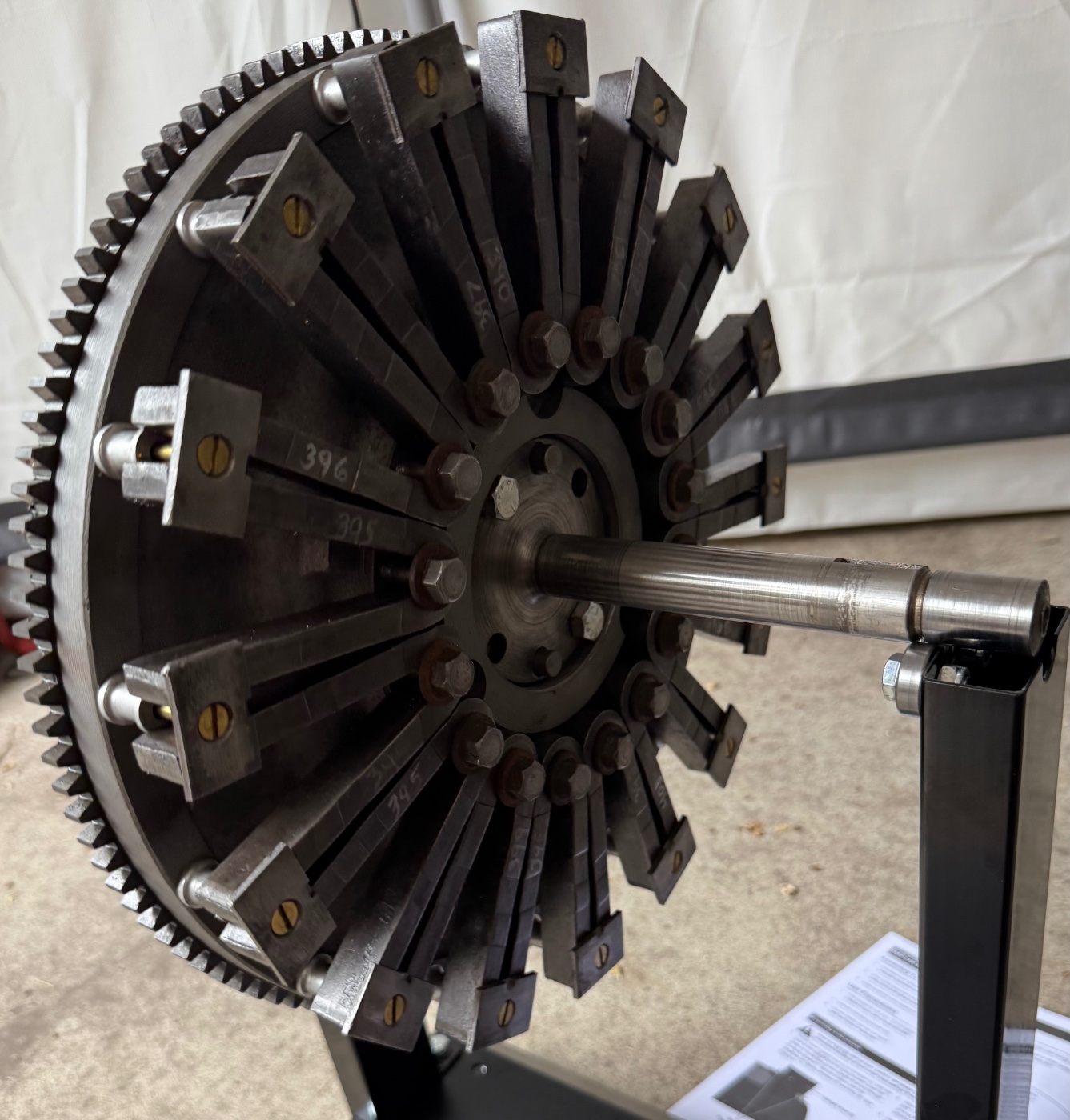

Post by nathanw90 » Mon Sep 01, 2025 7:56 pm
Update!
New (used) flywheel acquired thanks to Langs.
All cleaned up, pins measured for Dan.
New pins installed and weighed all the magnets. Cautiously laid them out. I used a harbor freight motorcycle wheel balancer to move the magnet weights around.
Work quite well. But now going to try it on the wheel balancer at work. If it looks easy enough and runout is okay, I'll do it. But otherwise I'll make a trip to a pro ;)

Post by nathanw90 » Tue Sep 02, 2025 7:03 pm
So, I tried the wheel balancer method. I believe it worked well! I started being off balance by 15 grams.
