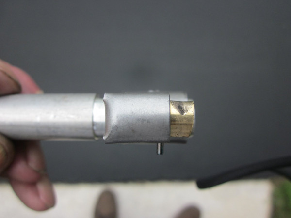

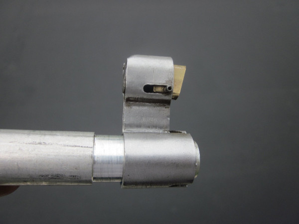

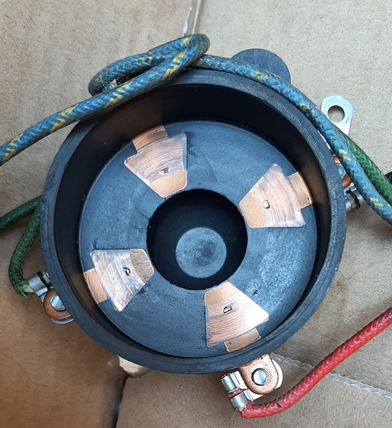

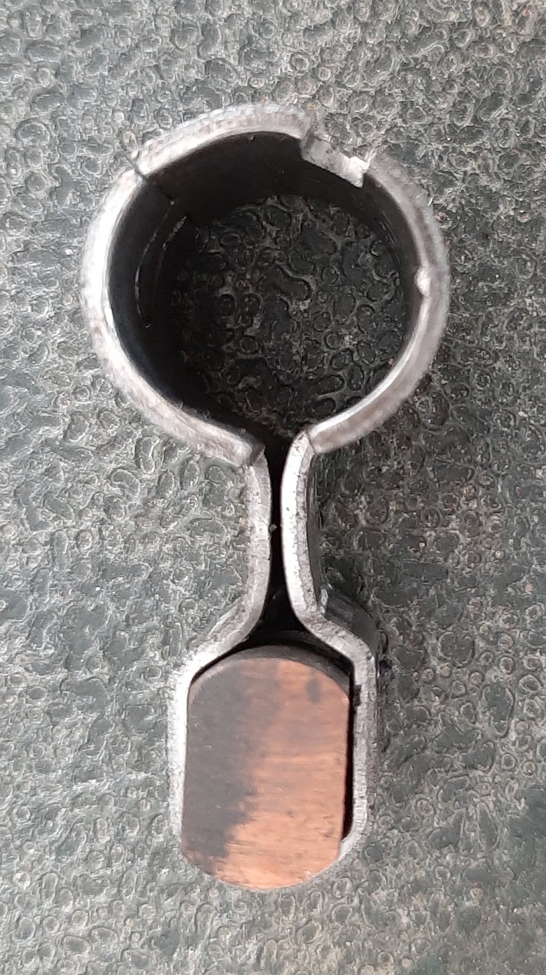

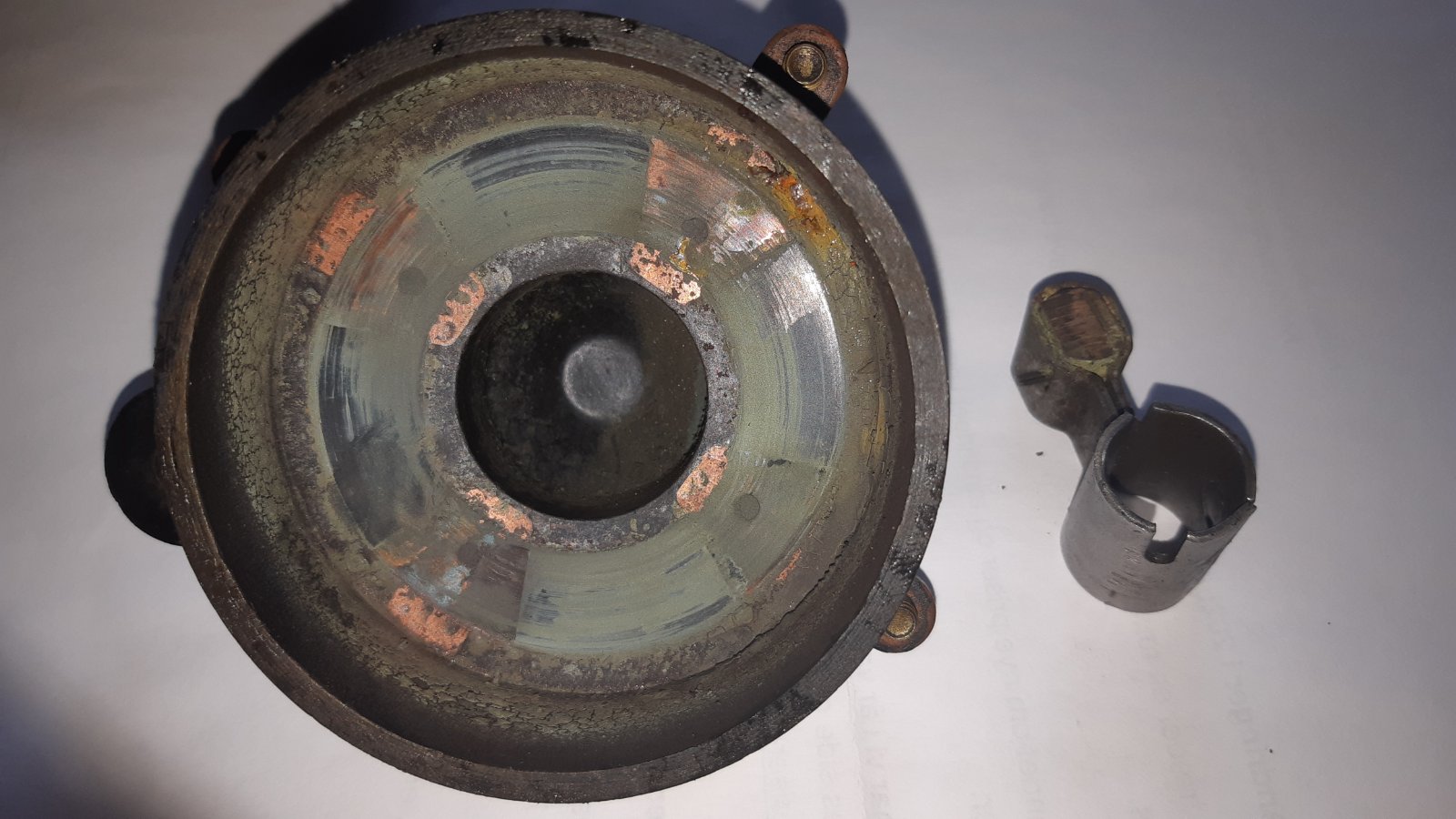

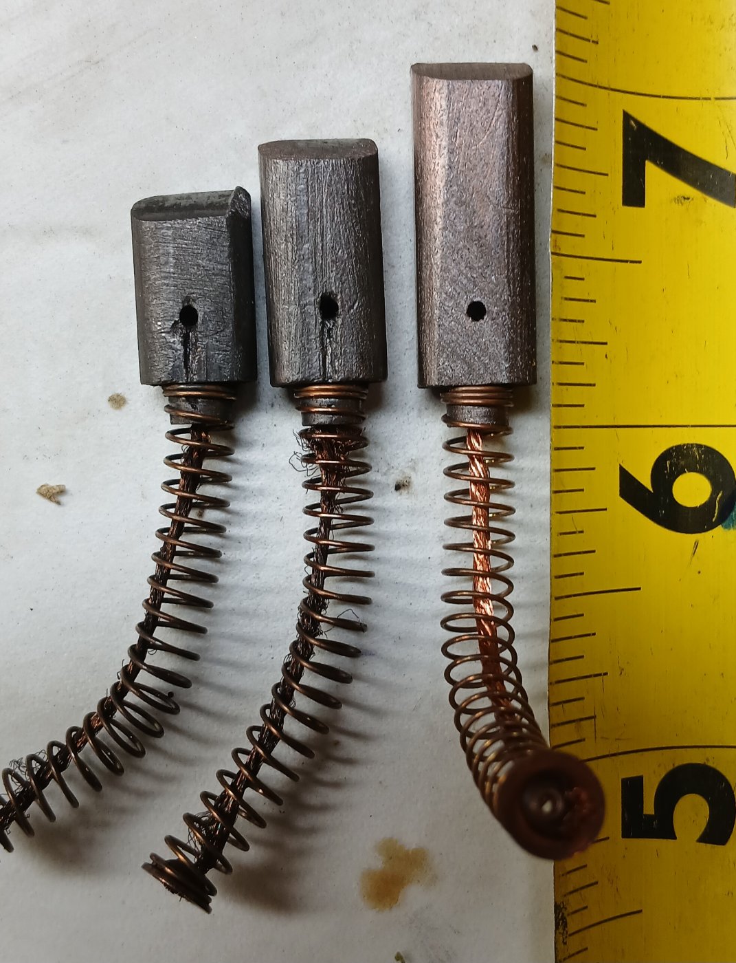

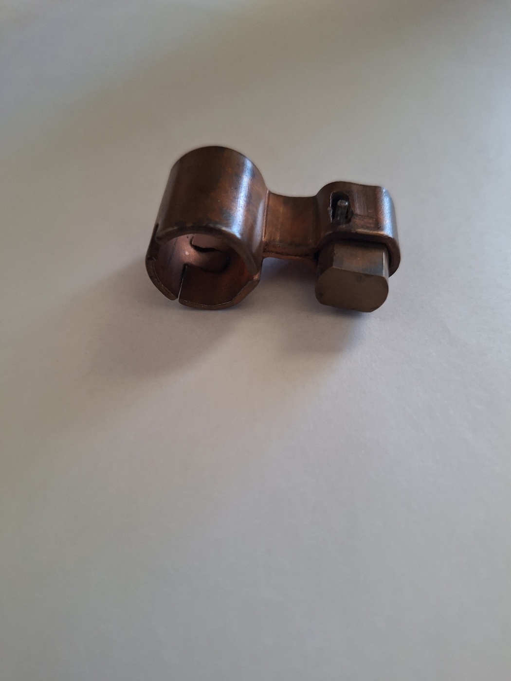

About 2+ years ago I installed a reproduction New Day timer assembly on my '26. Yesterday while wiping out the housing, I observed what you see in the attached photos. I was shocked. My best guess is there's only about 1000 miles since the timer install. Looking for opinions or any applicable advice.
Thank you,
Peter
Thank you,
Peter

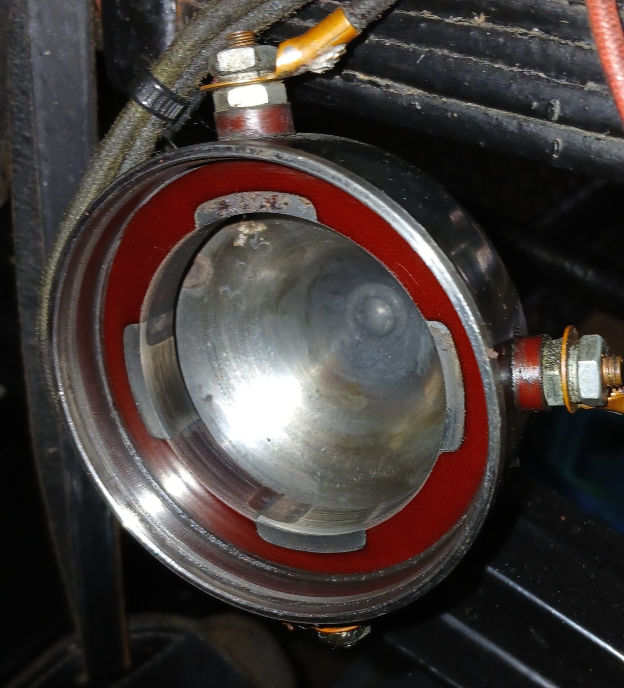

Out of curiosity, what does the “race” look like in the timer body ?
Over 62 years ago I ran a used New Day in my first T. Great timer ! I fear that the reproduction units don’t equal the quality of the originals, especially the fit of the bronze brush in the rotor. I believe the originals were self-lubricating graphite bronze - the reproductions are not.

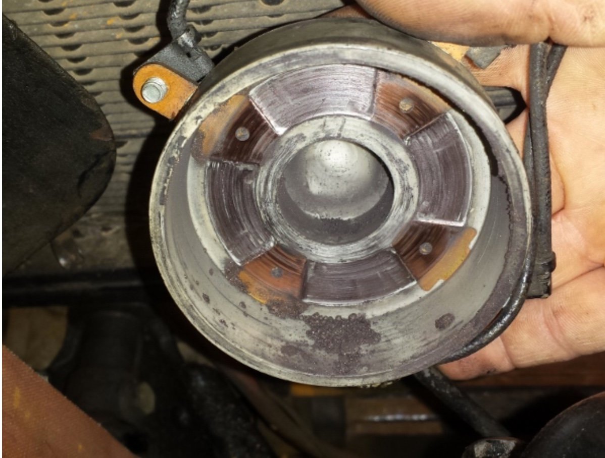

There have been many discussions of New Day timers over the years, often with detailed pictures. You can spend a lot of time with Mister Google reading about these timers, but it all boils down to a couple of points. 1 There's New Day and there's New Day, sometimes excellent and sometimes miserable. Unsurprisingly, the miserable ones are reproductions. 2 In recent years the Tip Top Timer reproductions from Spokane have enjoyed a reputation for being excellent.
Even people who know their stuff can mess up, so it's possible you got a defective Tip Top brush. More likely, it's somebody else's repop. If you contact Mark, perhaps he can sort out your situation.
https://www.buzzfile.com/business/Tipto ... e_vignette

Though I did not photo the housing, it looks Ok in my opinion, smooth all the way around. I have cleaned it previously and there was quite a lot of "dust" which I just attributed to the brush and cap breaking in. I purchased a spare brush a while back which I installed today. I'll keep an eye on it. I do feel the brush in the replacement seems to slide in and out more freely than the former.
Peter
Peter

The timer in question came in a Tip Top box which I still have. The box has a date 1/13/2021. The replacement brush was purchased 2/13/2024. That's all minor info. I'm just going to keep a close eye on things.
Peter
Peter

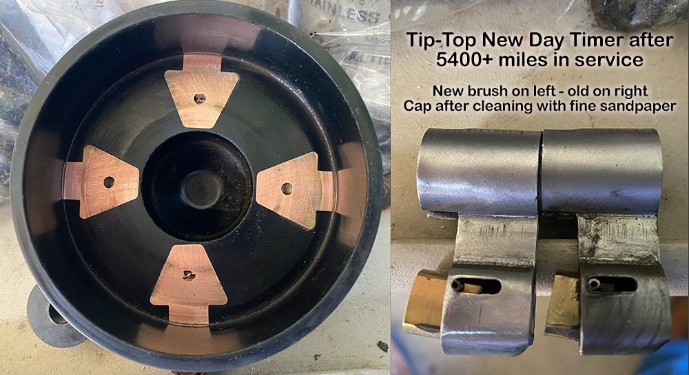

People love or hate New Day timers. It usually comes down to original versus reproduction and if the latter, the quality of the reproduction. There were a number of attempts to reproduce the New Day in the past and they all pretty much missed the mark, until Tip-Top came out with theirs.
If you buy a timer kit from the vendors they usually come from Tip Top and contain their brush. If you buy a individual $10 brush from Snyders they are from an old reproduction and are inferior. Stick with Tip Top even though they cost more. The attached photo shows the two brushes - Tip Top on the left, Snyder's $10 brush on the right. Notice the different appearance of the metals used. Also notice that on the "S" brush there is less material between the pin and the bottom of the brush. There have been reports of the bottom cracking from the hole and breaking apart on the "S" brushes. Another thing..... have you replaced the felt camshaft seal with a modern Neoprene one? That also entails removing the brass shield behind the cap and brush.
I get great results with my New Day's - My timer cover was installed using a tool to center it, my coils were rebuilt and adjusted by a pro, there is no end play on my camshaft, I have a modern camshaft seal and I timed the engine with the New Day from Tip Top in place. I carry a spare Tip Top cap and brush but have never needed to use them in 12K miles. Good luck with your issues.

Shall we complicate the discussion? Some people will take the defective brush out of the rotor and toss it, and make a new one from an old generator brush. Apparently if you have the skill to make a good fit, it works pretty well.
- Posts: 5243
Re: New Day timer brush question

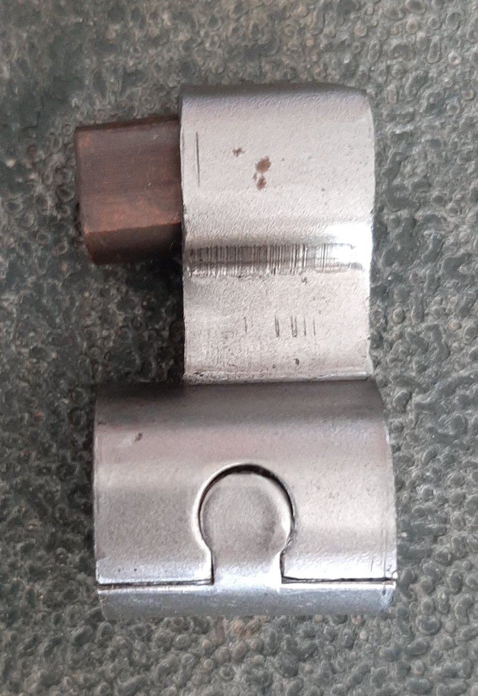

Yes it does. I have done several score this way. Zero wear to the timer body ever. Make the fit just enough to freely move.Steve Jelf wrote: ↑Thu Aug 07, 2025 3:06 pmShall we complicate the discussion? Some people will take the defective brush out of the rotor and toss it, and make a new one from an old generator brush. Apparently if you have the skill to make a good fit, it works pretty well.
The brush cant cock like OP's example.

Making one's own brush sounds interesting to me. I think I am capable but don't have a brush. Going to a flea market this Sunday maybe I'll find one. Thanks for the Idea.
Peter

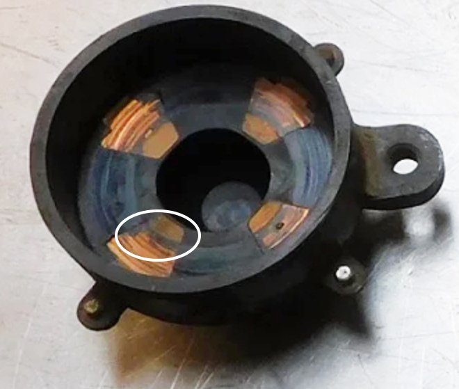

- Posts: 5243
Your brush is worn down to where the brush holder has rubbed/scraped the contact face. That grey stuff is ground phenolic.
For this to happen the brush is mounted too far out. The brush holder should not be able to contact the face.
You probably have too much forward cam thrust movement & a possibly thicker timing gear thickness from a non stock gear.
I would guess that as new, the timer body "danced" with each revolution. You would need to solve the issue(s) to run a new day.
Otherwise, a roller timer would work better for you, as it is not as particular to in & out location/movement of the roller.
New day timers dont work in every situation or fix other problems.

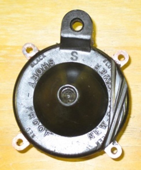

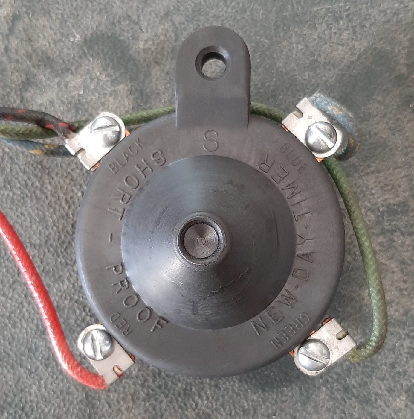

I'm curious about the history of infamous 's' branded New Days. When were those around? Were they made by the same outfit as today, just using a better recipe for the plastic?
- Posts: 2329
- Last Name: Juhl
- Location: Thumb of Michigan
"S" caps were sold by Snyders, before my time. That said, they still turn up on cars and at swap meets. They are made of a softer plastic and stand a little taller than they should. I've seen a couple with grooves cut into them by a fan belt as a result. The interior surfaces of the cap wear quickly leaving "bumps" where the contacts are that accelerate wear on the brushes as well. They can be identified by the "S" visible below the hole. They were not made by the folks from Tip Top timers. The "good" caps are made of a bakelite-like material. Hard and rigid. While we're at it, if you're at a swap meet and want to know if you're looking at an original cap, the little holes in the contacts of an original cap are square (second photo.) I've run an original cap on my car for a few thousand miles and compared it to a Tip-Top. The Tip-Top holds up as well as an original....maybe slightly better.
For what it's worth, one of the worst reproductions of a New Day is the "Best" - it really wears quickly. See how the plastic has been scraped out between the contacts. The debris piled up on the bottom edge is plastic. (Photo three)
From my comments you may think I'm a New Day nerd. Truth is, one came with my car and I've seen no reason to change. I collected the information I'm sharing from a "Shop Talk" I gave at the Piquette Ford Factory Museum in Detroit last year.

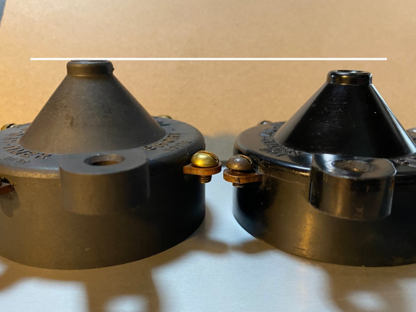

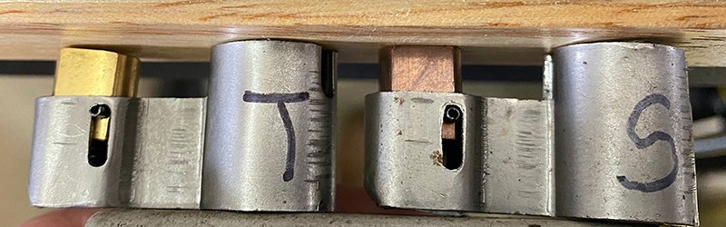

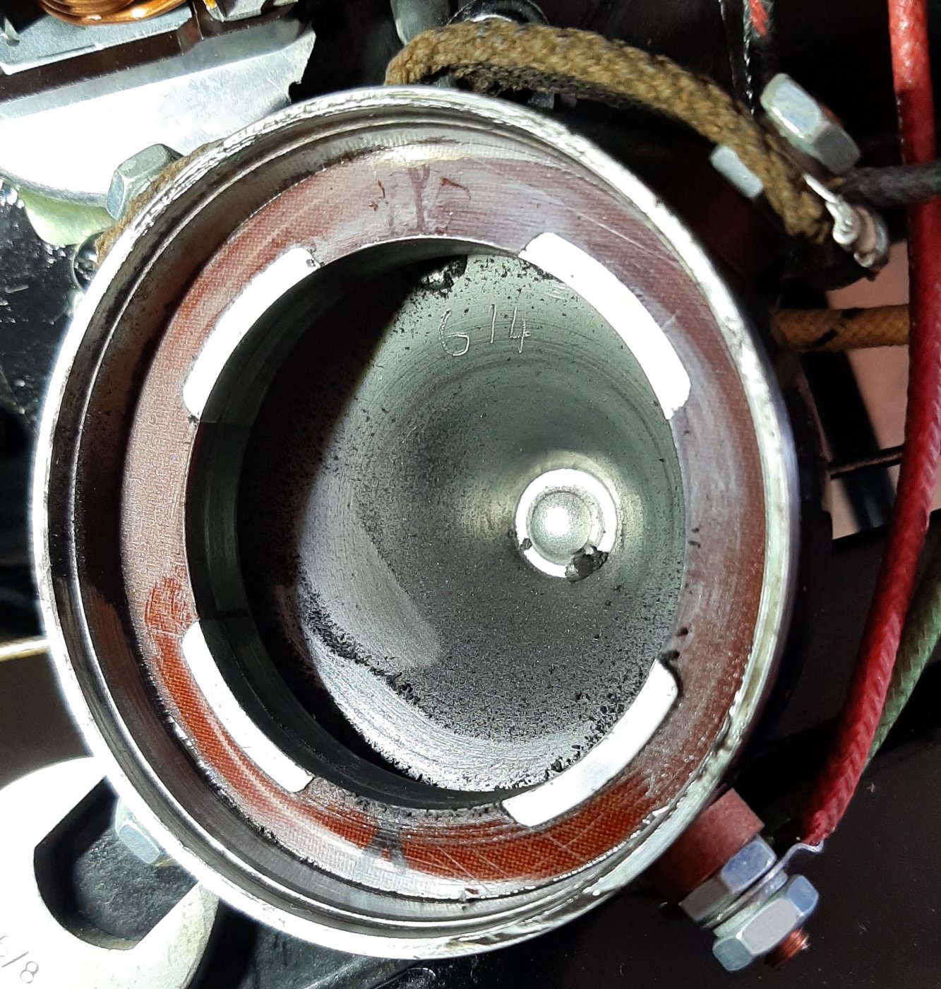

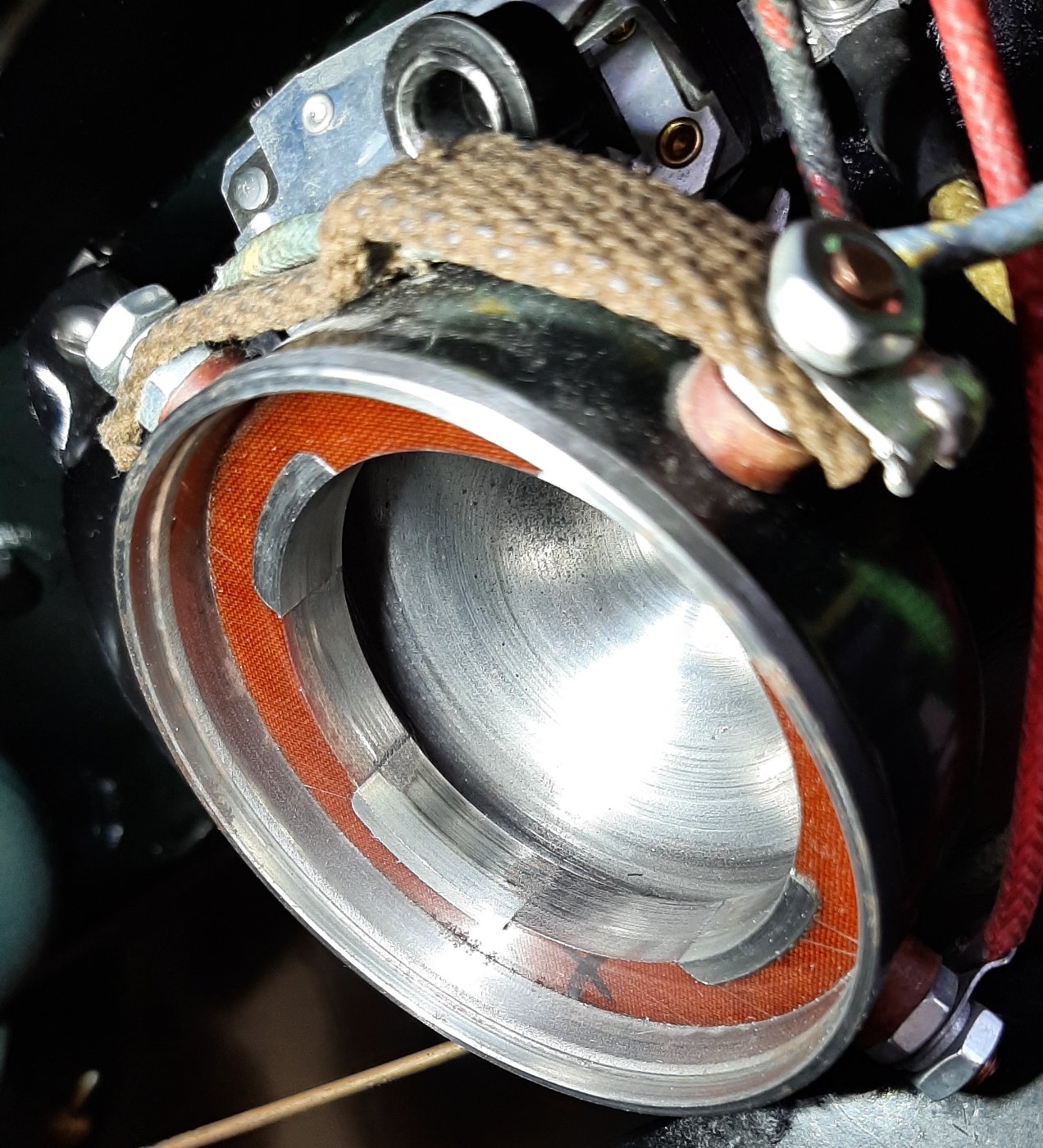

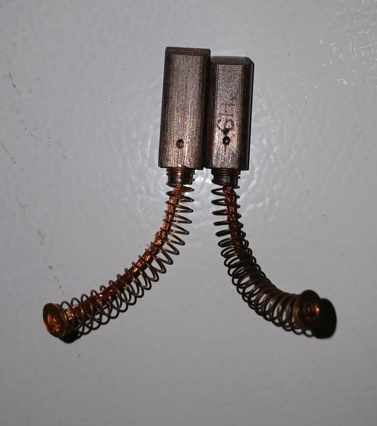

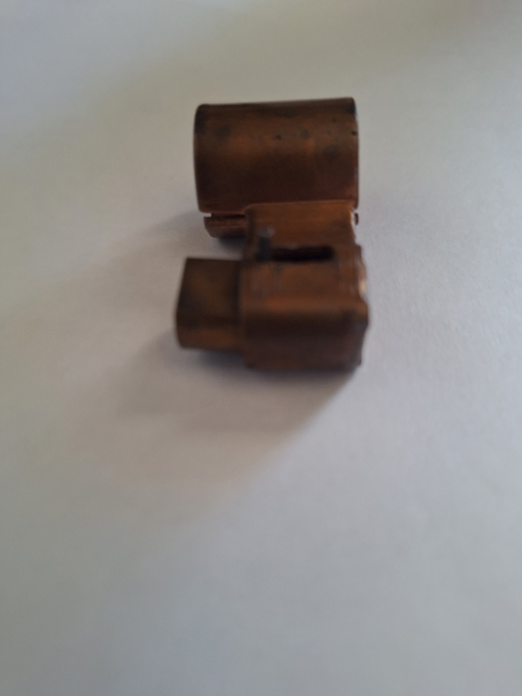

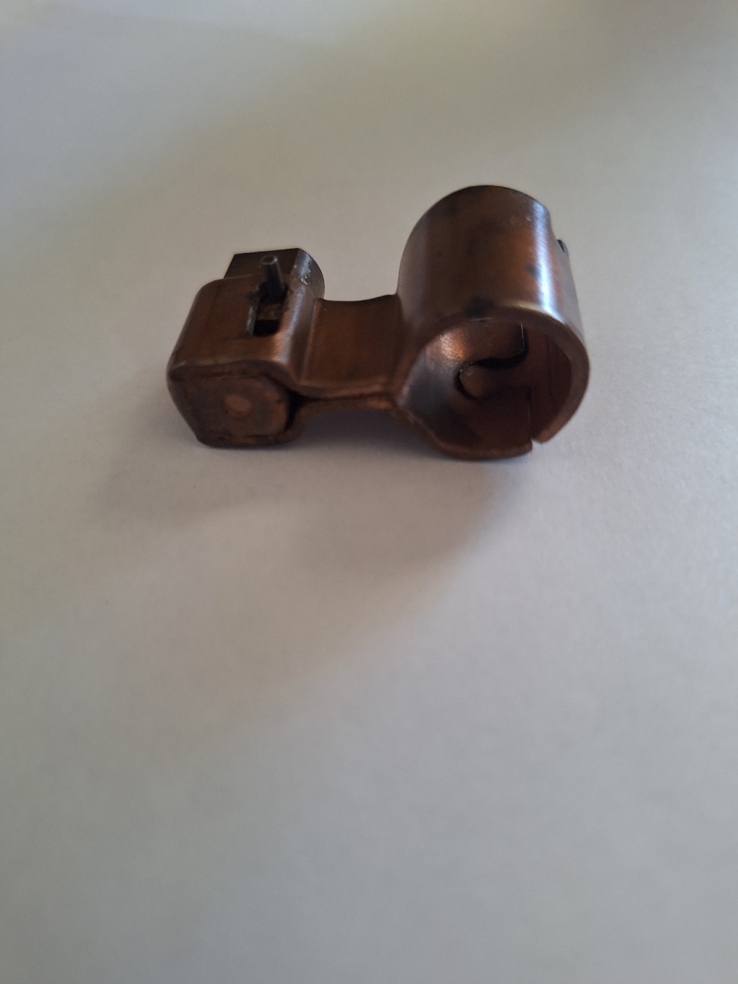

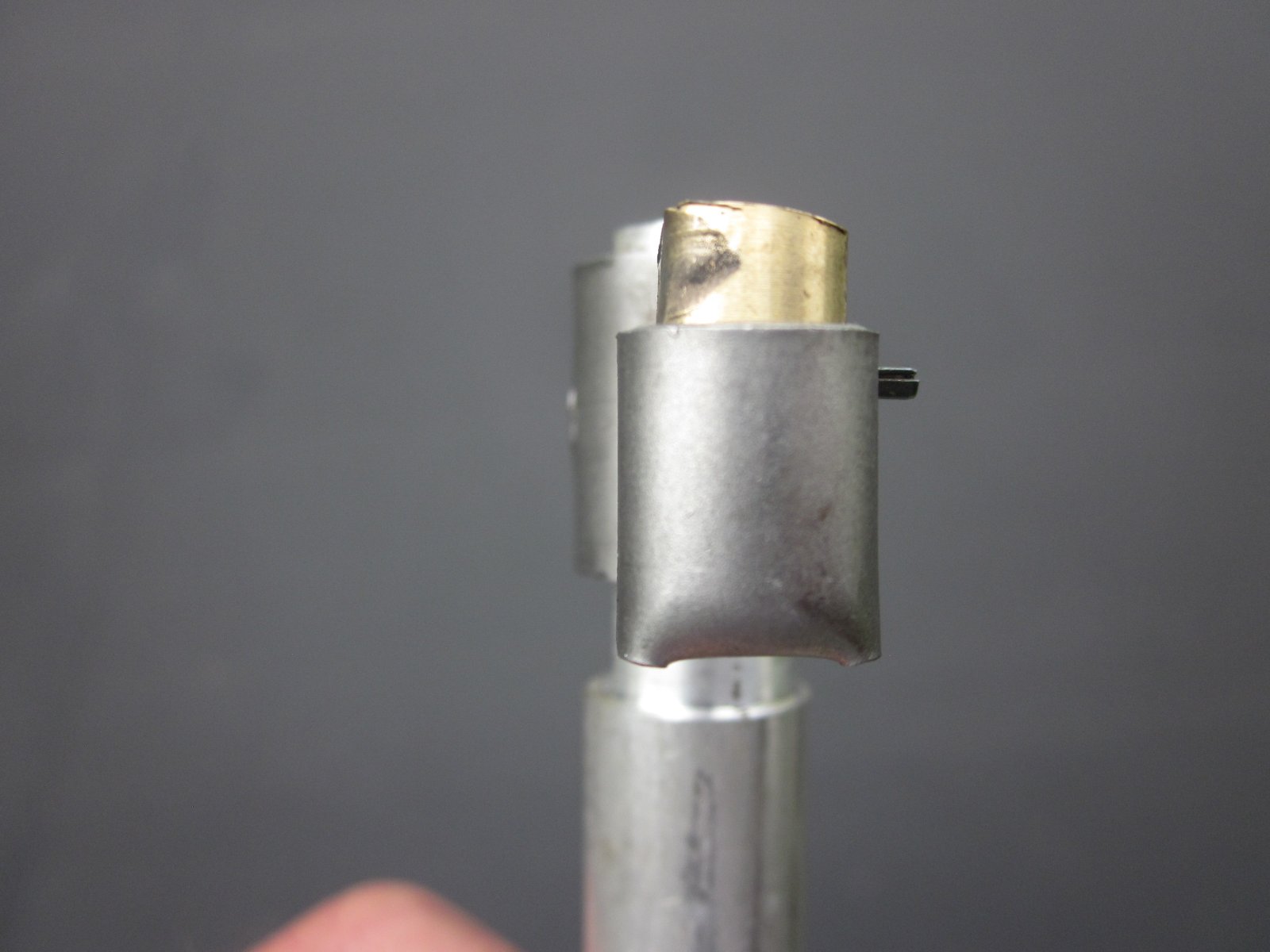

Tim, you posted “For what it's worth, one of the worst reproductions of a New Day is the "Best" - it really wears quickly. See how the plastic has been scraped out between the contacts. The debris piled up on the bottom edge is plastic.”
I assume you are referring to the marking on the original Snyder’s packaging: I bought this New Day timer from Snyder’s in 2005 and drove 500 miles with no troubles until the transmission broke and the car was laid up for years during the repairs/restoration.

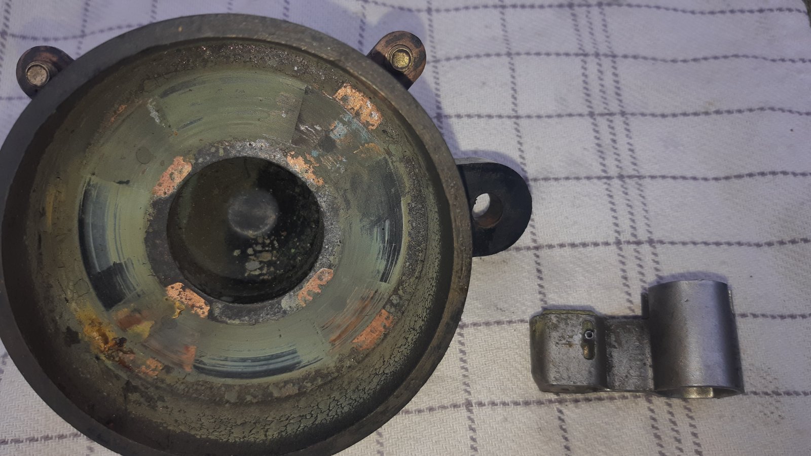

These are pics of that timer and brush as removed from the car: My timer shows no appreciable wear after just 500 miles, but after reading about how the “S” marked units were prone to failure, I bought a TW timer, which is working fine.
How come no one has posted a picture of an original New Day timer brush?

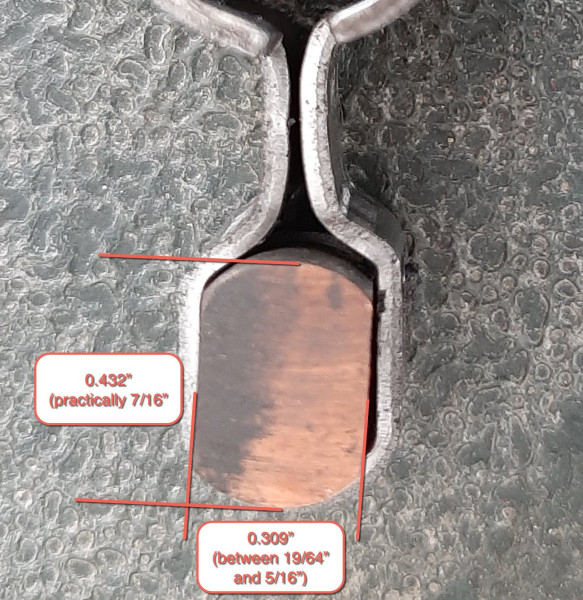

I just measured the distance across the face of a NOS New Day timer brush, and it is 7/16". I don't have a newer one to compare it to.
- Posts: 2329
- Last Name: Juhl
Eric,
Snyders may have sold the "Best" but I don't think they made it. I will admit some ignorance of it's history.
If you look at the picture of your "S" cap you can see the beginnings of plastic being pushed up over the contacts and on the face of the brush. Look back at my picture of a Tip-Top with 5400 miles on it. The contact margins are clean.
Below is a picture of a "S" cap showing more plastic migration.
I've also included a photo of an original and "S" cap viewed from the side. See what I mean about the "S" being taller?
Perhaps I should explain that I don't consider myself an expert on the New Day timer or any other. I'm simply sharing my experience and research...you can draw your own conclusions.
Eric Sole
- Posts: 144
- Joined: Mon Jan 07, 2019 4:25 pm
- First Name: Eric
- Last Name: Sole
- * REQUIRED* Type and Year of Model Ts owned: 1927 Roadster
- Location: Barcelona, Spain
Tim, you are the New Day timer expert in my book.
I now see the beginnings of the plastic being displaced on my timer, and that on a unit with so few miles on it! Makes me glad I popped for the TW timer.
I appreciate your observations and sharing your experience.
Eric Sole
Here are the measurements of the Snyder's brush sold 20 years ago.
Eric Sole
- Posts: 144
- First Name: Eric
- Last Name: Sole
Oh, and the new brush extends out 1/4".

Larry, you should post pictures of that NOS New Day brush that you have. That way everyone can see it.

Eric...I'll chime in now cause I consider myself the consumate "TW timer snob"! There is NO better timer than it! Electronic excluded...that's not even close to apple to apple comparisonEric Sole wrote: ↑Sat Aug 09, 2025 4:15 pmTim, you are the New Day timer expert in my book.
According to Tony (RIP) I was the "second buyer" from him when I realized what this timer would be like. I'll attach a pic of the TW on my '13 that has OVER 17K miles on it, and 3 brushes...the left one had 4K miles, middle 2K, and right one is new for comparison. I could run the left one even further.
WELL TUNED coils and proper timing are KEY also! But this timer design is just close to flawless. I tried a ND (not the "S" version) on my Fordor and it lasted barely 500 miles with requiring two "tear aparts" to keep it running. All I have to do with the TW is clean it every oil change, sometimes every other change. I will always run it! Nuff babbling. You get my point!

Sadly no. I have done what I can having a run of the 2 brush styles to help keep those of us with this
great timer going. I pass on the cost with no profit, usually lose a wee bit in the shipping from shop to me but no big deal. I had a dozen custom made brush holders (rotors) made for the round style, I have 2 left. I have tinkered
with using the "ordinary" roller timer with good success as far as the wear on the internal ring. I believe it's a wee bit softer
than what Tony used, I think he used Micarta. I even have a sheet of Micarta in which to make up to 9 rings, just haven't found
a good fast source to get em cut out via CNC. Then I can re-vamp the roller timer with these. Just takes lots of time.
Again, and with all timers, keeping the coils in top condition is paramount.
Thanks for your info on the TW timer. The brush wear comparison is interesting.
My engine is still in break-in stage, so running is constantly improving. I just cleaned the dust out of my TW timer, and I could swear the idle is smoother now.
Here is the timer cleaned up: As you can see, the brush has been running right at the forward edge of the timer. I removed 1mm from the back of the brush holder so it is closer to the engine now and while it is not completely centered on the segments, it is now more centered.
Don't know how important it is to have the brush completely centered on the segments?
I have no idea either re having the brush centered completely on the segments but lets face it, it can't hurt. Was a good idea to shave the brush holder down a bit. Some seem to need it, others don't. Critical to long brush wear is definitely a well tuned set of coils.Eric Sole wrote: ↑Sat Aug 30, 2025 6:37 amThanks for your info on the TW timer. The brush wear comparison is interesting.
And yes, it no doubt runs a bit smoother after cleaning, I've seldom noticed it "telling me" it's time to clean it, I just clean it at every oil change, in fact I'm going to do that to mine this morning as I changed the oil the other day and didn't have time. It's still been running smooth as silk....as always.
- Posts: 8613
A coil or coils that are out of adjustment and drawing excess current will dramatically shorten the life of any timer. Bad coils can wreck a timer in a very short time.

FWIW...as mentioned above..I cleaned the TW timer on my '13..usual carbon dust...no wear on the 4 metal contacts nor the micarta ring. Over 18K miles on this timer and for comparison here's a new brush next to current brush installed new this spring with already 1932 miles on it. I always get over 4K miles on a brush with plenty room to spare. I can even mount the timer on the block without the little wire that Tony (RIP) designed after a few originals were out there. Its easy with a little practice.
Larry Smith asked me to post these here. Copper plated.
I don't understand why Tip Top makes the brush a larger size? Any ideas?
