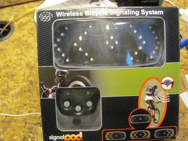

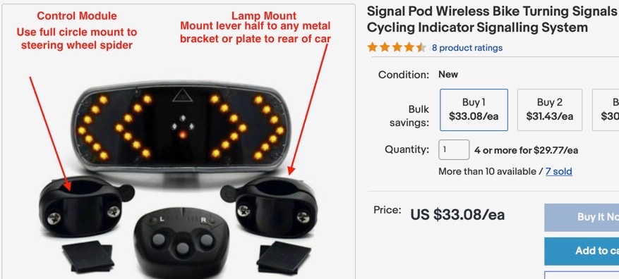

The Egypt Co. no longer exists, what they made were $$$ brackets, and the wireless signal unit was China.
I have ordered the China part, think on Amazon or maybe eBay or maybe online. The brand to search is called Signal Pod
UPDATE. looked on line and remembered in 2021 bought the Signal Pod from the UK, company is still in business and today exchange rate the cost would be US 30$, here is a link:
https://giftstomorrow.co.uk/product/igg ... ndicators/

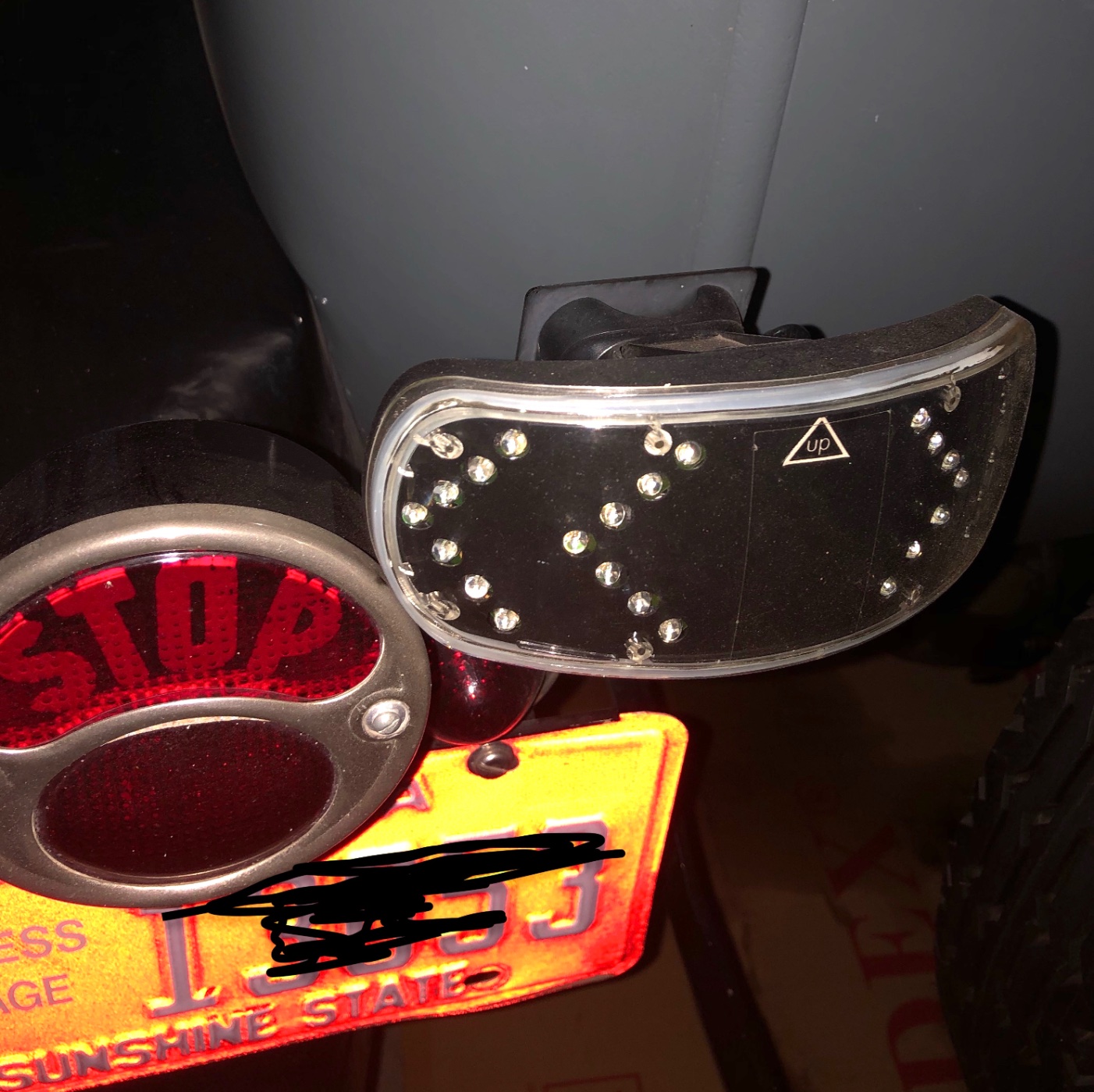

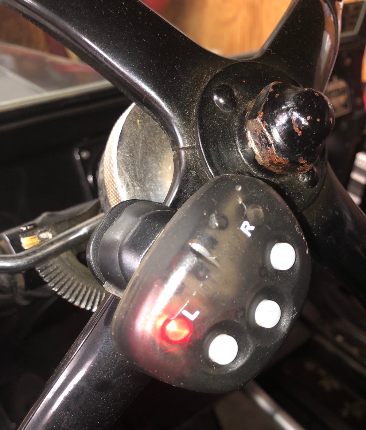

Make your own sheet metal bracket to fit the plastic mount. These are make for bikes and the mount for the wireless controller is round, and just happens to nicely fit to the T steering wheel spider, which is great location for the switch!
Here's my install on a '26, get creative on your sheet metal mount for custom installs.

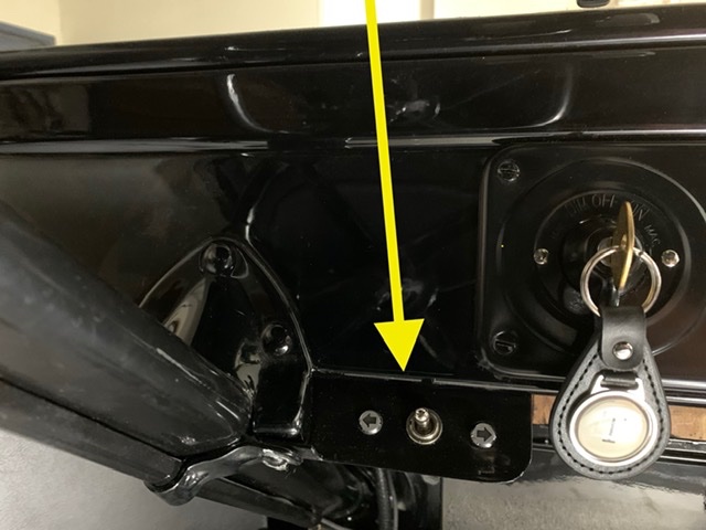

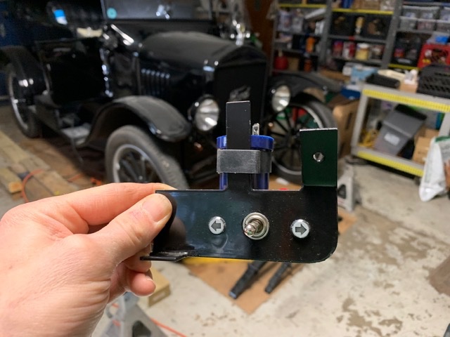

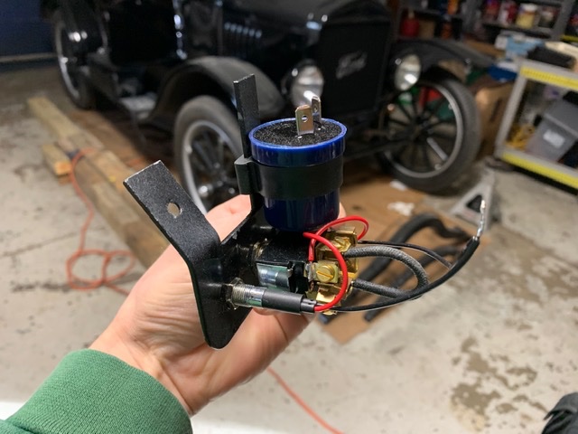

You can make your own with a few parts.
I attached photos of the turn sign kit I made.
Just need an “on-off-on” switch, a 6v relay with built in beeper (audio tone to let you know it’s on), green arrow LED’s, bracket and lights to mount on front and rear.
I sourced the relay and green arrows lights on Amazon, made the bracket and found glass lens turn signal fixtures at flea markets.
The bracket I made bolts on the dash between the steering column and ammeter. Bolts right up no modifications and blends in, no bulky unit strapped to the steering column or wires hanging.
You would have to make a different bracket for your dash but happy to share the rest of the details.
