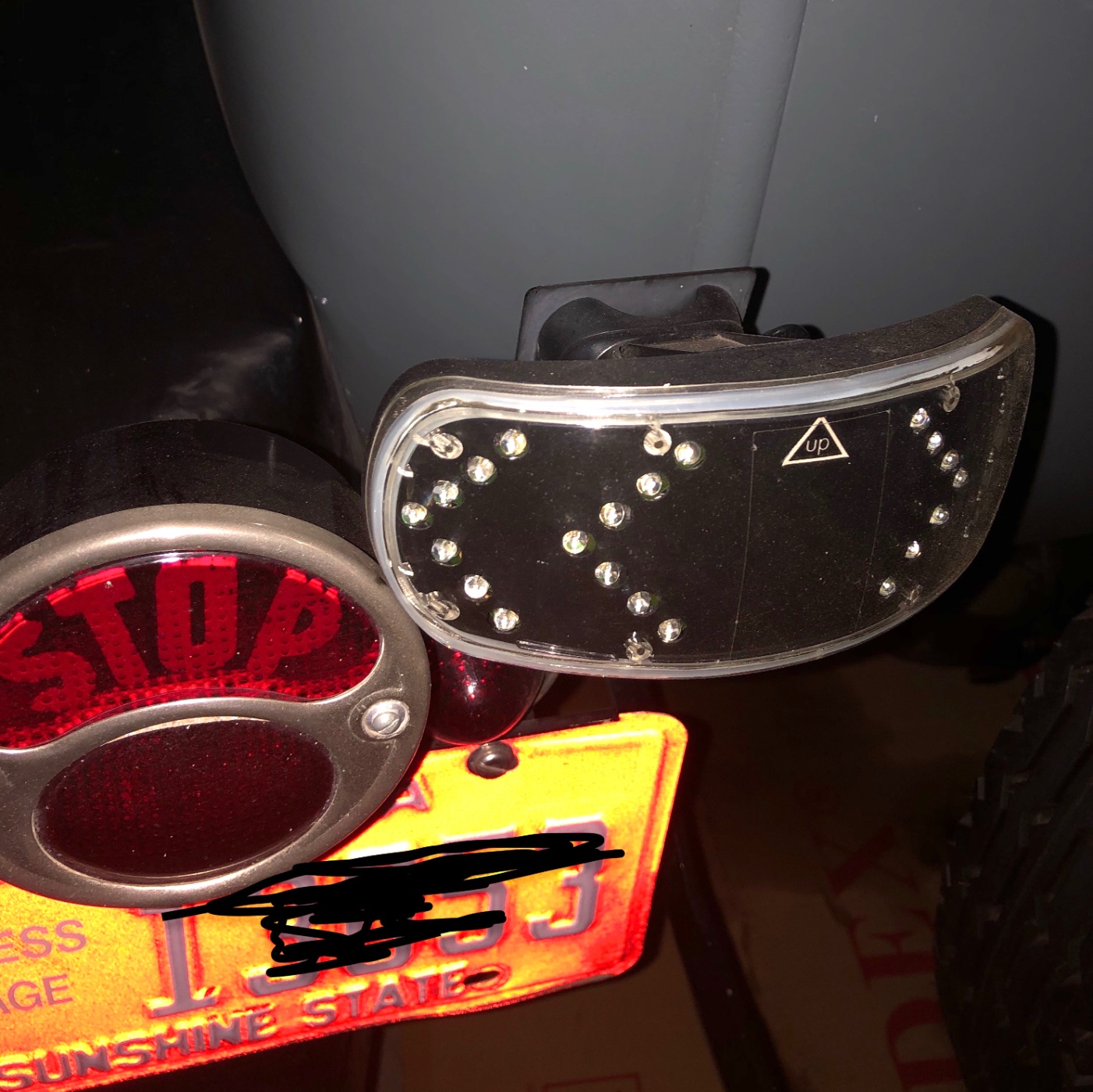

The Egypt Co. no longer exists, what they made were $$$ brackets, and the wireless signal unit was China.
I have ordered the China part, think on Amazon or maybe eBay or maybe online. The brand to search is called Signal Pod
UPDATE. looked on line and remembered in 2021 bought the Signal Pod from the UK, company is still in business and today exchange rate the cost would be US 30$, here is a link:
https://giftstomorrow.co.uk/product/igg ... ndicators/
Make your own sheet metal bracket to fit the plastic mount. These are make for bikes and the mount for the wireless controller is round, and just happens to nicely fit to the T steering wheel spider, which is great location for the switch!
Here's my install on a '26, get creative on your sheet metal mount for custom installs.
