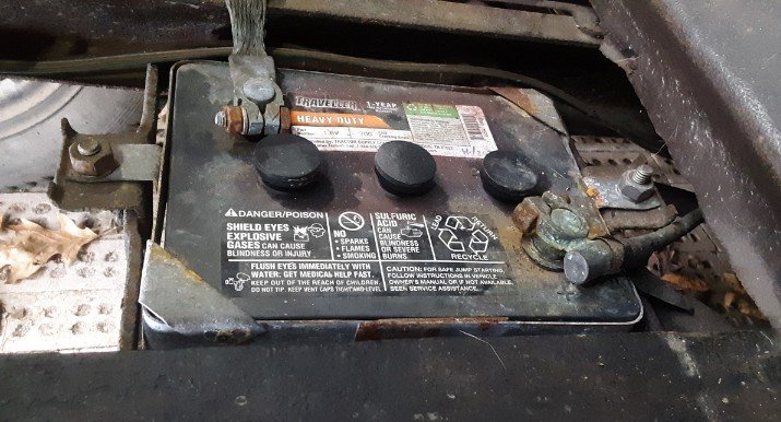

Use this strap, for 6 volt battery, works great! Hauled in an old battery for trade at TSC, and the clerk marveled, had never seen one :o

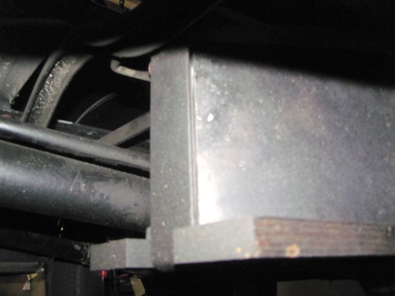

I see the picture of an Optima mounted in the Runabout. I have a '23 and an Optima but have used heavy tie wraps to hold it, not the best. I see you have some sort of brace going across. What is it? Do anybody else have a cleaver hold down that can be got to from topside? The tie wraps need to be done from underneath and being old & fat, this is very unpleasant . . .
Paul
Original picture from above:

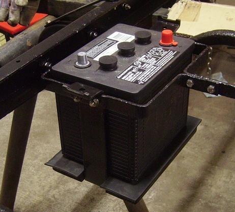

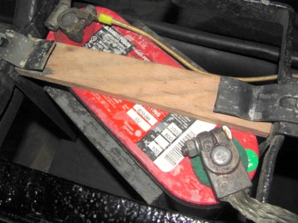

Easy to use the Ford clamps and carriage bolts that held the factory battery box lid.
Use a strip of wood as the structure for the clamps to bite on. Works well, no shifting of the Optima, esp. if you also make a pad with tall side wood pieces under the battery bracket.
Side boards on board fitted on the battery bracket for support.

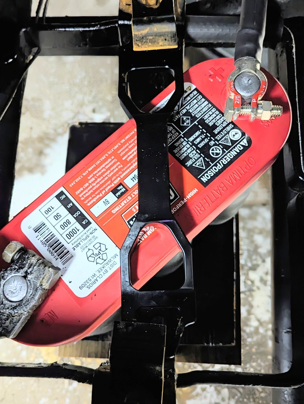

About Paul's information request:
The original battery hold down method is shown in this thread
https://www.mtfca.com/discus/messages/1 ... 1311865183
The brackets do not fit properly without the box and lid so you might have to get creative like these.
https://www.mtfca.com/discus/messages/2 ... 59557.html
I don't like the stock ones, it does not hold them securely enough for me.
So I build my own brackets that are more of like a Model A style or like this with as much clearance as possible
If you use one exactly like the picture you will likely short the battery out, that is why I make them custom.
I don't have a picture of one of mine handy.
Mike
Screenshot 2026-02-09 232331.jpg (6.44 KiB) Viewed 1808 times

For the sake of completeness, clearness and clarity here is what I build to hold my batteries in.
I skidded on the frozen snow to walk out there and get a picture.
It is not authentic or original but it is secure.
While I prefer original and authentic, safety and reliability can take over the decision.
And frankly when I made my first one I had forgotten to order some repros and needed something that night.
What I whipped up from junk worked so well I custom make them for everything now.
The band around the outside is below the lip so any sharp edges are away from the cables and terminals.
The block underneath brings it up enough high enough it is above the carrier bars for no binding.
It looks like come spring service it could use some cleanup.
Even not on a roadster changing the battery can be a bit of a challenge since there is not much room to get under it.
I can't wait till spring when I can drive it again.
Mike

Both threads Mike referred to are incomplete in their contribution.
When a battery box lid is used The hold down clamps hold the cover down on the two flats either side of the lid. The battery can be free to float around in the box under the lid. This is especially true with the lower height batteries available today. In T times the wooden case of battery had built in handles/risers on each end. The battery box lid rested on these. So pressure by the hold down clamps on the lid was transferred to the battery as well, holding the battery down and the lid in place. Today there is need for a spacer board under the battery ti lift it to the appropriate height for the clamps to engage on it. It is better to use a wooden block under the clamp to spread the load on the battery top. If you are going to use a lid, that wooden block needs to be of appropriate thickness to take the load of the clamp and the lid.
In the second thread, the clamps have been installed up side down because the battery is too deep in the carrier. A thicker base board is called for.
Or, wooden blocks could be used on top of the battery and the clamps used correct way up. This would help spread the clamping force on the battery top.
