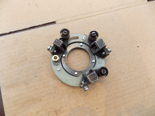

After finally getting the engine to run in a friend's newly-purchased '26 T, it was noted that the ammeter did not register a charge even when the engine was revved up. The ammeter was wired backwards (of course!), showing a charge when the lights were tested. Once the ammeter wires were corrected, turning on the headlights gave a discharge on the ammeter. So, we know the ammeter works on both sides of zero.
Before polarizing the generator, I thought it best to remove the cutout to see if it could possibly be an electronic model, which is not supposed to be jumpered. Thank goodness I did that - it is an expensive electronic cutout for negative systems. 'Dodged the bullet there! I will assume it's good, as it appears brand-new.
Removing the generator to test it with a battery, it "motored", maybe not as fast as I would like, but it did spin. That's a plus = the armature isn't burned out. The cover band was removed and I was greeted by an additional two-wire affair with a fuse, which I had never seen. The fuse filament does not appear to be broken. Look at the photos. What is this for? I am reluctant to adjust the third brush holder to increase the charging rate because what if this wiring addition is some kind of regulator or surge protector and by me attempting to increase the charging rate, I screw something up? I know I need to clean the armature plates, but if they were really terrible, the generator wouldn't even motor.
Should I loosen the third brush plate via the nut (see arrow) and move the holder to increase the charging rate? If not, why does the generator motor, but not put out a charge?
Marshall[image][/image]

Marshall.. that generator could be a Patterson rebuild, as he did put a fuse in like that. I would suggest getting a flathead wood clothespin, cut a strip of 320 sandpaper and apply that to the clothespin head. Start the car and apply the 320 sandpaper to clean up those contacts. You should get the positive reading on your ammeter. Some people have even used brake cleaner spray with the straw attached to clean contacts in the running mode.

The fuse should be between the field wire and the third brush.
Why the fuse:
By a broken connection to the battery, the generator will build up his output well over 20V. ( tried it with a volt meter over a test light between the generator post and its house. At 28V the light burned out)
Also the current in the field will go up. The fuse will burn and the generator will be safe.

- Posts: 5254
Re: Another generator question - A new one on me!
A generator that wont motor wonr work.
A generator that will motor might work.
I would put back on the motor. Run & clean the commutator with fine sand paper.
Make sure the brushes all move freely & are contacting the commuter.
Take an analog voltage reading @ the output terminal. 0 volts = dead. 7.5V + good.
Start with increasing the 3rd brush.(move toward motor) If you get a good voltage reading or ammeter reading, great.
If not.....
Follow the in car generator adjustment from the service manual.
Still no joy? - rebuild time.
If not.....

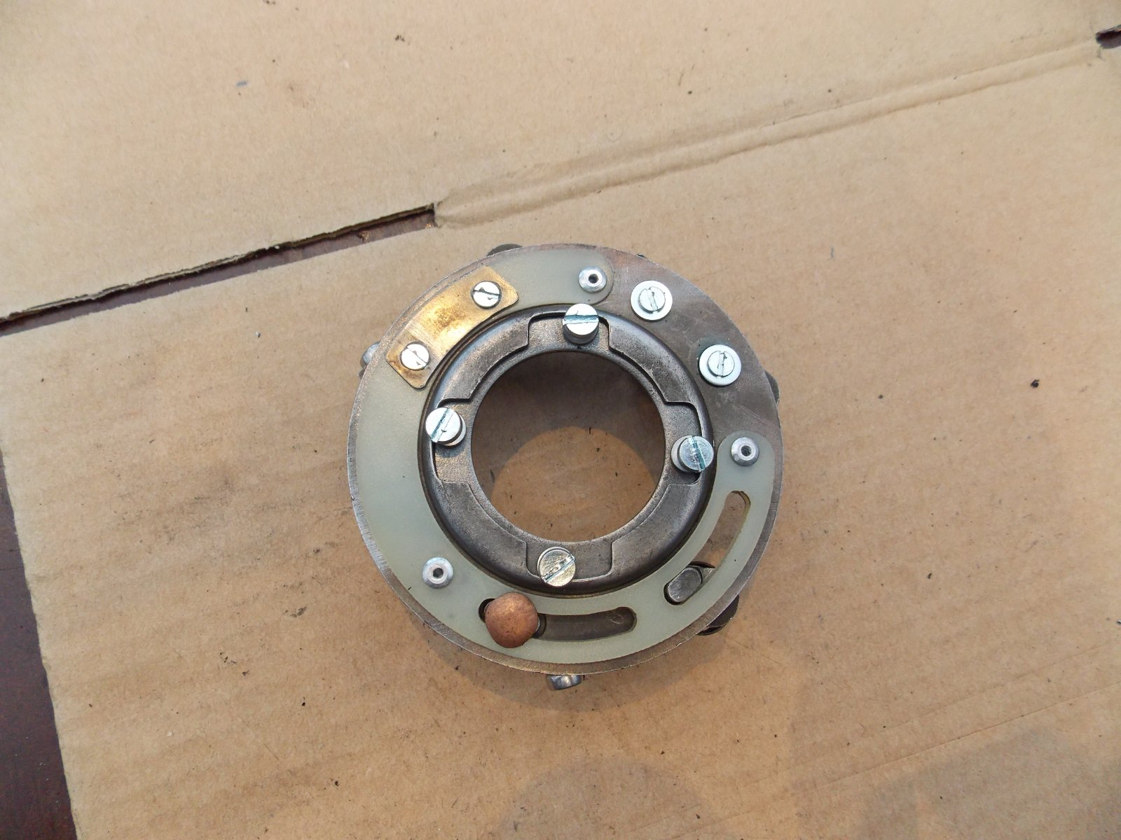

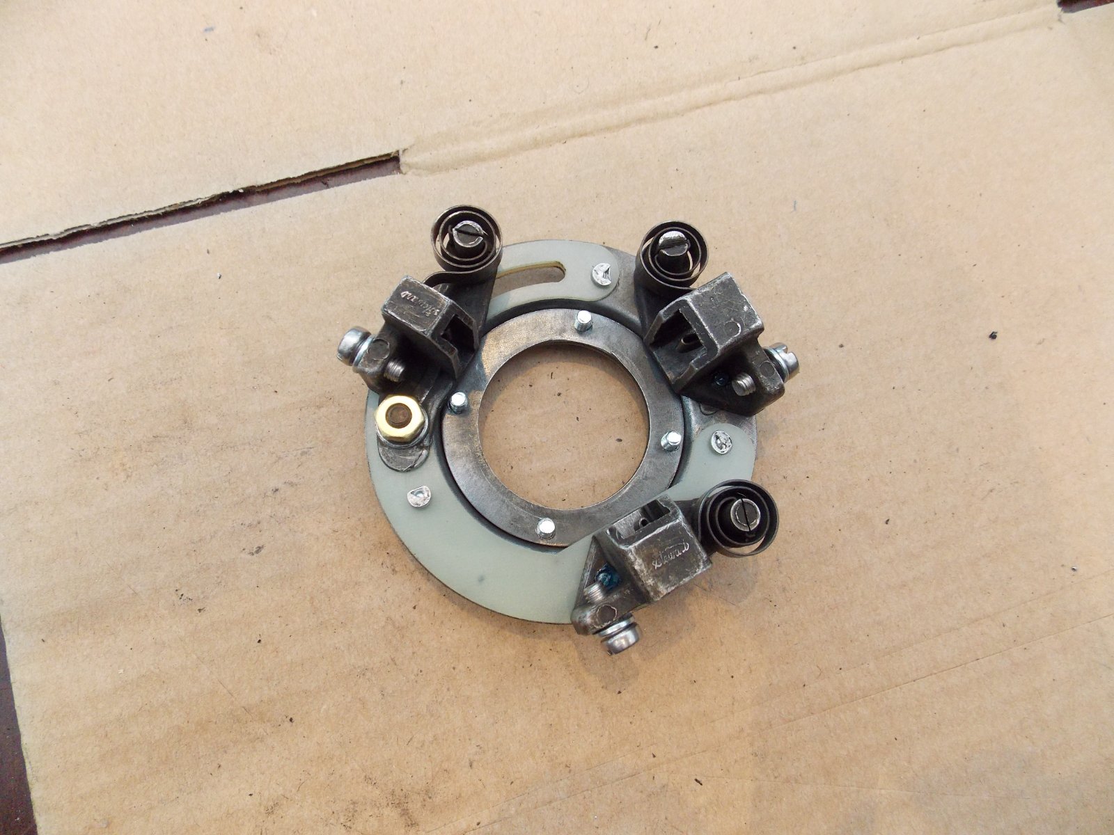

Before starting, get an inexpensive analog volt/ohm meter and check the resistance between the insulated brush holder and the plate it's mounted to. That value should be essentially Infinite Ohms, indicating the insulator is still electrically functional. If that insulated brush holder is grounded to the plate, the insulator is bad and removing it, replacing the two insulation sheets and reattaching the insulated brush holder is more involved, but definitely doable. The video does not show removal/reattachment of the insulated brush holder, they leave that in place and trim the new insulator sheets accordingly. Recheck resistance after you complete the work and install the 3rd brush holder making sure insulated parts are insulated. Then install brush plate in the generator and follow Ron P's guidline for setting endplate null position and position of 3rd brush holder.
You can't make anything worse and if it doesn't fix things you still have a core to exchange.
I recommend using the fiberglass 'best quality' insulators, two are needed one has to be slightly shaped to fit abound the ridge in the brush plate, the video shows it all. Some use pop rivets instead of the tube rivets shown in the video.
All the best, jb
I encourage you to pursue brush plate insulator replacement if you are game, your fortune says you are! I did this successfully a few years ago with Ron's guidance along with the info in this excellent video > https://www.youtube.com/watch?v=C7Psk4hK3gU The brushplate insulator replacement procedure begins right after time 14:00. As Stelf Jelf says, "It ain't rocket surgery".
All the best, jb

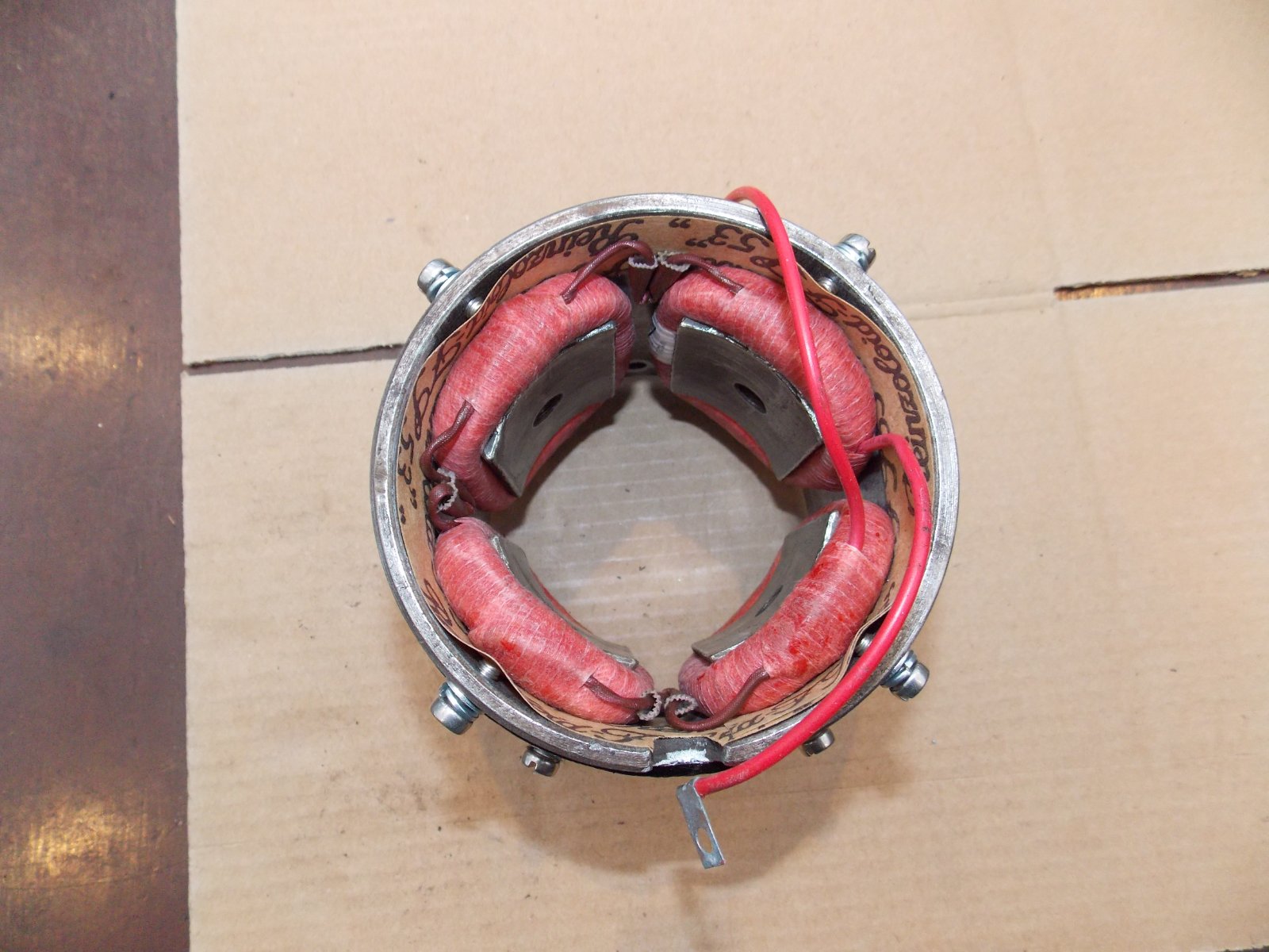

UPDATE: It's been a couple weeks since I last posted progress information on the repair of my friend's 1926 Touring balky (to be read: dead) generator. In the intervening time, I followed all the suggestions made in this thread and picked Ron Patterson's brain clean (Fortunately, he has plenty left!). Ron patiently talked me through additional checks and recommendations via numerous telephone calls and emails, often initiated by Ron. I watched a number of on-line generator repair videos, read through multiple Model T manuals and studied past discussion board threads on repairing non-functioning Model T generators - but still no success. A friend's growler proved that even though this armature showed signs of surviving the Battle of Verdun with its many nicks, gouges and missing segment chunks, it passed the test. I was just SURE the armature was the culprit. Nope. No longer one of the usual suspects. No matter what I did, this generator refused to come back to life. Polarizing the generator did nothing. The ammeter's needle remained motionless, although it showed a charge with a different generator. This was becoming frustrating. Most of the last month has been spent ordering and waiting for parts, as well as continued assembly/disassembly. Only as of today can I bring this thread to a merciful end.
To review, I rebuilt the brush plate with plastic insulators, sanded the armature's commutator plates with progressively finer sandpaper, cleaned out the micra troughs with a hacksaw blade, bought new brushes that I seated to the contour of the commutator, sealed exposed armature windings with Glyptal and purchased a new terminal wire to replace the frayed one. After a number of assemblings and disassemblings, I have become quite adept at quickly doing this, including installing and connecting the brush and field wires, which always seemed to fight me. Still, no luck, no functioning generator. What was left?
I finally decided enough pussy-footing around with this thing and then COMPLETELY disassembled the case, removing the oil-soaked field coils. When they were out, it became obvious that someone even dumber and less electrically-minded than I had been inside. Look at the attached photos of the coils and see how many stupid "fixes" a previous owner had inflicted upon them, from twisted connecting wires to broken field leads TAPED together, but disconnected inside!!! Yikes!!! No wonder this poor generator wouldn't work! After ordering and installing new field coils this past week, bench testing with a 6volt battery and initially setting the brush plate's null point to get in the ballpark for charging rate provided reason to be confident that the generator would at long last finally "gen".
Once it had been installed on/to the engine for the millionth time, I crossed my fingers, turned on the ignition key and hit the starter button. The engine came to life and to my sheer delight, a positive charge registered on the ammeter. At long last - success! The problem all along had been the field coil's previous "repairs". To my untrained eyes, the coils had looked good inside the case, albeit oil-soaked, no torn wrappings. I mistakenly believed the field coils were still usable. You cannot imagine the relief I experienced when I saw that ammeter needle sitting at 5 amps and holding steady. I hope I can get past all the sleepless nights, anxiety-filled days working on this ^%$(& generator and the hours spent reading manuals and watching videos about generator repair. Perhaps my frustrating experience will help others here, who are likewise experiencing generator repair issues. If I can fix this generator, ANYONE can.
Besides all the guys here who offered the benefit of their knowledge and made excellent suggestions, I want to give a special shout out again to Ron Patterson for his unswerving and patient support. If it hadn't been for his willingness to help an idiot like me resolve this generator problem, I would have given up long ago and sent the whole shebang out for an expensive exchange rebuild plus expensive shipping both ways. We are fortunate to have folks like Ron on this discussion forum, who have the knowledge and willingness to help another Model T guy keep his sanity. Thank you, thank you, thank you!!! Thanks to ALL of you, who helped!
Marshall
Marshall

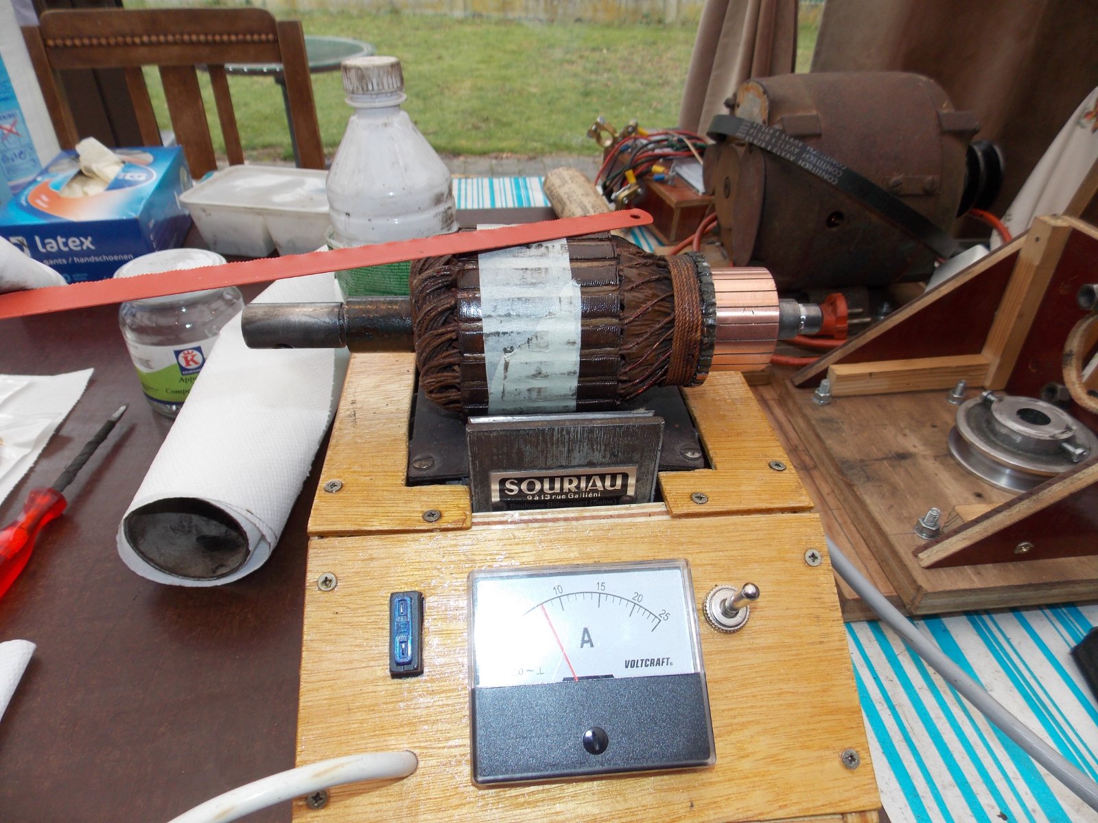

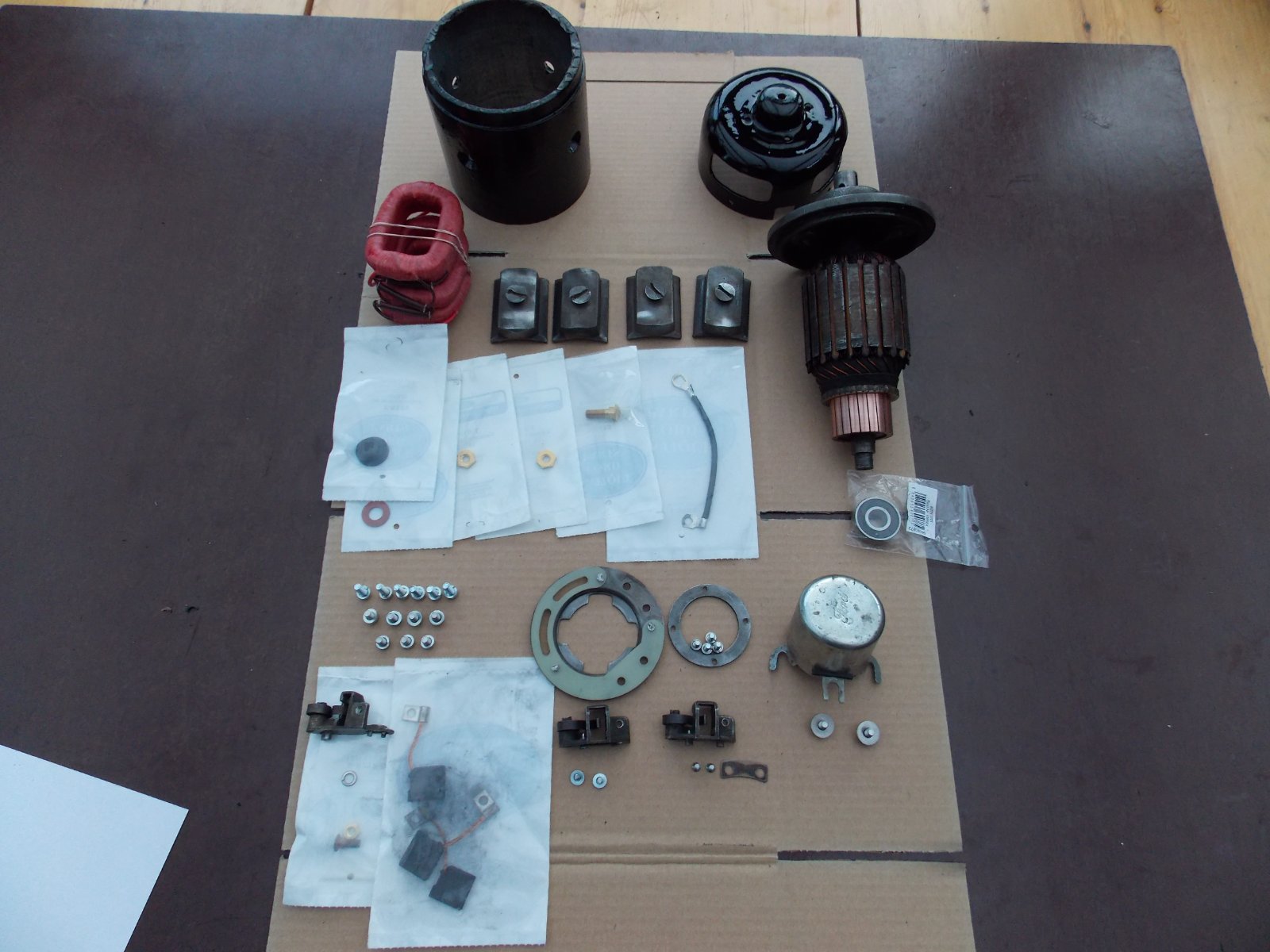

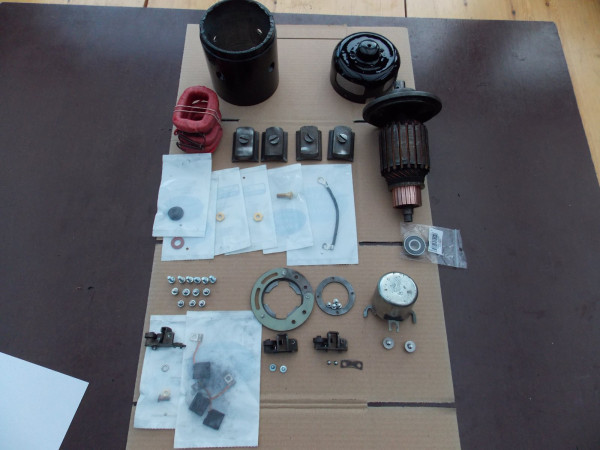

Thank You Marshall for sharing your generator story.
I was there about 10 years ago and it was also Ron that walked me through the problems, mostly by mail. (Phone from Belgium to the USA is possible but not easy time differences)
Since than I use always his advices when I rebuild Generators, starters, coils and magneto coilrings.
Good luck
Andre
Belgium
Good luck
Andre
Belgium
Andre in Belgium -
Your photos could be switched with mine and no one would be the wiser.
I took almost exactly the same photos as you did to document what was purchased and what the parts (new and old) looked like when spread out. I didn't do the mass photo of parts like your "exploded" layout view, but the others could have been taken right here in Davenport, Iowa! Great minds do think the same, don't they?
Yes, this generator would have been D.O.A. (Dead On Arrival) if Ron Patterson had not advised me what to do and just as importantly, what NOT to do. Advice from other posters was also very helpful and I appreciate all their time and effort they expended to write out suggestions. I hope to be able to help others on this Model T website by supplying experience gained fixing other components. Quite frankly, my comfort zone is in the Model A world, where on one discussion forum I have supplied a couple thousand postings to help newbies with their Model A problem du jours. Maybe someday I can catch up in the Model T world and be able to contribute useful advice. With willing and knowledgeable old hands like Ron offering the benefit of their experience, a LOT of us struggling Model T fans on this website will eventually be able to pass on advice in the future to newbies finding their way here - probably as clueless and desperate as I was with this "Generator from H*ll".
Marshall
Marshall
