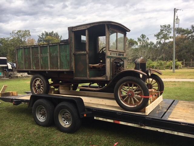

Guys thanks for all of the great help. Unfortunately I have to work at the NSRA nationals in Louisville for the next several days so I won’t be able to play with the truck this weekend. I can’t Waite to get it back out and learn how to drive it. I will
Report back and post more pictures.

drool..
I do like trucks!
Glad to hear you are enjoying it
I do like trucks!

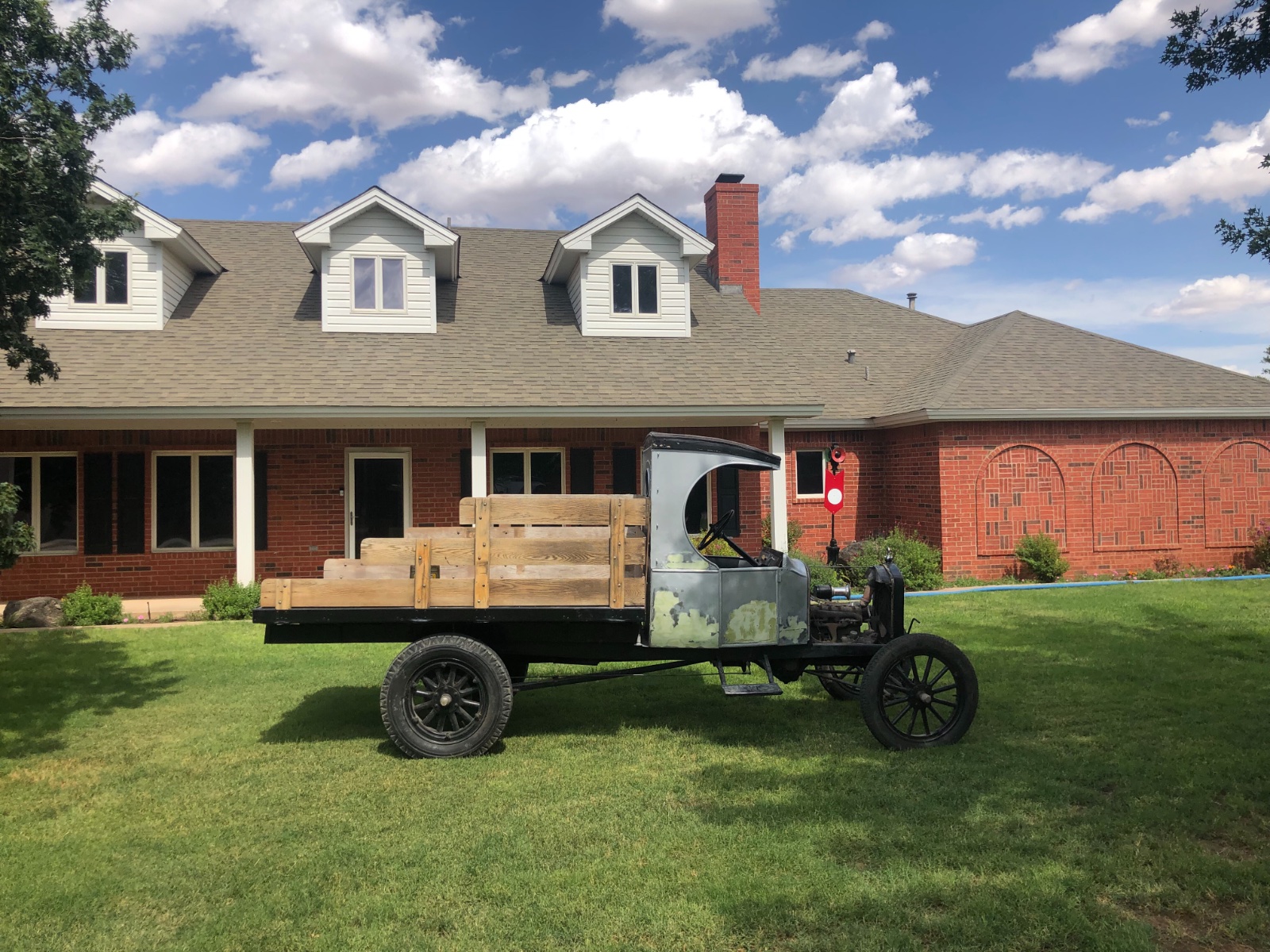

- Posts: 6817
Re: I drove my TT for the second time.
Now THAT is a GREAT truck!
Even I might be converted with something like THAT!

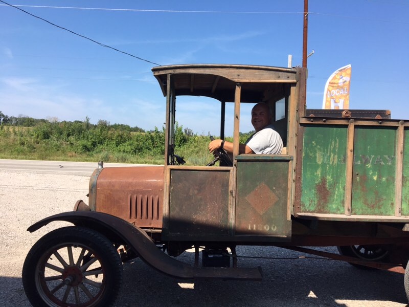

If its the same truck, it belonged to someone around Wales, Wisconsin about 25 years ago. Looks like the same one.

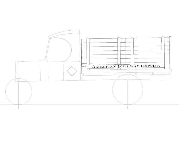

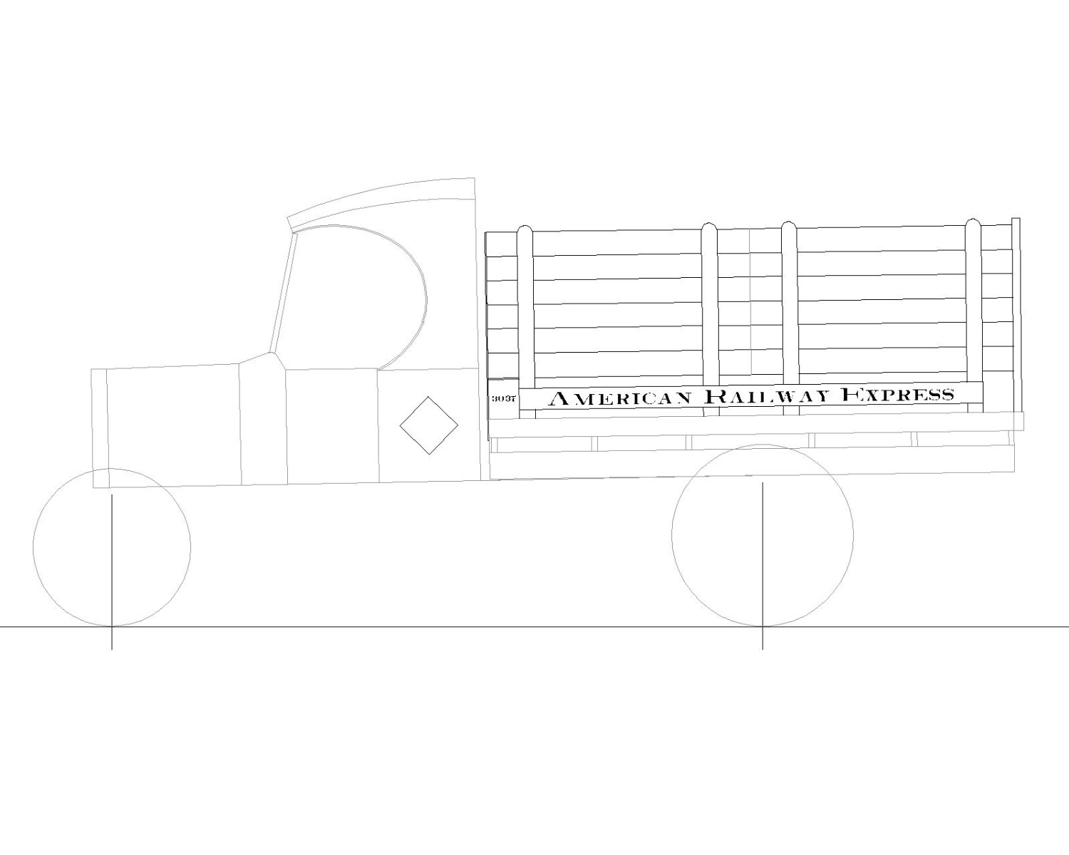

I see your TT is a former REA truck. This is very cool as I am actually restoring my 24 TT C cab as an REA (actually its predecessor American Railway Express). Any pictures you could post/send on details such as lettering etc would be appreciated.
Bruce Carswell
Bruce Carswell
