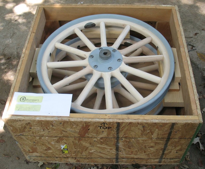

I sent my rims, hubs, and other metal parts to Noah Stutzman and a few weeks later he sent me back a crate of beautiful new wheels. I don't recall the exact cost, but it was under $200 a wheel.
One thing I will do differently if I have more wheels made: I will not prime the metal parts. I'll prep the metal parts with 50/50 phosphoric acid to prevent rust until I paint, and when I have the new wheel(s) I'll use a primerless paint. Little scratches and dings are very likely when you mount tires, and a lighter colored primer makes them really glaring.

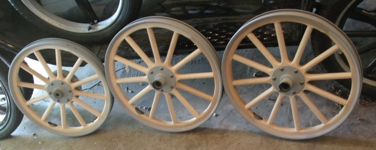

I have rebuilt wood wheels on both my steel and wood felloe wheels. It is not difficult to do either.
Whilst some feel they would not do wood felloe wheels themselves, if you know how to do them there is no reason not to go for it. The rebuilders are regular humans just like you and so if they can build a wheel, you can.
I won't explain how to do it on this post, but the method requires painting the wheel when you are done because the rim needs to be heat shrunk in place. You can easily build up a wheel as good or better than new. You will however have to be prepared to heat the rims and to peen the rivets.

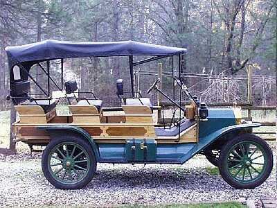

I built these wheels on my first model T "Toady"
