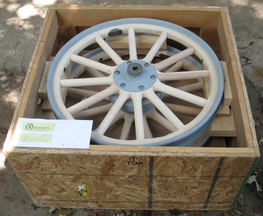

I sent my rims, hubs, and other metal parts to Noah Stutzman and a few weeks later he sent me back a crate of beautiful new wheels. I don't recall the exact cost, but it was under $200 a wheel.
