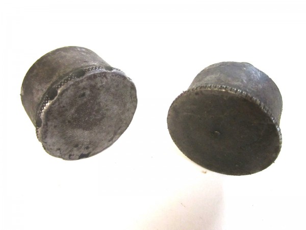

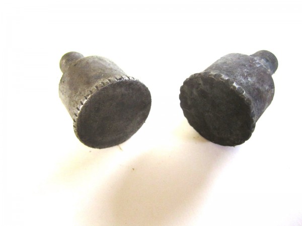

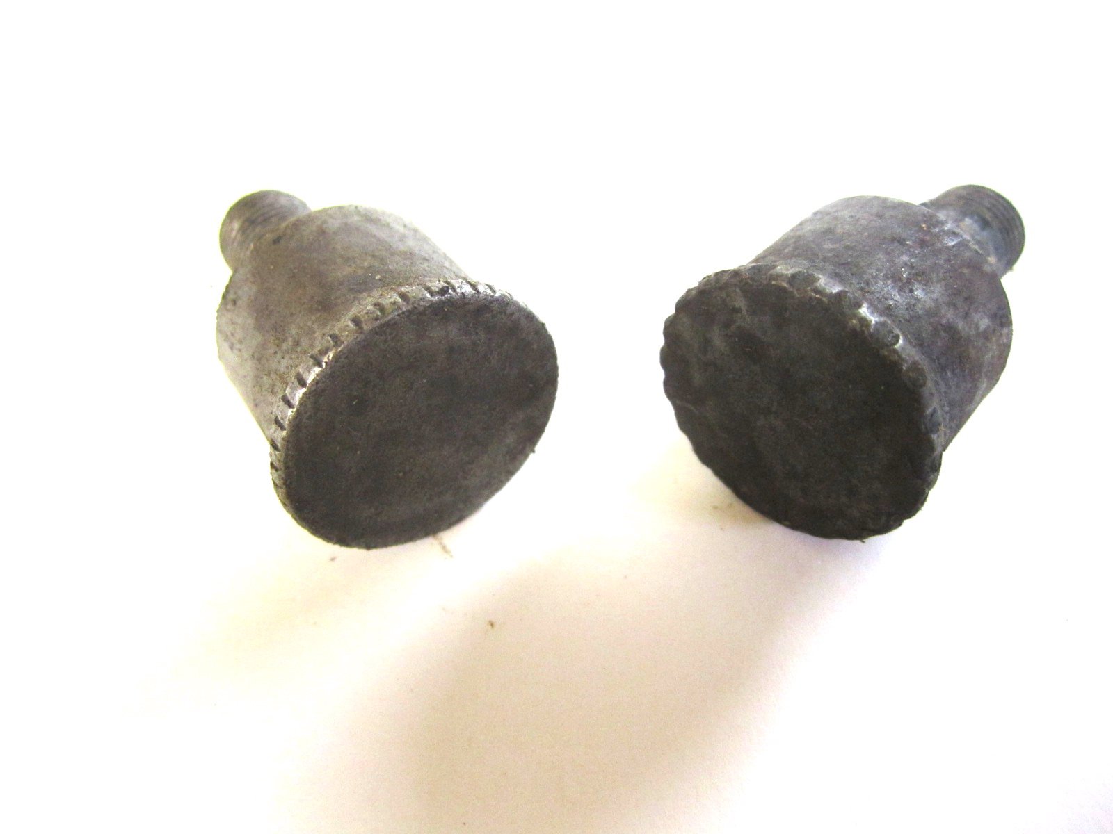

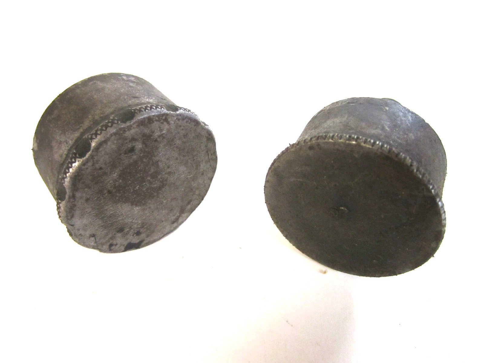

Larry, confused by the cauliflower description. Is this what you mean? Both large and small grease cups shown. Thanks
Posts: 3950
Location: Lomita, California
Re: Difference in Grease Cups?
Post by Original Smith » Tue Sep 24, 2019 9:58 am
Yes, that is what I was talking about. They just look older.
